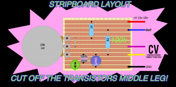

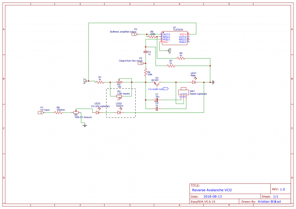

As an easy first project I was recommended to try a Reverse Avalanche Oscillator. Under even modest scrutiny they aren’t great, but even with an additional OPamp/Tl702 per so it will output usable CV (as shown in the first attached schematic) they should be very cost effective and simple to construct. My plan was to stick about three of them into an ~8HP plate as a “Drone/Chorus/Better than no LFO’s” module and I got invested in the idea.
The problem is I’m too dense to get one working and now I’m afraid to move on to something more sophisticated until I figure this out.
So far I’ve been following the attached schematics with little success, even swapping the N2904/BC337’s with S9018’s as is recommended by LMNC in his later versions and this paper: http://www.kerrywong.com/2014/03/19/bjt-in-reverse-avalanche-mode/ I’ve been having constant issues getting the core oscillating on a breadboard. The best I got was yesterday afternoon, where I could get a single brief pulse when connecting the power supply, and that pulse couldn’t even drive an 8Omh speaker. A friend of mine was able to get them working just fine at 13.3v but all I've got to run the entire synth is a 12v 2A wall wart, and all the schematics I've seen so far are supposed to be fine at 9-12v.
It’s been really frustrating failing to get what’s supposed to be such a simple circuit running this week. If you have any tips, tricks, or hopefully a better schematic please share them.

PostPosted: Thu Sep 28, 2023 12:21 pm    Post subject: Reply with quote  Mark this post and the followings unread
Hi Steve,
Welcome Smile
- For the tl072 to work you will need a bipolar power suppy - you did not mention that you use that.
- An 80 Ohm speaker connected directly does not seem like a good idea - on the buffered output it might need a series resistor of 200 Ohm or so (and it may be soft then) - on the unbuffered output it will not work at all. Better it would be to make a little audio amplifier for driving the speaker.

PostPosted: Thu Sep 28, 2023 11:09 pm    Post subject: Reply with quote  Mark this post and the followings unread
First thing I noticed when glancing over the schematic is the 100k pot at the cv input.
This is far to large impedance since it is in series with the led(s)
Why don’t you use the spare opamp to buffer the cv in?
