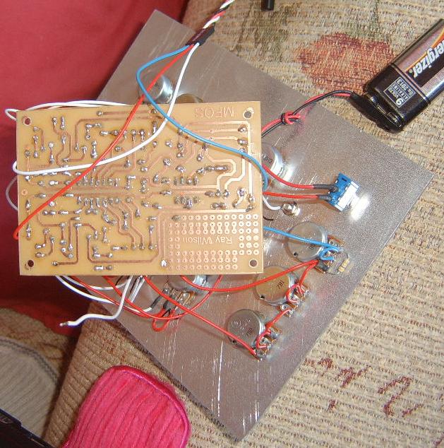

I'll bump a dead thread Very Happy
Heres my PCB done with glossy photo paper as the transfer medium. I had to do a little bit of remedial work with an etch resist pen. I find drilling the holes fairly theraputic .
I tried PnP blue for my first sojourn into DIY PCB's and although I found it great as far as easy removal goes and the tracks that went down were crisp and sharp. BUT, there had to be one Very Happy , It had a tendency to pucker and shrink at the edges causing smearing of any traces under the effected areas.
So after that, and considering the cost, I went with the photo paper which is much much cheaper. Results where much better for me though different problems occurred at times, traces lifting, but mainly due to needing practice with the ol' iron. I am planning on getting a laminator to use now though.
Here's my WSG PCB. It's based on the Ray Wilson PCB pattern with minor changes to suit a single sided PCB.
regards

PostPosted: Sun May 31, 2009 9:15 pm    Post subject: Reply with quote  Mark this post and the followings unread
Actually I've been thinking about creating my own PCBs . Thanks Fenris for reviving the thread. I just hope my ratshack has Ferric Chloride because I heard that some of the stores are not carrying it. Do you use that chem or do you use muriatic acid & hydrogen peroxide ?
Side note: In doing research today I got funny results from Google because I accidently typed , "How to make PCP" I'm probably on some FBI watch list now because of this and my googling of chemicals.

Hi Skylab
Yes, I use ferric-chloride. But only because I was given it Very Happy . My other weapon of choice, down to whats available at the time, is persulphate(?) I used it once years ago. It's a clear solution that works just as well as the ferric.
Rapid online do sell ferric in powder form as well as liquid. I recommend the powder form for ease of storage. and you can mix what you need and it does go a long way.
My only tip is to sit the etching tray in another tray that is filled with hot water. This warms the ferric up and speeds the process. Do take care to ensure good ventilation.
The only other tip is to suspend you PCB face down in the etchant as this also helps speed the process along. Read all safety precaution data for the materials involved in the process.
