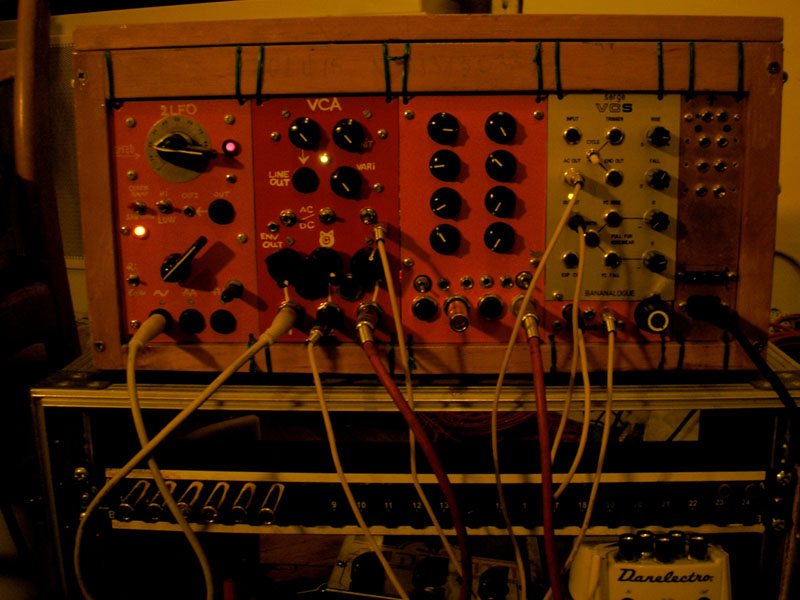

PostPosted: Sat Dec 20, 2008 6:01 am    Post subject: Reply with quote  Mark this post and the followings unread
Hello!
On this picture i marked the point Varice was talking about.
Any more experience on this, from you guys already using it?
If i understand right, this point does deliver 8 volts centered around zero?
I'll have to measure...
i use Output 3 as well since a long time to chain some external modules,
diy filters and such, moved by the G2 thru a paia midiCV. It doesn't deliver totally snappy envelopes, but it's still musically useable. Actually i like it a lot.
My problem was, that i needed to boost the output of the G2 externally by a few volts to get nice filter responses,
otherwise its very rude on high resonance settings, as obviously it doesn't have any juice.
i believe the G2 Outputs are around maximum 1 volts or less. This mod would solve that, more eleganty and without a loss of quality.
Please share some experience on this will you?
thanks!

PostPosted: Sat Dec 20, 2008 10:46 am    Post subject: Reply with quote  Mark this post and the followings unread
Yes, the end of C101 connected to pin 1 is the point where I made the connection to get the signal from the G2 Output 4. This signal will range about 8 volts peak to peak, from about -4 to +4 volts. To get this range, you have to amplify a typical G2 bipolar control signal (-64 to +64 units) with a gain of 8X. I normally use an amplifier module set to a gain of 4X connected to an output module with the pad set to +6dB.

Hey Varice!
Thanks for you're reply! i still too have some questions. Laughing
But first, on using the beefy output with external modules...
Well, i've tried lots and lots of thing, mainly because when i bought the engine about 4 years ago, i was such an
inexperienced patcher (spent two years with a micromodular, but too quickly grown out of it's one DSP,
and had to part with it because of the engine, still miss her little red body with that harsh spectral osc...)
that i couldn't get that defined bass i wanted, and i knew some filters have it, not that i've heard many at that point, but...
So a loopback chain (how do we call that? it comes out and goes back to the G2...) worked well with a friends waldorf 4-pole,
that filter box has everything one needs, vca, lfo, ringmod, plus midi control over everything, so a nice little editor can be knocked together inside the G2 in no time, but the problem was already there with self oscillation, it just kicks in as a sine-ish wave with low signals, and i adore sharp self oscillations of analog gear, but it was not ok to have it a LOT louder than the signal itself, not very musical.
Then soon i refreshed my electronic knowledge, kicked together a few ringmods with lfo's, than i played at in berlin in and got back with a Bananalogue Serge VCS, and it dawned on me that i can do this, i can do modules like this, i can experiment with things and stick them behind panels, put them into boxes, it's not such a hard thing to do, not at all, it's rather very relaxing to me, messing with electronics. Same as patching a G2. Smile
This picture is of the box i'm taking to gig's nowdays, it has a pair of Lfo's,
a Vca with a 3 input mixer, a pair of sallen-key filters that evolved from the René Schmitz adaptation of the MS20 filters, the VCS, a voltage controllable glide, some multiples and random voltages and some secret electonics you have to open the lid up to access. I built 3 times as much modules so i keep changing them, really depends on what i want to do, it's never finnished, but this box now is giggable, it's not heavy at all, as wide a rack standard, and the engine usually resides on top of it, sort of driving it. Well what are engines for? Very Happy
What i'm working on now, is a desk-top sort of unit that will incorporate the engine, a midi-cv, a pair of 4x4 matrix mixers for the G2's inputs and outputs, and at least 4 vca's if not 8 to move things, and some whatever, probably an oscillator moved by the G2 thru midi, and a pair of filters.
I might not even need an oscillator if the 8volt outputs work out, ill just use Tim's draw-osc than. I'm in love with that. Smile And Bank Select, yes.
Im still tring to build smaller than i can build, just crossing over to use SMT. As it should not be bigger than let's say a NM1 rack, im a working "man", i need backpack it often. Smile Made lots of plan's and drawings, what's really hard for me is to decide what makes sense to do inside the G2 and what's better outside, but shurely theres a few analog circuit's i love to use and don't have a way to emulate the sound of those, tho it's odd that i'm a lot closer to the sound i'm looking for now inside the Nord aswell. But i a NO laptop on stage.
Wow, did i type that much? Rolling Eyes
