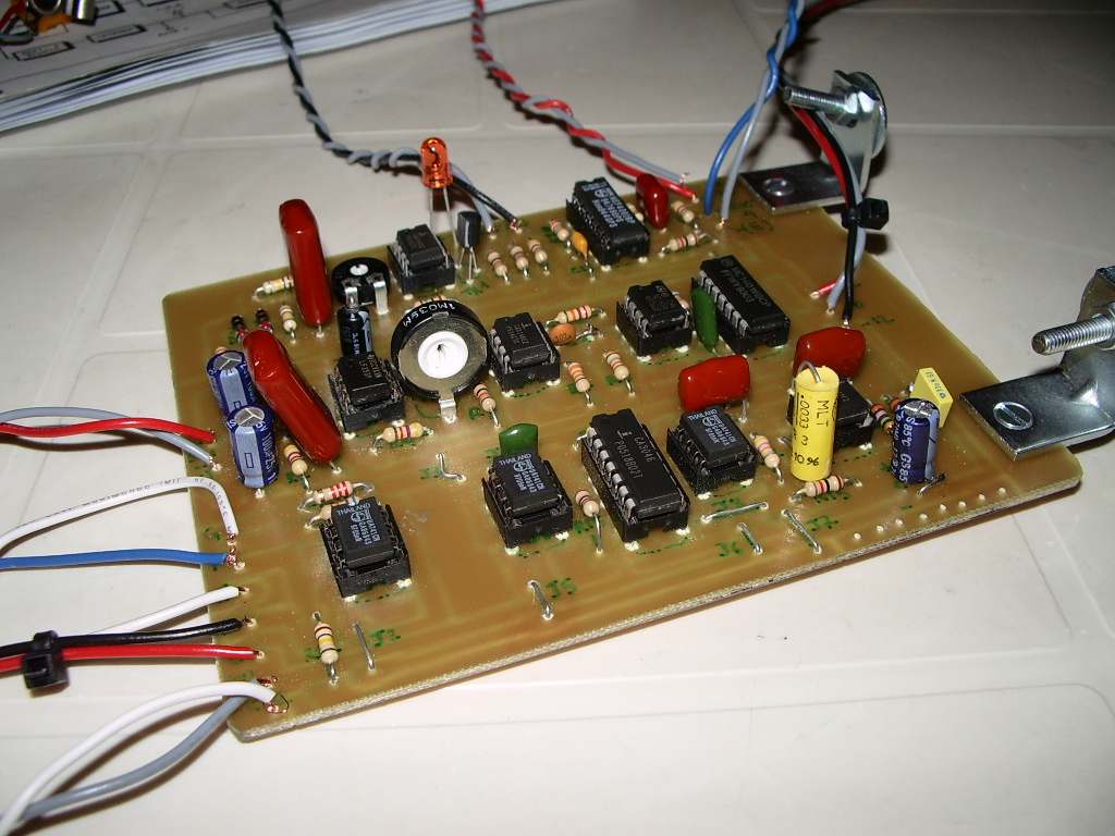

PostPosted: Tue Feb 27, 2007 2:06 am    Post subject: Re: First success
Subject description: .. but a lot of work is still needed ..
stefano wrote:
stefano wrote:
PRODUCTION OF SAMPLES AND PHOTOS IN PROGRESS.... Cool
Yes, sir, yesterday the Penfold F2V Guitar to Synth Interface started to convert guitar frequencies to voltage. I say "SOMEHOW" because I had to make a little mod (or bypass) to start it work. And I think that the device is not working in the way that Penfold designed it... but it WORKS.
I suspected that the signal path "stopped" at the gates of the quad switch 4016BE (I use a MC14016BCP for IC4). IC4 is driven at pin 13 (control pin) by a signal coming from pin 4 of IC11b, so I wondered what would have happened if pin 1 and pin 2 of IC4 would have always connected (like if the control al pin 13 was always enabled). The easiest way to do this is to **short** pin 1 and pin 2 of IC4. I did it and immediately the circuit started to convert frequencies to voltages.
The mini sound lab accepted the 1V/Octave scale produced by Penfold P2V.
I played an A (5th guitar string), tuned the osc-1 Minisoundlab and VR2 (shift control). Then I played the same string at the 12th fret (1octave up) and I used the VR3 (gain control) to tune the sound from the oscillator.
I didn't win the war, but I think at least a good battle! I'm on my way to completely debug this circuit because I don't actually like this bypass Twisted Evil .
Next step I'd like to do with an oscilloscope (any advice accepted Very Happy ):
- controlling the signal at (IC11 pin 4) = (IC4 pin 13) (after generation of quad switch control signal)
- controlling the signal at IC10 pin 6 (before generation of quad switch control signal)
Stay tuned
Here is a photo of the loaded PCB.
At the moment I'm trying to discover if the quadswitch MC14016BCP is damaged.
Another issue could be the power supply. I discovered that I have a positive supply of exactly +12 V and a negative supply of - 10.5 V . Do you think this could be a problem for the biasing of the components ?
Bye

PostPosted: Tue Feb 27, 2007 3:20 am    Post subject: Reply with quote  Mark this post and the followings unread
I reckon I'm going to make one up shortly too --- Stefano, that's the PCB straight from the project document, right?
All the parts look pretty standard which is good -- reckon I'd use an SSM2210 instead of CA3046 though..
Duh, silly-bugs -- of course I then realised that the CA3046 has a pretty different pin-out (14 pin DIL vs 8 pin for starters...)
BUT! Had a closer look and its very easy to mod things for SSM2210 (or LM394) - I'll try it out and then post an image if its of use to anyone..

PostPosted: Wed Feb 28, 2007 1:02 pm    Post subject: Reply with quote  Mark this post and the followings unread
Hey Stefano - I got my one working today ---->> after a while though..!..
There's one big error in the project that could cause confusion - in the parts list, IC11 is listed as a 4011 but in the schematic its shown and listed as a 4001 -- !!! --- changing over from a 4011 to a 4001 got things working.
So, its working and tracking a bit, but at the moment its really very unstable - if you try re-triggering notes they'll often repitch themselves. The tuning ain't good at the moment.. HoHum. Maybe I'll try to get a ca3046 'cos I'm currently using an SSM2210 (with suitable cludges)
Anyways, just wondered if you'd identified that problem before...

PostPosted: Thu Mar 01, 2007 2:58 am    Post subject: Reply with quote  Mark this post and the followings unread
Yeah, it was the eighth message of this post (see previous page of this post, it was a message of mine). Anyway there are other errors (E), the article must have been written in a hurry ! For instance:
Evil or Very Mad E1) - there is listed in the schema of fig.2, for IC7 a CA4046 instead of the proper CA3040 (correct)
Evil or Very Mad E2) - IC2,IC5,IC9 in fig. 2 are CA3140, but in the part list (correct) IC2,IC9,IC10 are CA3140
Rolling Eyes E3) - spare terminals of pots VR3 and VR5, according to the schematic should be connected respectively to pads 'F' and 'B' (though, I wonder if this is relevant)
Bye
