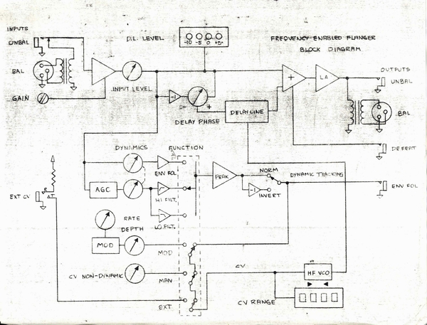

Well aurt you won't have to kill for them after all. Been lookin' for them all day. Here's the block diagram:

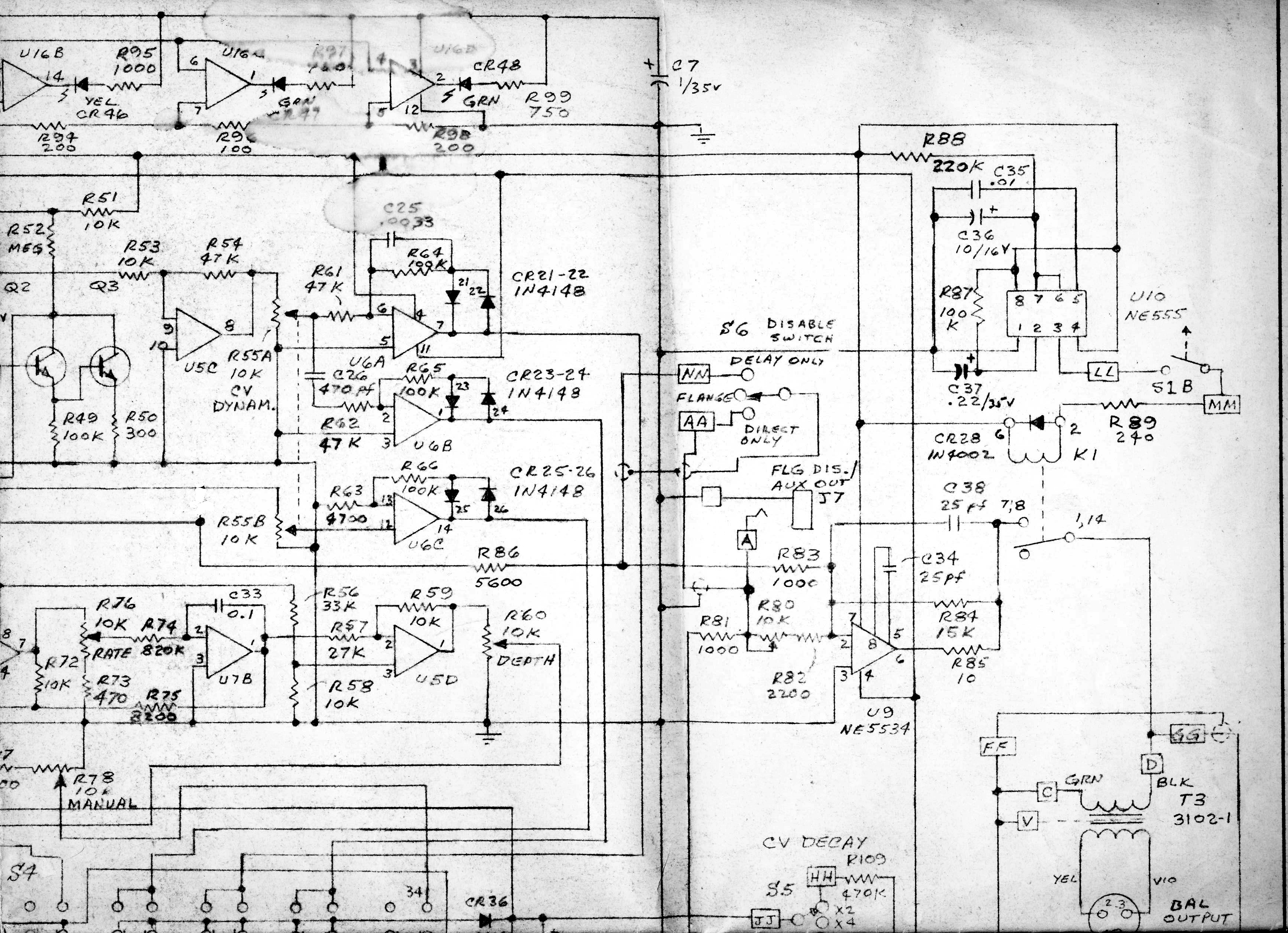

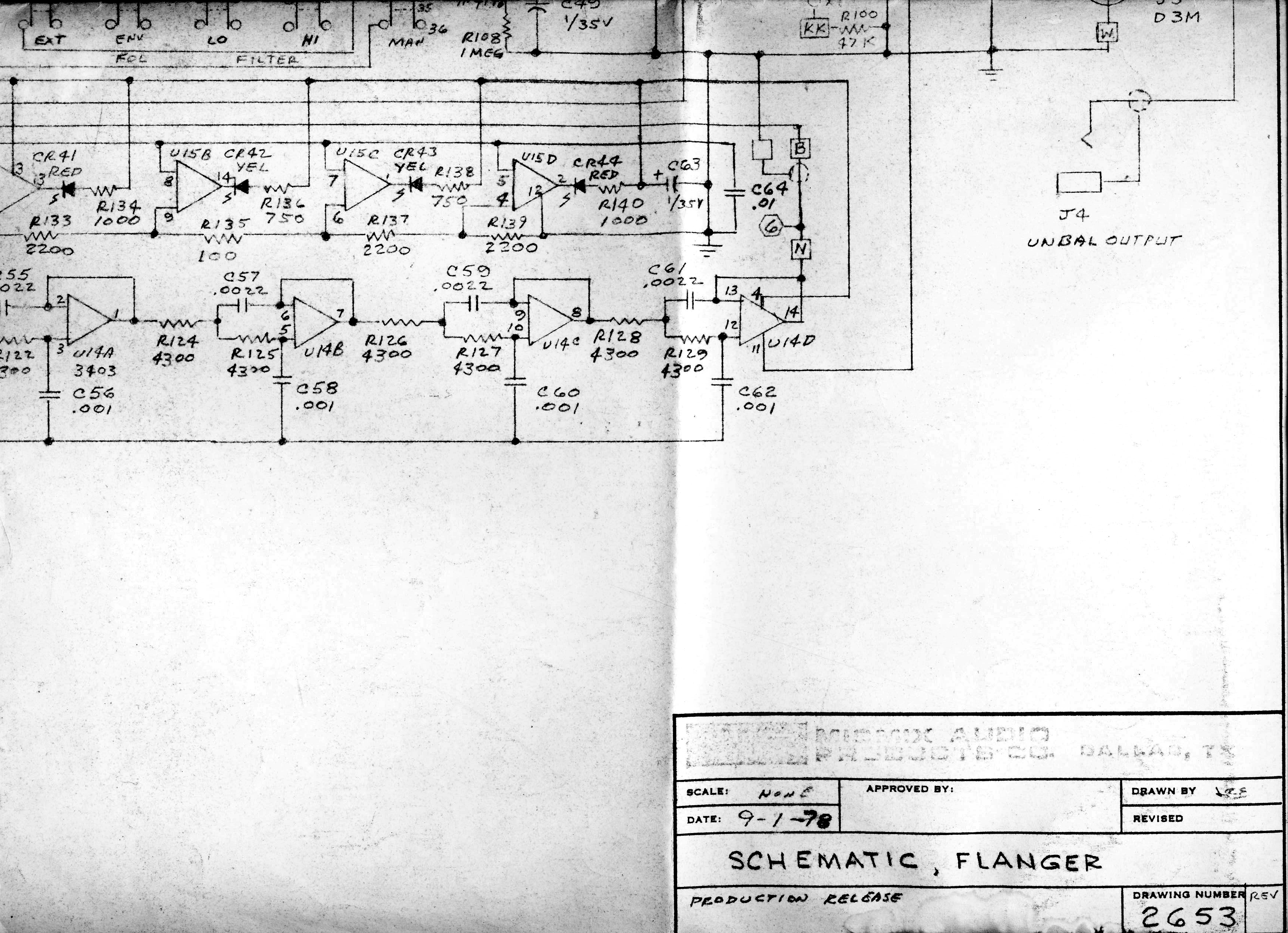

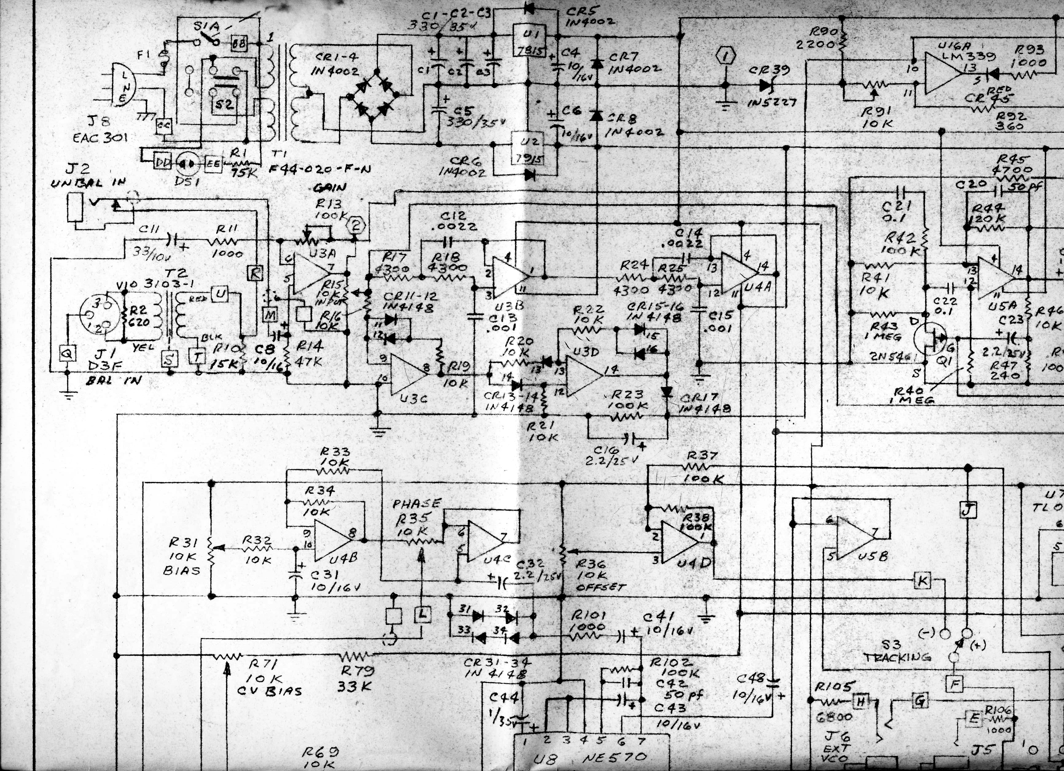

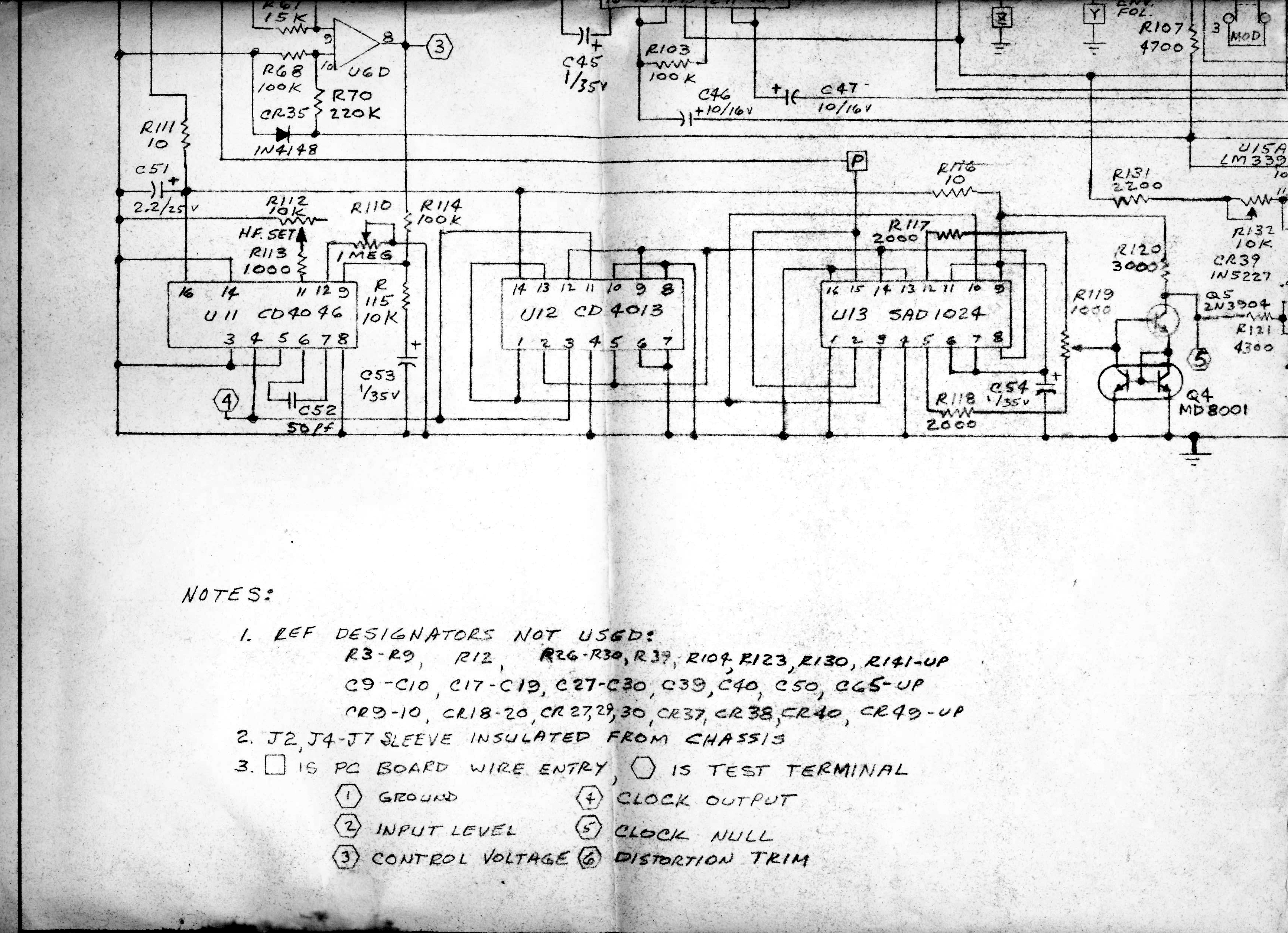

The schematics, in four tiles, are each about 4 Mbytes:
http://www.ka-electronics.com/images/jpg/Dynaflanger_Tile1.JPG
http://www.ka-electronics.com/images/jpg/Dynaflanger_Tile2.JPG
http://www.ka-electronics.com/images/jpg/Dynaflanger_Tile3.JPG
http://www.ka-electronics.com/images/jpg/Dynaflanger_Tile4.JPG
Note the Wilson current mirror at the output of the SAD1024. It really lowered distortion and increased headroom. I think, don't remember the level and frequency, that it went from 3% THD to 0.8%.
If I had to do it all over again I would put an exponential converter ahead of the high frequency VCO clock generator. It makes the frequency and envelope tracking a little more musical. I did it for a SSM2040-based phaser and a stereo synthesizer and it was far more musical and adjustment was less touchy.
