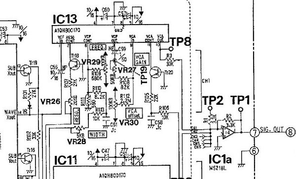

Hello,
I just got tired of fixing the two 80017a IC clones I bought for my Juno 106. Not counting the loud VCA thump I couldn´t get rid of, I just discovered they invert the signal, which was causing some bizarre effects in unison mode. So to the trashcan they went; time to order two NOS ICs...
But before ordering, I would like to know your opinions on the subject of this thread. Is it possible at all? If it is, these 80017a ICs with which some Roland products are cursed may be a blessing, actually. Instead of trying to clone the circuits you could simply plug & play with the filter/VCA sets of your choice!
Space inside the synth looks scarse but there should be enough clearance for the PCBs. Plus, if you look at the schematic you´ll see a good number of "peripheral" parts are already on the main board.
- SSM2044 plus simple CA3080 VCA seems to me the best option.
- CEM3379 would be more practical but are even rarer.
- A Moog ladder plus CA3080 would be my first choice because of the sound, but it uses a bigger number of components. Still, there´s plenty of room for SMD parts...
So what do you think? I´m far from being an electronics expert so every technical advice would be welcome.

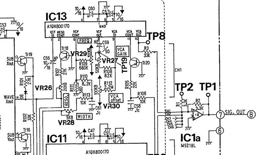

Here´s the IC in "detail". As you see Roland didn´t provide much information, hence the difficulty in cloning it. Still, we see the +15V/-15V power rails, the two ground points and that a BA662 was used. I guess the CA3080 may need a buffer.

I finally managed to put the 3080 to work properly.
- Shunted the mainboard pins 1 and 3 (no VCF yet);
- From pin 9 to inverting input of 3080 as well as a 220R to ground;
- Another 220R to ground from non-inverting 3080 input;
- 3080 output direct to mainboard pin 10;
- Mainboard pin 11 to 3080 pin 5;
- Power rails...
- Calibrate...
That´s it! VCA done for now. Output is slightly hot. Don´t know how full six voices will behave. Hopefully the filters will tame it a little.

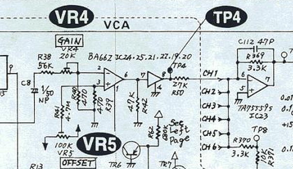

Update:
120k instead of 220r sound better and way easier to calibrate.
Sounds snappier, I think.

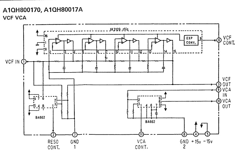

The chips finally arrived from HKSS and breadbording already began. It was all very straightforward. The only thing that didn´t work right from the start was Q control. Bypassing the PNP transistor Tr18 with a wire (one for each voice) will be the only modifications to the mainboard.
A preamp stage (TL071) was required between the SSM and the 3080. Thanks to BlueHell for the advice posted in the Simple VCA thread.
I think it sounds nice. A bit crude compared to the Roland filter, but very expressive. Perhaps another preamp stage before the SSM will refine it.

People, guess what? The built-in R111 makes this filter track reasonably well over 5 octaves, so there´s no need for a Tempco (and it had to be one for each voice module!).
I finally removed all the remaining 80017a chips from the mainboard. Selecting unison mode turns it into a mono-synth.
The TL071 preamp stage with a gain of 47 before the filter makes it sound much better. It is necessary to mix up the two waveforms plus sub-osc, but it may be overdriving the filter too much, so I´ll try other FB values later and post the results.

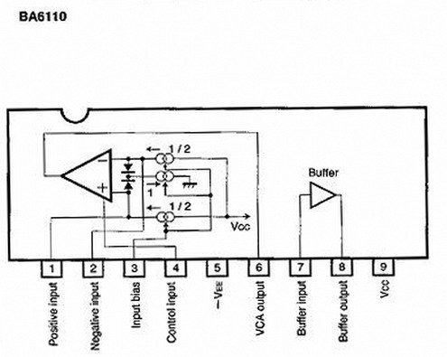

For the VCA anything goes, but instead of a CA3080 plus buffer opamp today I´d choose a BA6110 Idea . Easy to get from Hong Kong Super Seller at Ebay.

The BA6110s arrived only yesterday from the well-known HK store. I got 25 chips for 15 euros or something. They look brand new. I tested two so far, and they´re all good.
I chose the BA6110 because it seems to share the same characteristics of the BA662 (plus a bit better snr) so it´ll make life easier.
So the VCA part is done. The needed components are just three resistors. I re-attach the schematics plus the 6110 pinout.

Here´s the VCA from the Juno6. We can unashamedly copy the resistor values cause they´re about right. The resistors are R39, R40 and R42.

To test the BA6110 on the Juno106 without the filter I did as follows:
Take IC13 in the JUNO VCFVCA.jpg as ref.
Bridged pins 1 and 3 to make a direct connection to the Wave Xout;
From pin 9 (VCA in) ran a wire to BA6110 neg input (pin2) and a 470R to ground.
From BA6110 pos input (pin1) goes a 470R to ground;
From IC13 pin 11 (VCA Cont.) ran a straight connection to BA6110 pin 4;
BA6110 pins 6 and 7 are shunted and from there goes the 47K to ground;
BA6110 pin 8 (buffer out) goes straight to IC13 pin 10 (VCA out). I forgot to search for DC at the output, sorry. One might need a blocking cap there...
IC13 pin 4 (+15V) to BA pin 9;
IC13 pin 5 (-15V) to BA pin 5;
IC13 pin 7/8 is ground.
I left BA6110 pin 3 (input bias) unconnected... required resistor seems to be 150K but I do not have any at the moment. Didn´t experience any trouble without it, just the usual but barely noticeable bleedthrough... If someone recommends to use it please say something. Thanks.
For now, that´s it. The VCA sounds clean and dynamic. I´ll post an audio example if anyone´s interested.
Best of it, it doesn´t thump. In fact, the onboard trimmers don´t even change the sound much, so it will be easy to calibrate.
