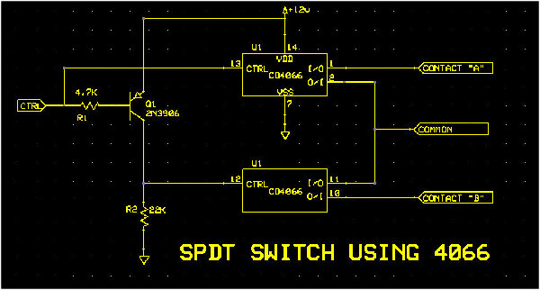

Hello All,
I need to drive a relay from the ADV-MIDI circuit of yore. The output of the latter is the typical 2N3904 arrangement running on a +5V supply, providing a 5 mS pulse. The relay will control the footswitch input of a digital recorder (for punch-in).
Anyway, I don't know a thing about relays. (If you didn't know, I've never had a course in electronics, hence the sketchy background). I was thinking of getting a +5V relay from All Electronics for this application. Can anyone suggest what I ought to be looking for? I have no idea what parameters are important. Also, I seem to recall from some distant reading that I need to install a reversed diode to clamp negative excursions caused by reversed EMF (to keep from frying the ADV-MIDI transistor). Is that right?
I do have a ton of the ADV-MIDI PCB's and also the MTS-100 PCB's should anyone want to swap me for a relay that'll work here. I need a +5V unit, with a SPDT arrangement.
And maybe I should ask, can I expect an ON/OFF time of 5 mS or so, or is that unreasonable?

Hi Thomas,
I have several pcb mount relays that will work in your application. What is your contact Volts/Amps requirement?
This, plus coil voltage and resistance constitute a full spec.
I have both a 14Pin dip package (same footprint, but thicker by about 1/8"), and a std size (.800 x .625 x .800 tall.) PCB relay with 10A contacts. Both are 5v coil, SPDT, sitting in front of me and could be on their way to you later today if you can use them. If you need more than one I have at least a dozen of each type.
You are correct about the use of an inductive spike clamping diode. A 1n914 or 1n4148 will work fine at low amperage; I like to use an MRF851 at higher amperages. Or an RC snubber. (Depending upon your contact rating and current, a snubber there also can be a good idea to protect the contacts.)
One gotcha some people miss is that the DC rating for a given relay's contact are as you'd expect QUITE a bit lower than the AC rating. if you're switching a DC load, be sure to check this particular spec carefully.
5ms is a reasonable switching time. Should be no problems there with most any garden variety PCB mount relay.

Five millisecond switching and a SPDT arrangement, sounds like a good application for an analog switch if the current requirements are not demanding and it really doesn't seem the case according to what you are saying. You are just emulating some switch contacts on a foot pedal. You can also take a CD4066/MC14066 and a single transistor inverter to drive two switches out of phase and make a SPDT out of that and probably get job done. Also no "snubber" diodes to eliminate any high voltage spikes used with conventional relays.
Let me know ......... Very Happy I have a bunch of DGxxx series switches hanging around also. I also have some Maxim analog switch IC's hanging around also. Very Happy I am sure we can get something working Very Happy
Yes, the 4016 occurred to me early on. But here's the deal, I'm controlling a unit whose input I know nothing about. I haven't the faintest what sort of electrical standards the footswitch input obeys, and given that it costs $350 don't want to take the risk of blowing it. A relay is totally innocuous here, but a CMOS switch...well, it probably is, too, but I sure don't want to take the risk without knowing more. Moreover, interfacing CMOS to external jacks is always a bit problematic (static, etc.). Call me a nervous nellie, but CMOS makes me wet my pants in this sort of application.
Actually, since the 4016/4066 is a quad package, a person could make a SPDT with no extra transistor needed.

Yes, I would be cautious to Very Happy Oh, I have attached a diagram I just put together that shows what I meant about using a 4066 as a SPDT switch ...

Again, the transistor is superfluous. Just use one of the other switches as an inverter instead of the transistor. That's a trick I pulled some 25 years ago with the ADSR or PAL filter (it's so long ago, I can't even recall which!)
Along these lines, did anyone notice my 4016 as an XOR trick which does something similar?
Bingo ........ now I see. NICE ... Very Happy Very Happy Very Happy Had to sink in there. Hmm, let me draw that one ........
