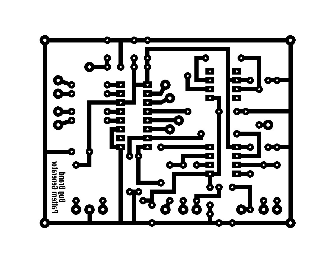

Finished my first iteration of this dual pattern generator. I replaced the simple diode inputs with the input comparator (X4) that Ken Stone designed for his Gated Comparator, since it's nice and flexible. This way I can clock each pattern generator off any input signal, not limited to pulses. The comparator has additional offset inputs, so you can create quite complex timing variations if you voltages going into all eight inputs.
It's an interesting enough module, very mesmerizing when you get both sides going and use them to control different things, fading between them. Things that I think that would greatly enhance this module:
1) CV Processor - A circuit that would allow mixing of both of a dual unit's outputs, including inversion and lag. Matthias Hermann's found on http://www.modular.fonik.de/Page15.html is good candidate for this.
2) One unit's timing input could control the other. Switching jacks would make this easy. You could have both units in sync this way, but use offset voltages to provide variations (if you're using the CGS comparator).
3) Boolean logic for processing the pulses. Ryk's suggestion was definitely right on track. I think this would be a very useful mod for a dual unit... I'm thinking if they both use the same input clock signals, but one side XORs the pulses, and the other ANDs them (for example) would create some interesting timing relationships. Obviously, there are many possibilities here.
All in all, I'm glad I built this unit. It's a great alternative source for CV patterns. Thank you Mr. Bugbrand! Wink
[Edit]
Am adding my PCB layout. This has been tested. Includes the comparator (x2) as found here: http://www.cgs.synth.net/modules/cgs13_gated_comparator.html In the schematic, it's the circuit at the top left that connects to pin 7 of the CD4015
Bug brand pattern Gen PCG (tested - Works!)
 Filesize:  160.45 KB
 Viewed:  329 Time(s)
Parts placement for above PCB
 Filesize:  231.27 KB
 Viewed:  312 Time(s)

23isgood wrote:
Hi Rykhaard. I'm really looking forward to see how your project turns out, especially some videos.
pete
Hey 23! Smile (Love that #. Very Happy )
PCB layout is taking a little longer than I thought. Both Patt.Gen.'s with the above mod. have been drawn to copper and 1 of the /7 counter's has been. Possibly tomorrow, I'll have the rest done. Smile
I realized at work tonight as well - to do the NOR and NAND versions, I'll have to slip each of the logic Gates inbetween the Comparator and the Patt.Gen. Just looking at the PCB layout above, it shouldn't be any trouble. The Logic Gates can slip in the Comp. to Diode to Pat.Gen. area. Thank golly.
I was wondering at work (not having the schematic with me) if I could add External Input Jacks to the CD4052's as well. Realized though, that I'd have to sum the Pot and Input for each of the 4 channels. Will keep that in mind though, before I cook the PCB, just in case I can do that extra modification as well. Smile
I'm also going to be adding to the entire panel at least 2 x Attack Decay EGs, with Decay and Amount controls along with momentary buttons and possibly 1 or 2 Attack Release EGs with A, R and Amount controls as well as switches or momentaries. Shall have to see how my panel real estate turns out for availability. If the PCB doesn't get too big, I may move up to a 4U panel, to give me 7" of panel height.
As soon as the first portions of modules are up and running, I'll be shooting and posting audio/video of it. Very Happy
(edit) I just had a look at the PCB layout above again: for the 4 channels, there's the direct hookup to the CD4052. So I possibly COULD add a quad opamp for each of them, to sum the pot and external inputs for each channel. Though - I'd have to limit them to +V only. I'll keep it in mind. Smile
