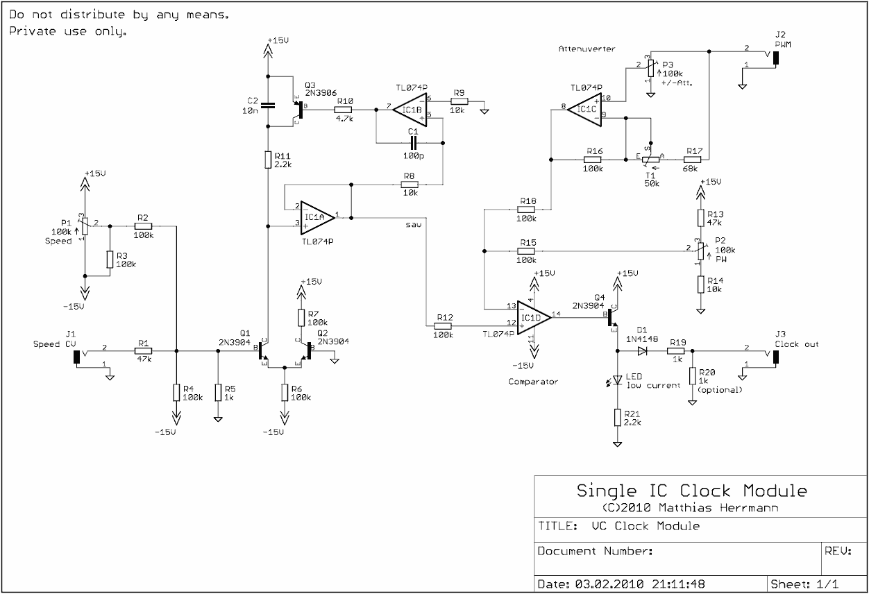

Here's a simple little circuit I cobbled together for use with the Klee (though its use goes well beyond this).
I've been a total magpie on this! Its a meeting of Ray Wilson's Soundlab LFO and the PWM from Thomas Henry's VCO1
You begin with a triangle wave (would be nice to make this VC but not too much worry..) and simply comparatorise it. I added on a diode and resistor combo on the output to make sure you're getting positive going pulses -- I've been running this on +-12v and have been getting slightly under 10v pulses.
Notes:
- I haven't specified the values of C1/C2 because I haven't tested this in a system yet -- I'll check these by experimentation -- for the Klee I'm definitely interested in checking the audio rate clocking possibilities.
- as stated, I ran this off +-12v just fine. May need a little tweaking at 15v but quite possibly not.. You may have to adjust the D1 / R10 arrangement a bit if you require more precise or particular gate signals.
- for my Klee I'm actually going to be doing this without the PWM CV input (no space on the panel, so just the manual width control) and may tweak the value of R9 down a little bit so that you can never get a fully OFF or fully ON pulse train.
- one chip!

Hey Bugs, just wondering what are the advantages of this op-amp solution over a clock and PWM with a hex schmitt trigger?

Golden - I did first of all try ideas with the 40106 but... well, just using the 40106 didn't give great results and you don't get the PWM input. The comparator method gives good stability.
Before using the LFO schem I did actually try using the tri-wave from a 40106 osc (you have to buffer straight from the junction of the cap, resistor, gate input) but that wave wasn't ideal - needed amplifying and level shifting. The LFO tri-wave, on the other hand, is a perfect level!

Just coming back to this...
There's actually some issues.... HoHum...
1) Cap values - I've currently got 4n7 and 47n - 4n7 gets up well into audio range
2) The PW idea maybe isn't so great for clock generation actually - I had a slight DUH moment -> adjusting the width (ie raising the comparator level) shifts the relative position of the pulse -- oops, so while you'll keep the tempo constant you'll shift the beat a bit --- that is not so good!
3) I also had problems with this at low rates (it added some confusion to Klee investigations) -> at low freqs the pulse wave edges were not good - little glitch/bounce -> caused some double stepping = bad!
So I increased the hysterisis resistor R6 to 470k (from 2M2)
Yes, what you are doing is pulse position modulation which is really a nice way to add "swing" to a beat so sometimes that really is not that bad after all. You would have to compare agaiinst a ramp waveform for PWM exclusively. I am sure you know that by now but firgured I would make a little noise ... Very Happy
Looking at this fast, you can just add a FET across the integrating capacitor to get ramp voltages by rapidly discharging it. This will raise the frequency so you would have to adjust your timing components. For the output comparetor configuration you currently have, you would probebly need a negative going slope on the ramp :
Hows is going fellow Klee-Meister ??

Hey Bill - yeah, the realisation of the fix came to me this afternoon too - though I haven't tried it out yet... Yeah, ramp down should be perfect -- & I think you only need to add a diode to reset (done similar with LFOs based on similar core design) (maybe a small value resistor too).
Though, yes, a bit of swing is definitely interesting!
Yes sir. Nice. The diode is cheaper also Very Happy Very Happy Nice circuit, and one inexpensive chip !! Good work so far man ! Just a bit of tweaking thats all Very Happy

i thought it would be good to resurrect this old thread, since tonight i built another one chip clock module with PWM for the klee2. i still have it on a breadboard, so no pix or samples right now. but it's tested and works quite nice IMHO.
it provides a speed control & VC speed, a pulse width control & VC pulse width. the resistor values are for 15V operation and 5Vp-p control voltages. for 12V operation it would require some changes.
it is based on the EFM bassace VCO, thus providing a falling ramp. this is good for not getting out of tempo when doing PWM with a comparator (see previous posts above).
i simplified the circuit. it is not 1V/oct or temperature stabilized anymore. i thought this would not be necessary for a clock module. however it is working in a wide range, even audio.
the VCO uses 2/4 of a quad opamp, and 1/4 for the comparator creating the pulse. i used the left opamp for an attenuverter on the PWM input.
EDIT: the saw from the VCO core has to be 0-5V to match the resistor values of the PWM circuitry. so you may have to add an attenuverter between IC's pin1 and R12. i found out that while the TL074 i used on the breadboard put out just those 0-5V, the TL074 i used on the PCB put out 0-12V...
