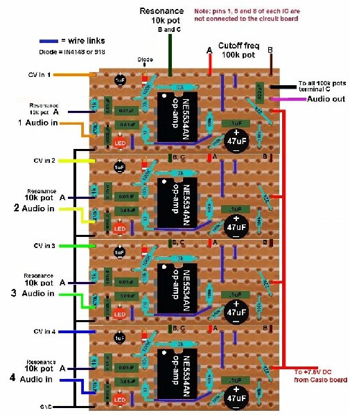

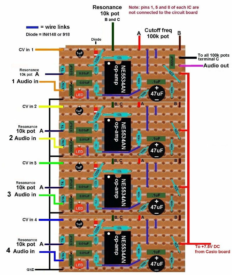

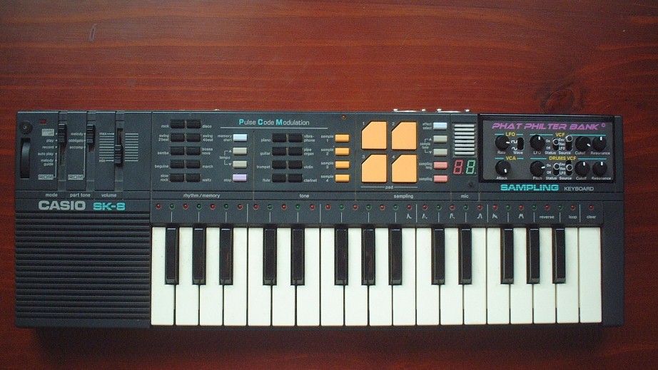

Hi Everyone,
Well, I've just completed a huge project, which has been on my mind for a while now, ever since finding this forum - to build a true polyphonic, 4-voice VCF module, with CV input and resonance, running off 9V DC.
It has taken me about 3 months of spare time to get this thing researched, thought out, breadboarded, built and optimised for the Casio SK sampler keyboards (I have an SK8). But it has finally come!!
Below are the results of my efforts.
But I wanted specially to post this message, in order to say a big THANK YOU to everyone in this DIY community; for both directly and indirectly helping me with this project by the way of advice, and links to circuits and information.
I especially want to thank Tim Escobedo, who designed the Q&D VCF, from which this quad VCF is wholly adapted from. Using it as a starting block got me half way there in one hit! Thanks to all the people here who put me on to it!!
I've written up a complete illustrated guide on how to make this quad VCF, which I call the "PHAT PHILTER BANK", and how to set it up for the Casio SK series keyboards. The guide is here, at the bottom of the page here:
http://www.jz-server.de/forum2/e107_plugins/forum/forum_viewtopic.php?559
There is also on that page an mp3 example of one of the SK presets with the filter applied. Makes the humble SK-8 sound like a real analog synth!!
You can also make it as a stand-alone unit, or adapt it to another type of keyboard, although another keyboard may or may not be able to take advantage of the full features that this VCF unit has - such as CV input. The SK samplers have separate internal envelope CV signals for their VCA's, which is particularly useful for driving this VCF. The guide shows you how to set it up in various ways.
Again, thank you all SO MUCH for sharing the knowledge that enabled this to happen!!
Cheers, Graham

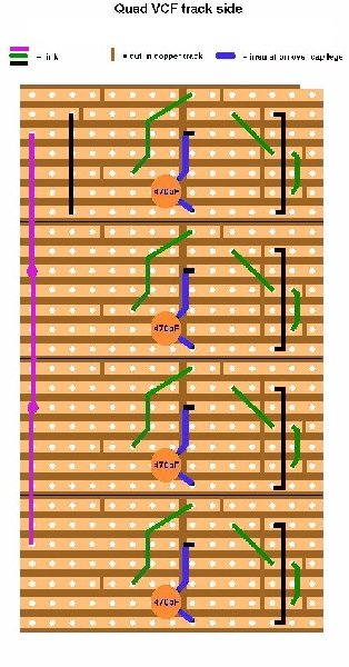

Component side of the PHAT PHILTER BANK
 Filesize:  185.93 KB
 Viewed:  941 Time(s)

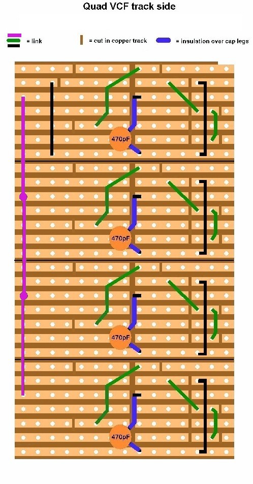

Track side of the PHAT PHILTER BANK
 Filesize:  133.13 KB
 Viewed:  752 Time(s)

Neato Burrito!
I had no idea you could do that with an SK series sampler. You definitely get points for venturing into new territory. Only one request: can you possibly post an audio clip or two here so I don't have to go sign up for another Yahoo group? I have too much email to sort through as it is Wink Thanks!
Tim (having a neato burrito with salsa) Servo

VERY! Nice!
Congratulations. Beautifully integrated into the synth!
Kind regards, Randal

I actually don't have any schematics for it that I've drawn myself, as the circuit is a simple adaptation of Tim Escobedo's Q&D VCF, for which the schematics are here:
http://filters.muziq.be/diy/lehrberg/qdvcf
My circuit is basically 4 Q&D VCF's hooked together, with a few extra resistors and capacitors on the inputs and outputs, to optimise it for the SK samplers.
Cheers, Graham
