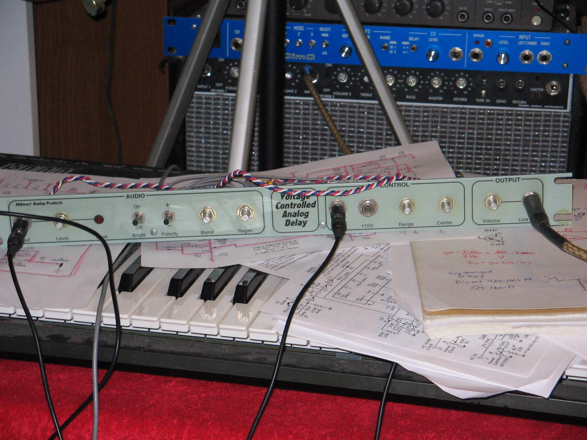

A little over a year ago, a mysterious package from Mankato arrived at my doorstep. I opened it up to see what appears in this attached picture - a MAP Voltage Controlled Delay. Along with it was a myterious phase shifter prototype called the "MultiPhaser", which was exactly one letter off from my now long neglected MultiPhase project. Little is known of who sent them to me, some guy in North Mankato, MN....... Studs Kreitzer I think is his name. Very Happy
Anyway, the VCD had a SAD4096 in it, but, unfortunately it was a dead/dying IC. I think something about the process for making the SAD4096 caused its guts to slowly disintegrate over time - I've heard horror stories.
I had no SAD4096s, but I had a few SAD1024s. I breadboard a little interface from the VCD to the SAD1024 (I was only using half of the SAD - 512 stages IIRC). It sounded marvelous. Obviously gone were the long delay times, but what replaced it was a pretty nice flanger/chorus device. Oh, how I wish I would have made some samples of it - I was off on some other project at the time (Klee) and it's one of those things that is in my "to be finished" pile. It had a wonderful, deep sound, and great noise reduction.

MAP VCD built by Thomas Henry, spliced into a SAD1024 sitting atop my DW6000 (the only room I had at the time).

The Time Machine used the MN3005, which has long since been out of production, and they can cost you a pretty penny (Small Bear has them). IIRC, John Blacet would actually select them - seems to me he would sell the MN3005s that worked pretty well for long echo effects, but couldn't quite wind up fast enough to get the short delays he accomplished with the Time Machine.
Some Panasonic BBDs have been "second sourced" (cloned) by foundries in China. Shanghai Belling, to be specific. Sadly, none of the higher voltage devices (MN30XX) have been cloned, but rather the second generation lower voltage devices (MN320X) have been. The only three that I'm aware of are clones of the MN3207 (1024 Stage), MN3208 (2048 Stage) and, most recently, the MN3205 (4096 Stage), which is the low voltage equivalent of the MN3005.
Small Bear carries all three - the BL3207, BL3208 and V3205.
Having harped on the low voltage vs high voltage BBDs, that doesn't mean the low voltage ones won't do the job - it takes a bit more finagling AFAIC. My Dim C uses 3207s, and I'm much more than extremely pleased with how it came out.
Also, you'll notice that the spec'ed clock frequency range of these devices is fairly low. Actually, don't let that datasheet fool you. I've clocked the MN3207 close to 1 MHz with no ill effect. The trick is that you have to use something other than the MN3102 to buffer and clock it, or buffer the MN3102. Without a buffer, once you get much past 200 kHz, the crisp pulses of the clock will begin to slew due to the capacitance of the load. It is very important for these waveforms to remain nice and crisp, and that they rise and fall at the proper time (the clock waveforms, as I'm sure you are aware, are a set of complementary waves).
