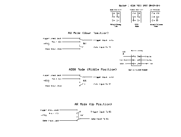

Could one of the more enlightened fill me in on the use of switching jacks for the gate and trigger inputs. Not exactly grokking what is going on here. I want to build it with bananas and would love to get around extra panel switches if I could avoid it (dreaming??).
I have it all laid out to fit 3 on a small board, but need to figure this out.
Thanks plenty.

I think Thomas may have a better explanation, but my take on this is that the switching jacks allow use of the ADSR with only a gate (useful for AR envelopes) OR only a trigger (useful for AD envelopes). The switching jacks aren't needed if both gate and trigger are used. I'm not quite sure how to implement this on a banana jack system.

For emphasis, you can use this thing as an AR, AD or ADSR depending on what plugs you've inserted.

Hey thanks Tim and Tom. With this increased understanding I think I will work out how to cram the switches in.

Hey Numbernone,
This sounds like a job for....Super Switch!!
Faster than a speeding bullet, able to leap tall buildings in a single bound, and capable of feeding one his cake while letting him keep it, too, the mild mannered C&K 7211 ON-ON-ON SPDT switch may be able to provide a control that provides (in its three positions) AR/AD/ADSR.
Lemmee think about this - either it'll work, or this post is all wet....

OK, how about this? I'm assuming it would work for those of the Order of the Banana Jack.
Three way mode selector for 21st Century Envelope Generator

Mouser stocks them P/N 611-7211-001. Not terribly cheap (7 bux apiece). A few years back Electronic Goldmine was selling them for a buck apiece, and Harry Bissell mentioned it on the SDIY list. It took a little while for it to dawn on me what all they could do. It doesn't seem like much when you look at the contacts made for each position, but it's become the solution to a number of switching dilemmas I've been faced with since. You can select between one or both inputs, set it up for 1 of three selection, things like that.
