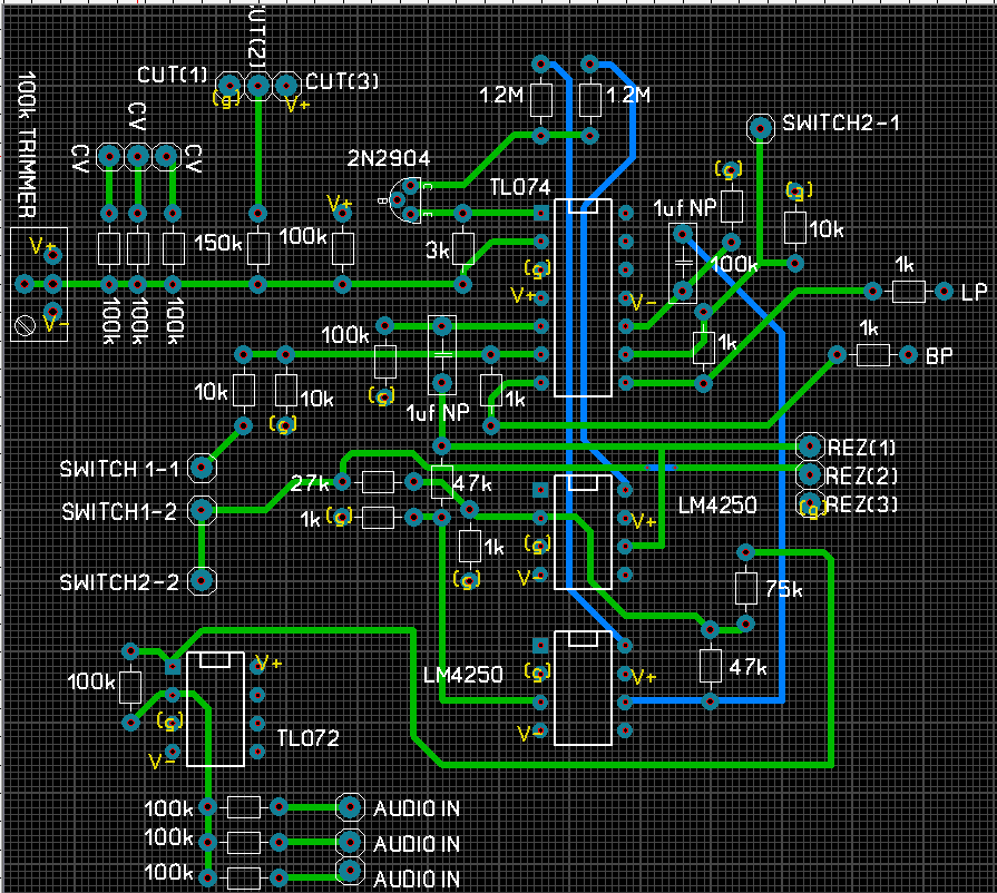

HERE'S A SIMPLE SCHEMATIC VIEW FOR ANYONE TRYING TO PROTOBOARD IT. IT HAS THE MODS FROM THIS SITE INCLUDED TOO.
IT ALSO HAS AN OFFSET MOD I DID ALSO.
I BUILT ONE A WHILE BACK AND VERIFIED THE MODS WORKING. IT WAS TESTING ON 12V ONLY.
http://www.synthnoise.com/polivoks.html
I AM GOING TO SOON TEST IT OUT BY BUILDING ONE FOLLOWING MY OWN DRAWING. I WILL SEE IF I DID ERROR'S.
(THIS DRAWING IS OLD, I HAVE AN UPDATED FIXED SCHEMATIC 2009)
POLIVOKS SIMPLE SCHEMATIC VIEW FOR PROTOBOARD BUILDING/BUILDERS.

I guess it needs decoupling at the power input for the board (ferrite bead + 10uF + 100n) ?
Does Marc's board has decoupling caps for any of the chips?

PostPosted: Sat Jan 19, 2008 12:30 am    Post subject: FIrst graphic error found. Reply with quote  Mark this post and the followings unread
I forgot to label a resistor coming off U3 LM4250, it is supposed to be R15 1k resistor value. I have assembled one on protoboard, it took about 40min and not bad at all as far as wire jumpering. I used this protoboard:

All the resistor values were intended for use with a LM4250 by the way. I live in california and those OG UA776 or MC1476's are no where to be found out here. If your going to use those you have to change R10, R11 to 110k.
This circuit is so easy to build i say build both versions! If you have that luxur y of finding those dam IC's of course.

haxster: why are you using a dual opmap (LF442) for U2? You seem to have kept the pinout of a single opamp there, which can't be right...

Here is an updated schematic for the Polivoks VCF. This circuit is working and takes care of the Cutoff problem. There is a 100k trimmer to fix that.
(g)=ground, V-=negative voltage, V+=Positive voltage.
TL074 pin 2 is were you do Voltage Convtrol: CV, put more 100k resistors if you need more CV inputs.
UPDATE FOR THIS DRAWING: 2009
(THE 100k 'ADJUST' TRIMMER NEEDS a 100k resistor in between the trimmer and PIN 2) it will still work if you forgot it, but the resistor helps you adjust alot smoother. in other words the trimmer middle pin should be connected to one of those 'CV' holes instead, not direct like it is in the picture.

THE POTS ARE NOT CRITICAL, they can be 100k or 50k. The 100k trimmer will calibrate the cutoff range anyway. On this layout the FM input is not on this one. This is a simple version of the polivoks to get you at least making sound.
haxster
Joined: Feb 01, 2006
Posts: 246
PostPosted: Sat Dec 06, 2008 11:49 pm    Post subject: Reply with quote  Mark this post and the followings unread
The Transistor is 2N3904, there is a Typo. For beginners---> on the Audio In and CV inputs use 50K or 100k Pots and wire them like this: (1)ground, (2)CV or AUDIO IN(the one your working on), (3) to the jack you like-1/4" phono or 3.5mm etc.

The Switch is a little Hack I found, if you build one you will hear a cool hack!
FOr the switches it reads like this: SWITCH#1 - (PIN)1, SWITCH#1 - (PIN)2.........SWITCH#2 - (PIN)1, SWITCH#2 -(PIN)2.

what are you doing exactly with the switch ?
What result you get soundwise ?
thanks for posting !
haxster
Posts: 246
PostPosted: Sun Dec 07, 2008 7:40 pm    Post subject: Reply with quote  Mark this post and the followings unread
You get different Rez notches, it is a Rez Notch Hack.
