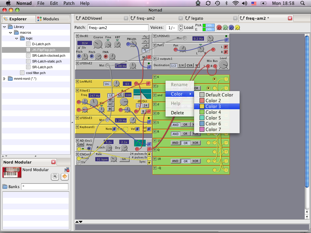

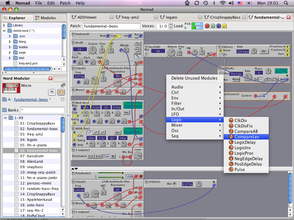

Here are two screencasts from Manuel:
http://inflection.bl0rg.net/~manuel/nomad1.swf
http://inflection.bl0rg.net/~manuel/nomad2.swf
and below two screenshots of nomad.
nomad shot 1
 Filesize:  210.02 KB
 Viewed:  762 Time(s)
nomad shot 2
 Filesize:  273.12 KB
 Viewed:  762 Time(s)
