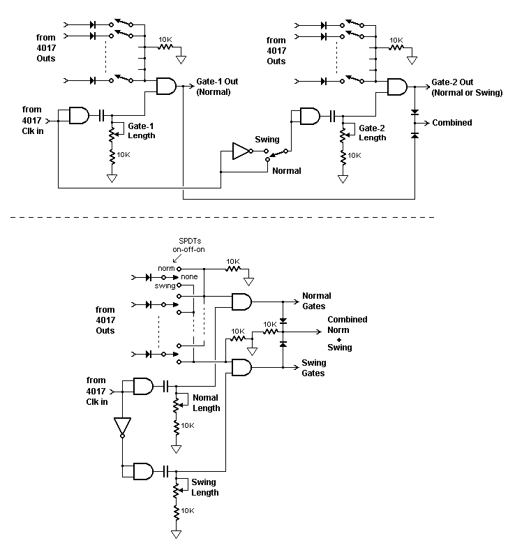

widdly wrote:
What about 20 steps from a single 4017?
I think it would work. Needs a dual-gang pot though and the clock needs to be 50% duty cycle.
The one-shots (the two inverters-cap-pot circuits) are in the wrong location. They have to be between the clock and the AND gate(s), otherwise for any two or more consecutive steps with closed switches there's no gap between them, and only one pulse occurs, at the first of those two or more steps -- that is, the steps are merged again, but instead of one long gate out you'd get only one short one at the start of the first of those consecutive steps.
What you have there is something approaching your second idea, for "swing" gates, since one one-shot triggers at the start of a step (the rising edge of the clock,) and the other sometime after, at the falling edge. You could use a ganged pot but separate pots would be more versatile. Let me think about this some more, but...
The Baby-10 seems fine, for what it is, but there's only so much you can do with one 4017. When you start piling more logic it, you might as well go for one of the many, only slightly more complex designs floating around.

PostPosted: Tue Apr 08, 2008 7:48 am    Post subject: Reply with quote  Mark this post and the followings unread
The clock is inverted before the 2nd AND gate so only one AND gate can be open at any time. As long as the one-shots are shorter than the clock duty cycle it will be fine as it is.
Seperate pots instead of the dual-ganged would work to.

PostPosted: Tue Apr 08, 2008 8:06 am    Post subject: Reply with quote  Mark this post and the followings unread
widdly wrote:
...only one AND gate can be open at any time. As long as the one-shots are shorter than the clock duty cycle it will be fine as it is.
Wrong. The way you've drawn it there can be steps with no gap between them. The one-shot(s) will fire only at the start of the first of any gap-less steps, recreating the problem loss originally pointed out. Read the earlier posts.

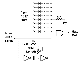

PostPosted: Tue Apr 08, 2008 11:00 am    Post subject: Reply with quote  Mark this post and the followings unread
loss1234 wrote:
the way i wired it, i took a diode out of each step, into the switch, then i chained all the switches together and put that into one half of a diode AND> with the other half of the diode AND being the cd40106 inverter being fed from the trigger clock to change the gate length...also, is the cd40106 the right kind of inverter to use for the gate length changer??
thanks
It doesn't matter (much) if the diodes are before or after the switches, but the diodes from the 4017 outs are an OR function. You can't follow that with a diode AND. It won't work. It has to be a real AND (or a NAND followed by and inverter).
Anything that inverts will work for the one-shot: could be NANDs or NORs with both inputs tied together. A Schmitt would be nice and snappy, though.

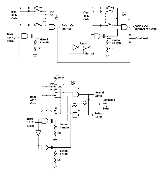

PostPosted: Wed Apr 09, 2008 3:02 pm    Post subject: Reply with quote  Mark this post and the followings unread
I wrote:
Anything that inverts will work for the one-shot...
Actually, on reconsidering, all those inverters aren't necessary. One input of the AND with diode-ORed 4017 Outs could be part of the one-shot if the timing resistor is pulled down instead of up and another AND buffers the clock. Build two of these with one quad AND and you'd need an inverter only if you want the "Swing" option.
This would be good for a Baby-10 like fonik's, with two banks of CVs and Gates. You could have two melodies going, with steps of different durations, with one of them optionally syncopated.
The 2nd circuit below uses center-off switches to allow any step to be Normal or Swing. Patch the separate Gates to two Envelopes and two VCAs and the melody will pan. Or use the Combined Gate out. Note, however, in both circuits, that if a Swing step with a long duration is followed by a Normal step, the Combined Out gates will merge into one long one, giving only one Attack.

PostPosted: Wed Apr 09, 2008 3:36 pm    Post subject: Reply with quote  Mark this post and the followings unread
richard64-
i was going to ask, i had some problems with the inverters. after removing the offensive diode AND circuit (which was messing up my gates btw) I tried your FIRST schematic and it didnt work. maybe it was too large a pot or cap value ( i tried a 103 cap between the first inverter and second, and a 100k pot 10 1k to volts) no luck. it works better with just the gate outs straight from the diodes of each step...
so i want to try the new verison BUT should i try a different cap value? (i was anding with a 4081 btw)
thanks

PostPosted: Wed Apr 09, 2008 6:10 pm    Post subject: Reply with quote  Mark this post and the followings unread
loss1234 wrote:
richard64-
So, it worked without the one-shot, just letting the clock shorten each step? That's encouraging. Still, it should've worked, especially with 40106's. It could be that the cap was too small, causing the pulse to be too brief. Try .1uF or even 1uF or more and/or a higher value pot, or higher resistor in series with the pot.

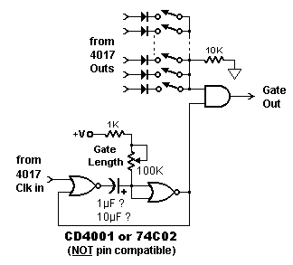

PostPosted: Fri May 30, 2008 1:22 pm    Post subject: Reply with quote  Mark this post and the followings unread
richardc64 wrote:
Try this. The "gate" will be the same length as the high portion of the clock -- half a step if the clock is a square-wave. If you want more control, add the - - - - circuit - - - - .
the --------circuit----------- :
what IC do i need for that ?
And what value for the Cap is required ?
richardc64
Joined: Jun 01, 2006
Posts: 679
Audio files: 26
PostPosted: Fri May 30, 2008 4:06 pm    Post subject: Reply with quote  Mark this post and the followings unread
Funky,
Those are inverters, and any of several ICs can be used: CD4069 or 74C04, or CD40106 or 74C14 Schmitt triggers. They could even be left-over NORs or NANDs with inputs tied together.
But I'm thinking maybe the 4017 clock is too brief or narrow to reliably trigger the one-shot, which is a half monostable and something slightly different is needed: a full monostable, as shown below.
R/C values shown are only suggested. Experiment!
