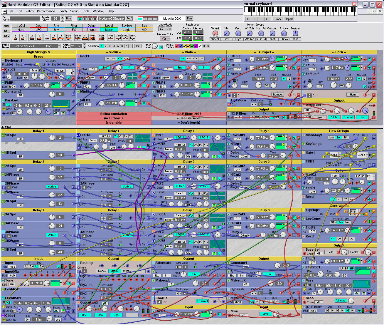

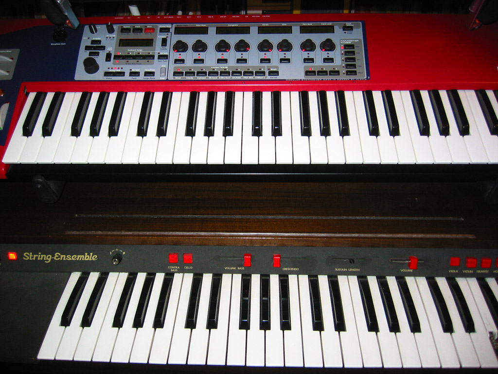

I've been working on the Solina G2 patch for around 6 months. Final fine-tuning required access to sounds of a real Solina. Unfortunately, I was unable to obtain the necessary Solina recordings. Eventually I bought a Solina just to use as reference.
The Solina G2 patch is structurally modelled after the Solina schematics. Filter settings have been adjusted with assistance from oscilloscope and my ears. A few of the filter settings deviate quite a lot from what was expected from the schematics. The chorus ensemble settings are based on schematics, a circuit simulation and my ears. In the end all main and bass voices sound (and look on 'scope) very similar to my real Solina, both without and with ensemble-effect active.
After eliminating all non-essential elements from the voice area, memory load is 33,6 %. This allows up to 9 voices on an unexpanded G2 and 21 on an expanded.
The FX area contains the chorus ensemble. It has evolved from a recreation of the Korg SDD-3300 triple digital delay. Some controls from the SDD-3300 patch have remained even though they are not essential for the Solina chorus. For the Solina emulation a paraphonic envelope, chorus mono/stereo routing, tone control and volume control have been added. And the low strings (monophonic bass) are also part of the FX area.
By switching the FX area input from Bus 1/2 to In 1/2 (or 3/4) you can use the patch as a general chorus ensemble effect.

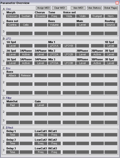

The Solina buttons and sliders are mapped to parameter pages A1 and A2. The Tone control (A1:4) controls the cutoff frequency of a 6 dB/oct lowpass filter. The Main Level control (A2:6) is independent from the Patch Level control (MIDI CC #7) and is intended for matching levels between variations. The Routing Source (A2:8) selects chorus output routing. Position 2 (of 4) is called "Mono3" and this is the standard mono Solina chorus setting.
Pages B1-E3 are only for experimental/developmental purposes. Use at your own risk!
Variations 1-8 are populated with miscellaneous settings. Please note that the Main Level is below 0 dB in most variations. This is to achieve approximately equal volume in all variations. When you experiment with your own Solina G2 settings, you can set Main Level to 0 dB in order to optimize S/N ratio.

My setup during the final phase of patch creation.

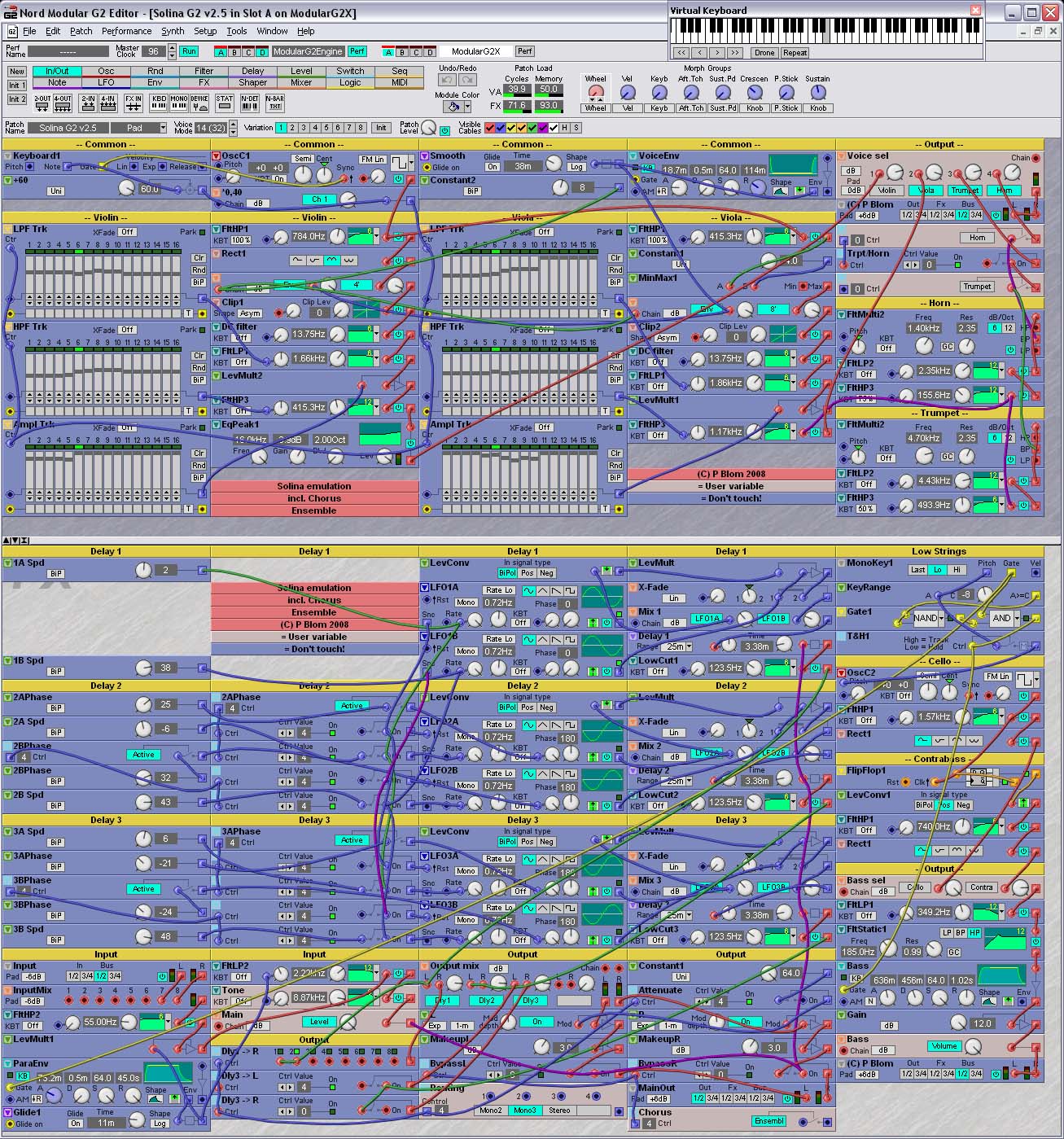

Here is an updated version of Solina G2 based on even closer study of my real Solina String Ensemble. The structural changes from the previous patch version are larger than the audible differences. Nevertheless, this patch represents the closest Solina emulation that I'm able to obtain with NMG2.
Some months ago I disassembled my Solina, because it needed service. With the circuit boards exposed, it became possible to study waveforms at multiple points along the internal signal flow. Waveforms were studied both visually on oscilloscope and audibly through monitor speakers or headphones. The added information gained from this process has allowed a more accurate simulation of the Solina circuits. Unfortunately, the patch load has increased, so with Solina G2 v2.5 you get up to 6 voices on an unexpanded NMG2 and 14 on an expanded.
To use the FX area as a general purpose chorus ensemble, some minor changes to the patch would be necessary to bypass the monophonic amplitude + filter envelope.

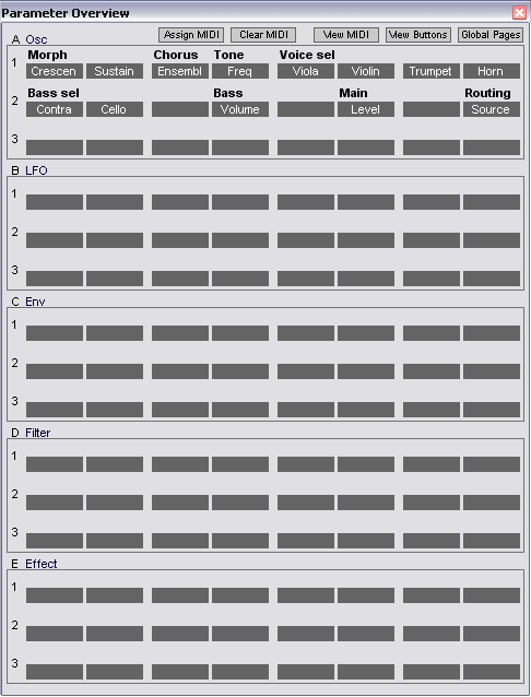

Parameter pages A1 and A2 are the same as in the previous patch version. All other parameter pages have been erased. No variations have been programmed.
This is a demo recording of the patch. No effects are used except for the chorus that is an integral part of the patch and a small amount of reverb/delay on the final part.
I see two remaining major problems with simulating a Solina on NMG2 with this patch. Both are due to the architecture of NMG2, and thus unlikely to be solved.
1. Lack of phase coherency between voices. This makes octave intervals sound bad, since the phase relationship between the voices is random instead of fixed (as in a TOS + divider type instrument). Repeatedly playing an octave interval sounds slightly (and sometimes not so slightly) different every time. A new oscillator module would be needed for this purpose. The algorithm is already implemented in Nord Electro/Stage/C1 organ simulation, so it is obviously doable.
2. Lack of key-to-voice assignment mode other than "Rotate". When repeatedly pressing the same key, you want the same voice to retrigger. Otherwise you get more and more voices playing the same note, and successively increasing the volume if Sustain is set high.
