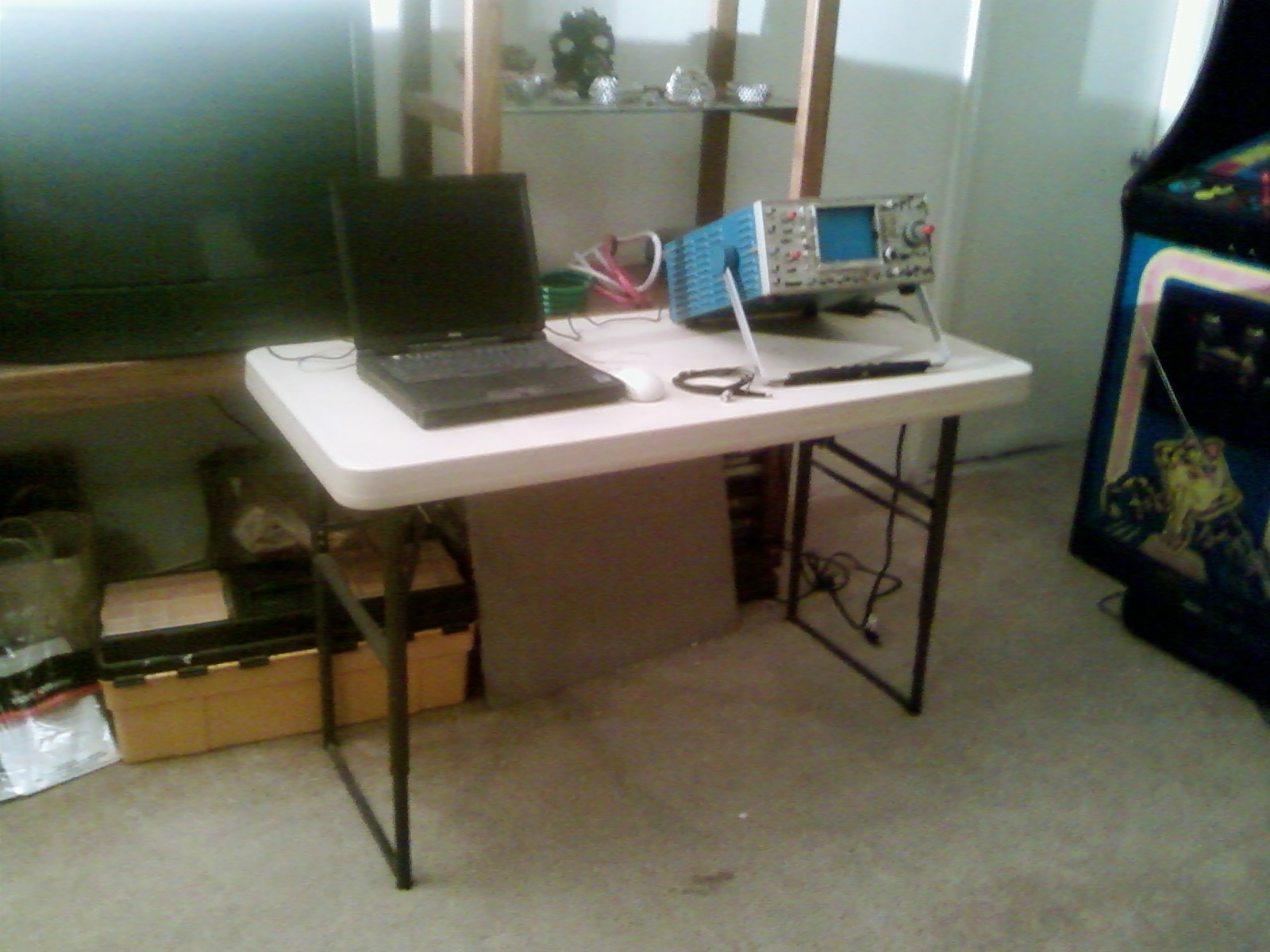

I'm setting up a guitar entertainment center based on ChucK. The photo below shows the very earlist beginnings of the setup. The computer is ten years old and the scope is probably from the 70's. Although giving up on electronics as a hobby, I feel compelled to just break out the guitar signal and put it on the scope. Who knows, maybe I'll get inspiration to do more with it. Anyway, just getting things set up and thought I'd share.
Just getting things in place...

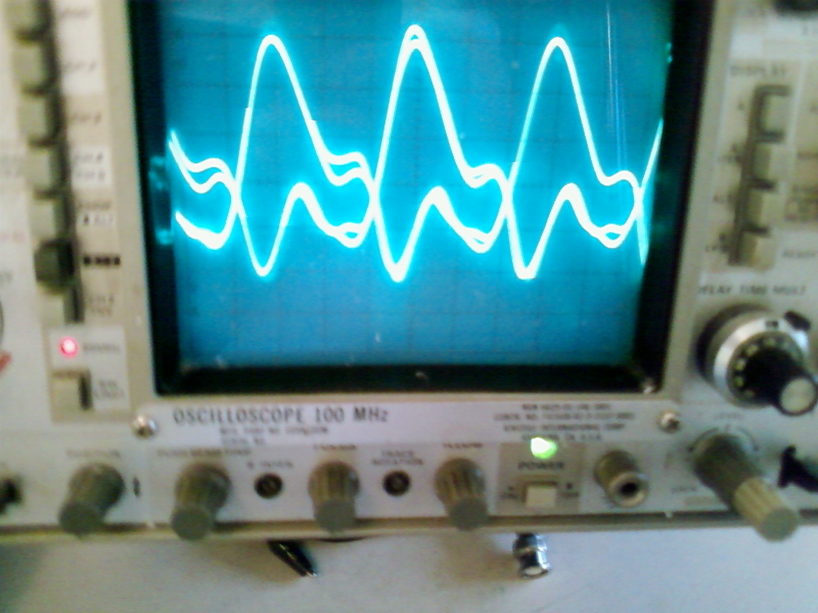

Well, I bought the guitar now and a great amp to go with it, both Fender products but low-end ones. I also got a 1/4 inch plug and took a cut-in-half BNC cable that I had, and connected them together to create a 1/4 inch to BNC adapter cable.
This allowed me to plug the head phones out jack from the amp into my beat up old scope. Yay, real guitar waveforms! The image below is from a plucked E string (the bass, or lower E string). You can see that there is a strong harmonic content. At other times during the E-string note, the harmonics are greater than the fundamental, making for some tough note-detection work.
Anyway, now I have toys to play with, woohoo!!!
Waveform of E string on my cheezy old scope
 Filesize:  291.47 KB
 Viewed:  488 Time(s)
