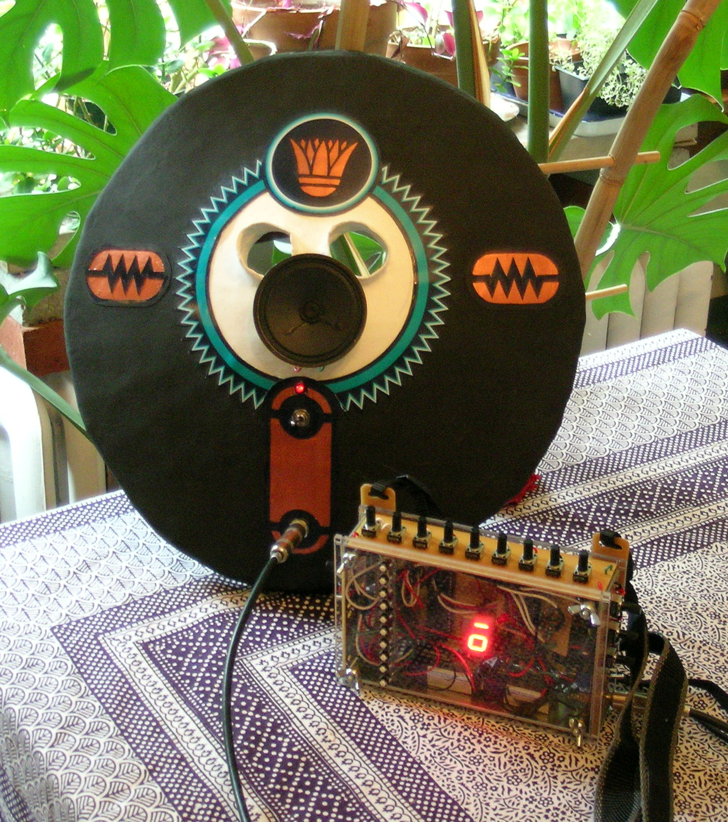

catweazle
Joined: Feb 25, 2008
Posts: 28
Location: germany
PostPosted: Fri Jun 20, 2008 3:51 am    Post subject: Reply with quote  Mark this post and the followings unread
R7 and C1 form a RC-lowpass filter to filter out the PWM frequency.
C2 (~0.1uF) filter DC contents (audio inputs don't like DC voltages)
The R8 (470k) limits the signal (on my test the output signal was a bit strong for my mixer. you don't need the R8 really.

PostPosted: Mon Jun 23, 2008 2:03 pm    Post subject: Reply with quote  Mark this post and the followings unread
hi oootini,
if you use a veroboard (stripe type board) then you have to
cut a lot more traces than using a Perfboard (with dots instead of stripes).
There are not much connections between to points, ok supply voltages...
Here is the minimal configuration (excluding display),
on the pic you see the first version of the picsynth, but the
2 additional switches and the led display are not really complex to attach.
Voltage regulator (+5V, 7805) is mounted at the case and
the remaining components (caps and protection
diode) are soldered "flying" directly to the supply-jack and the 7805.
The output filter (resistor and cap) are soldered directly to the output jack.
gtz
eric
 Filesize:  23.2 KB
 Viewed:  43279 Time(s)
