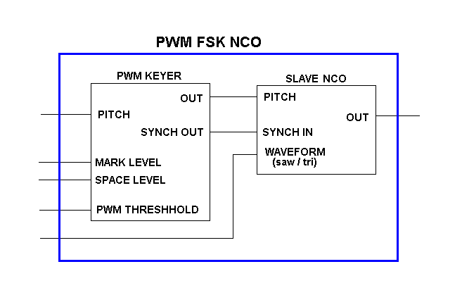

I have been playing around for the last week using FSK (frequency shift keying) as a synthesis method. I don't think I have ever seen anyone write about this method in public, so here goes.
It is a way of getting good control over two separate formants with only two oscillators.
The configuration is simple: a slave (sine) oscillator synced to a master (square) oscillator. The output is from the slave. The base frequency is set from by the master oscillator, and the formant frequency is determined by the frequency of the slave oscillator, as you would image.
How the FSK set up is unusual is that you add to the Fin of the slave a little of the square wave (adjusted so that it the "space" is always 0V). So during the mark part of the square wave, the sync oscillator is a higher frequency than the space period: the effect is that you get an extra formant. The frequency of this 2nd, higher formant is set by the amount of the square modulation from the master (if the mark is 1V signal, the 2nd formant will be 18ve higher, etc). The relative levels of the formants to each other are determined by the pulse width of the master.
(Obviously, if the master frequency is higher than the formant frequencies, you don't get this formant effect.)
What is quite interesting is that if you want to have fairly fixed formants, you don't need to feed in the keyboard CV, and even if you want variable formants you can do it with a very simple oscillator without high-end (expensive) tempco because the base frequency oscillator stability is entirely determined by the master oscillator: fluctuations in the slave will show up as minor tone changes which may indeed be pleasant.
It would be easy to build an FSK waveshaper: just a syncable LFO driven to audio rates at a minimum.
The kinds of tones that are available tend to be woodwind-ish and sparse, and thin and buzzy at the low end, but interesting. Changing the square to another waveshape stops the FSK effect and is useless for the formant effect. Selecting richer waveforms than the sine obviously makes more harmonics which can disguise the formant effect but can be interesting in their own right.
(To do this digitally, you have to clip the square wave rather than use a band-limited version.)
I have found what is quite useful is to use the FSK in conjunction with a BP filter (signal from the master VCO) also controlled by the formant1 CV and output +/_ with the slave osc. That allows a richer band of harmonics, with exact formant either being emphased as if you had some super Q going on, or cancelled out.

Here is a little graphic to show what FSK looks like.
An FSK triangle wave. The square underneath is the keyer and shifts the slave between two different frequencies, synching the slave at the beginning.

I apologize for being somewhat dense - I don't have a modular and haven't had a whole lot of analog synth experience other then a couple of FatMan synths that I've modified rather heavily.
I'm not understanding the concept of a "section"... ?? You say "two sections", are you referring to the mark and space states of the master?
I also don't understand what I see in the graphic... It appears that when the master's falling edge occurs, the slave is hard synched and at the same time, the slave shifts to it's lower frequency. It looks like the slave then spends only one full cycle at the lower frequency and then shifts back to the higher frequency before the rising edge of the master. I don't understand what makes the frequency shift back up to it's higher frequency. It seems like it's shifting to it's higher frequency before the master changes state. It also looks like there is no hard synch action on the rising edge of the master. I think this is what you are writing about in the first paragraph of your last reply - that the synching occurs only on the falling edge of the master? It looks mysterious what makes the slave return to it's higher frequency.
As I understand FSK from modem technology, the keyer or master can be at one of two voltages alternately (one for mark, the other for space). Those two voltages translate to the slave's two frequencies. - is that what is happening (ignoring synch for the moment) ? The problem I'm having is that it doesn't look like that when I view the graphic.
As I said, I apologize for being a little dense, I think you have more experience with analog synths than I do, so if you could bear with my questions, I'd appreciate it - I like what I heard in the demo sample and I'd like to try to emulate this in a digital world, but I can't unless I can fully understand what you're doing. Could you show a block diagram of the hookup or perhaps a schematic? I do read schematics...

PostPosted: Mon Jul 14, 2008 2:16 am    Post subject: Reply with quote  Mark this post and the followings unread
Yes, I am using "section" for mark or space/sweep, because it is possible have more than just two: I have been using a three comparator system to get four sections (and therefore four formants) for example.
For that diagram, yes the square has been shifted a cm to the right so you cannot see the reset relationship nicely. (Bloody SynthEdit scope...) Also the waveshapes there are all band-limited, so that makes the transitions less clear as well.
So yes the synch here occurs on the rising edge.
If you are doing a VC digital oscillator, FSK might be a good architecture, for example by having a digital master outputting the sections (frequency sequence) and the resynch signal into a very simple linear VCO. So analog signal and control path, but digital stability/accuracy and less need to worry about band-limiting signals. Such an oscillator could also be useful for driving some of the waveshaping chips (such as the Moog Polycom card or the CEM 3396.)
Rick Jelliffe

Thanks Rick. I think I understand now - but be prepared for more questions about the method Cool
I will be starting with the simplest case of 2 sections because I've already written code to do PWM, which is a simple width-adjustable pulse. Amplitude control is already there.
Implementing a multi-section randomly programmable in terms of section "voltage" should be fairly easy.
This will be a fully digital synth contained within an FPGA, all "voltages" will be represented digitally, initially at 48 bits.
Rolling Eyes I noticed the band limiting in the graphic, the pulse looks like it was filtered both forward and reverse. Thanks for explaining the scope program's quirk. I kinda figured something like that was going on,

Here's what I have for an NCO design. There will be two of these per voice. First cut, I may be able to add more waveforms.
FSK NCO block diagram. Both inner blocks are really each an NCO, but structured somewhat differently. The SYNCH out is a "pulse" that occurs on every state change.

Nice.
What is the PWM threshold? Is that the threshold for testing the phase of the accumulator?
