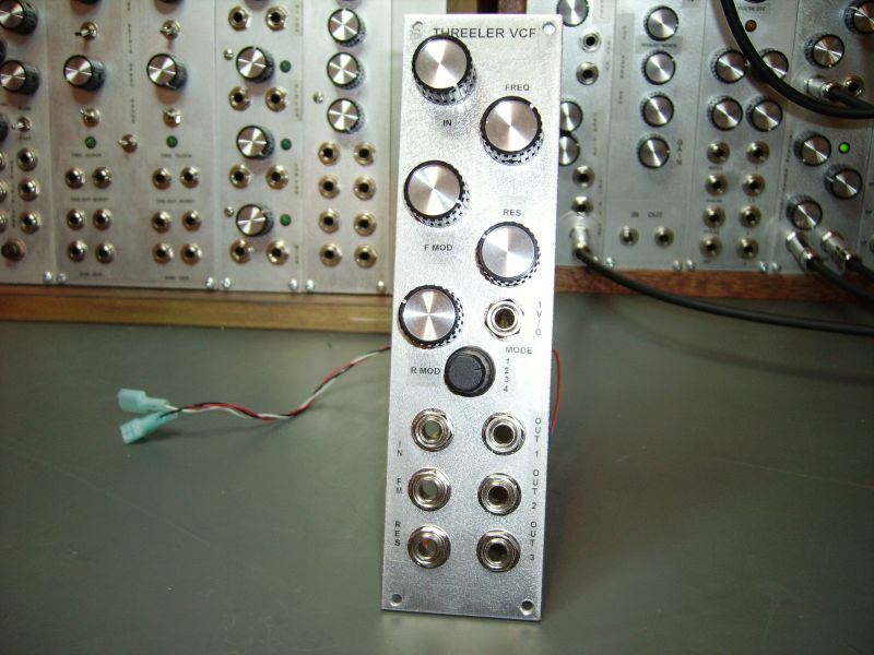

PostPosted: Sat Jun 21, 2008 9:06 pm    Post subject: Reply with quote  Mark this post and the followings unread
jnuaury wrote:
does anybody want to show off their front panel for this?
ive been really interested in this bad boy but i think i need to see how much front panel real estate it takes up
Such as it is - here's mine. Just fits on a 2 1/4 by 8 1/2 inch panel.
I left off the fine-tune for the frequency. May have been a bit crowded with it.
Just finished it tonight so have not played with it much yet - just a few tests to make sure all was good. It's quite an interesting/unusual filter....
props to Scott at Bridechamber for the parts kit and board. Everything was perfect.
Ian, it's a crazy/nifty filter thumleft - thanks for sharing it.
