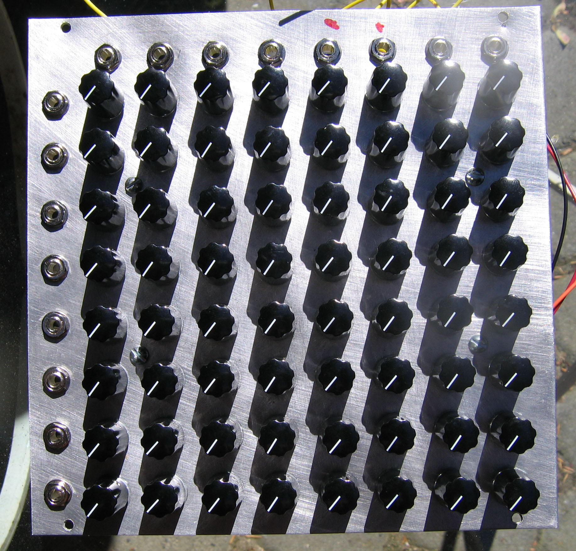

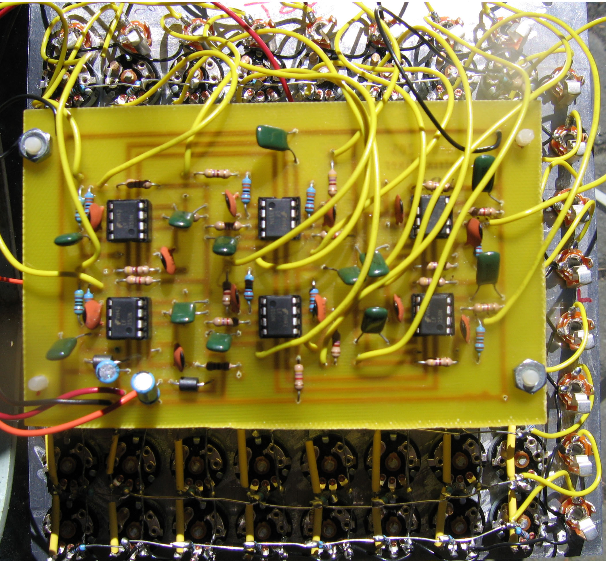

PostPosted: Sat Jun 28, 2008 12:46 pm    Post subject:  Photos Reply with quote  Mark this post and the followings unread
Here's a few pix: Front, back w/ pcb, back, and w/out pcb. PCB layout and samples will follow.

Posts: 24676
PostPosted: Sat Jun 28, 2008 1:03 pm    Post subject: Reply with quote  Mark this post and the followings unread
Laughing that's a nice bunch of wires for sure!

PostPosted: Mon Jun 30, 2008 2:01 pm    Post subject: Reply with quote  Mark this post and the followings unread
OK, and here's the PCB layout. As you can see it's nothing fancy, just 6 dual opamps configured as summing opamps. The Buchla 205 had 4 opamps for one side (left), 4 for the other (right), and another 4 for both channels (L&R). There was also an opamp for the monitor outputs, but I left that off.
