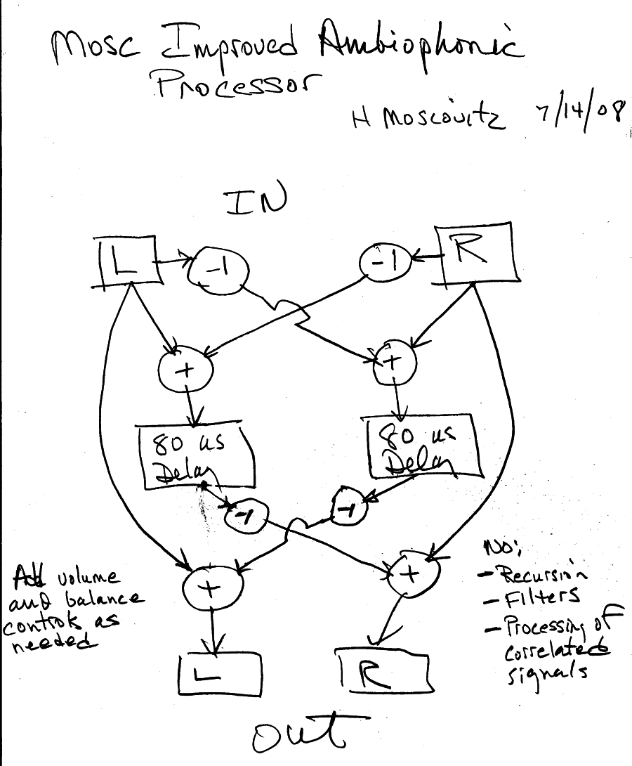

Here's an improved Ambiophonic processor. After much experimentation, this is the best algorithm I have tried. This one had no feedback or filters.
Don't forget, this is not for headphones. Speakers should be placed closely, about 20 degrees apart and listen directly on the center axis.
I have one problem with it. Whenever the audio stream changes (track change or volume change) the Chuck program (shell window or MiniAudicle) must be reselected. Anyone have any idea about that? BTW, the other ambiophonic processors written by inventor have that same problem.
July 12, 2008 - update:
, fixed bug. Don't multiply the delay signals by -0.5. Should be -1.0
July 24, 2008 - update, fixed error in the drawing. There must be inverters after the two delays. Embarassed
Oct 25, 2009 - update: This algorithm has been greatly enhanced and improved as a result of work with Robin Miller. The new AmbiophonicDSP, available for download at the electro-music.com store incorporated these improvements.

PostPosted: Wed Jul 09, 2008 8:09 am    Post subject: Reply with quote  Mark this post and the followings unread
Code:
// July 8, 2009
Now *that* is "strongly timed"!
:¬p

I can only guess at the solution. Perhaps one thing to try is using the command line version of ChucK? It has no GUI that needs to be selected, so maybe it will not have that problem. Sounds like a bug to me...
Bug squash
Joined: Oct 13, 2007
Posts: 6221
Audio files: 267
PostPosted: Sat Jul 12, 2008 10:04 am    Post subject: Reply with quote  Mark this post and the followings unread
I coded up a non-MIDI version of Howard's Ambiophonic Processor and put a class wrapper around it. This way it is easy to add it to any ChucK program. Enjoy!

I'm not sure what "reset glitch"? I took the liberty of doing a little cleanup so I could understand the signal chain. I'm fairly sure this version has the exact same signal chain. I still don't see any "reset". How does it glitch?
To be perfectly clear; this wasn't done because because I feel my style is "better", I just found the signal hard to trace and now I can. Sorry but I don't feel like moving speakers ATM.
Code:
// ambiophonic processor
// Improved phase cancelation using subtraction
// of the channels first tried by Howard Moscovitz,
// No filters, no feedback. I have found it sounds
// better this way
// July 8, 2009
// Howard Moscovitz
July 12, 2008
code cleanup by Kas mainly to clarify the signal chain
which I found hard to understand.
also ripped out a pair of gains that wasn't doing anything
and dito MIDI

Posts: 18319
Audio files: 235
PostPosted: Sat Jul 12, 2008 10:07 am    Post subject: Reply with quote  Mark this post and the followings unread
I tried the command line version as well as miniAudicle. I have to click on the Cygwin window that is running the shell as well. It feels like a bug.
Kassen
Oh, wait, that reset glitch. Hmmmm, I have no idea. What are you using to pipe audio into it? I use my soundcard's mixer for that kind of thing so stream interruptions should be undetectable at ChucK's end. I heard of similar glitches on some systems. Could be related to the way different soundcards interface with the audio system?
Kassen
Posts: 18319
Audio files: 235
PostPosted: Sat Jul 12, 2008 10:20 am    Post subject: Reply with quote  Mark this post and the followings unread
Kassen:
Thanks for the rewrite. I had take the parens out of lines 33 and 34 to get it to run. Something about RHS not mutable.
It seems to work as well as my version. Give it a try.
BTW, WTF, this version doesn't have a glitch when I change volume and what ever. Thanks. Laughing
Please explain... Laughing
I use Virtual Audio Cable. Maybe some changes I made to that config has fixed it. Anyway, now I'm free from streoe. Everying I listen too, includings mp3s on the site, will sound great. Woopie...
OOPS! Yes, My fault, I'll edit it. Those come from me carefully cutting and pasting to make sure I lost no data but clearly I should've lost some more :¬)
I just realised I have some spare small speakers I could try with later so I won't have to move the big ones.
That's quite weird. I'm saving some CPU thanks to removing two gains and the MIDI but that couldn't explain what you are seeing unless you CPU is old enough for that to matter. I find that hard to imagine. Quite strange.
Erm.... ? Erm.... If that's a real phenomenon we definitely need Ge himself to explain that because if my edit changed anything internal to the VM then that's beyond my knowledge of ChucK's workings.
love
I think the "pull through" model of Ugens may depend on calls from the sound device so a interruption there could possibly affect that? There are some comandline settings to change the way ChucK interfaces with those but that too is a bit beyond me. I don't know enough about the details of audio drivers... For me the defaults there are fine so I never bothered beyond trying the non-default once. I think the other setting was slightly more expensive on the CPU.
Anyway; end good all good. Maybe the VM simply likes putting as much of the audio graph as possible into as few lines as possible for clarity as well :¬)

PostPosted: Sat Jul 12, 2008 4:58 pm    Post subject: Reply with quote  Mark this post and the followings unread
Sorry, I just discovered a small error in my version which I just fixed.
-0.5 => L_delay.gain => R_delay.gain;
should read
-1 => L_delay.gain => R_delay.gain;
That's more effective.

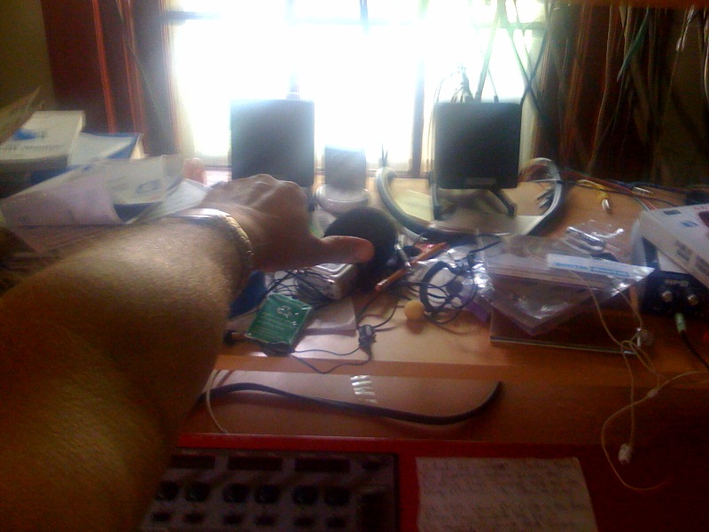

I wish I could make ChucK accept my iTunes output and process it ambiophonically, then send it to my eMac's speakers. They are close together and then all my tunes would be enhanced as well.
Although I must admit, the effect is rather lost on me, my ears are made of lead, heck I'm listening to rock music from my fender amp which is mono and positioned to my right hand side and it doesn't bother me a bit. Shows what an audiophile I am.
Well, to each his own. Maybe someday I'll splurge another $60 and have stereo Fender amps for listening. Heh. Love my new toys.
Posts: 6221
Audio files: 267
PostPosted: Sun Jul 13, 2008 10:17 am    Post subject: Reply with quote  Mark this post and the followings unread
Well, good news. I posted to the ChucK Users Group and received recommendation of Jack and SoundFlower for routing audio. Jack wouldn't run, quitting unexpectedly, but SoundFlower is working just fine!
So now I'm listening to my iTunes music through Howard's Ambiophonic Processor! The eMac's speakers are kinda close together which I gather is optimal for Ambiophonic processing, so that's good.
It does makes wispy sounds when a web page is loading but I can live with that. Also the Apple built-in audio volume controls no longer work but I can use the iTunes volume control I guess and then if I get tired of that I'll code up a MAUI volume slider for the Ambiophonic Processor. Yay, it works!
I think they are supposed to be aimed outwards as well though.

PostPosted: Sun Jul 13, 2008 1:39 pm    Post subject: Reply with quote  Mark this post and the followings unread
The speakers should not be pointed outward. Face foward in parallel.
The distance between the speakers should be approx 20 degrees. I use my fist/thumb to set the distance.
Normally I hold both fists with thumbs extended inwards as a built in angular measurement system. The picture below shows this with only one fist. The other is holding the camera. Laughing
Note: the speakers aren't against my fists, they are back on the table about 1 meter or so. They can be any distance back. The important thing is that they are close together and the angular displacement relative to you is about 20 degrees. It doesn't seem to be critical but some ambiophiles take pains to get is right, by sound.
You must be on the perpendicular axis to get the best balanced effect, but it works back all the way to the back of the room. for me.
 Filesize:  114.82 KB
 Viewed:  580 Time(s)

PostPosted: Sun Jul 13, 2008 3:15 pm    Post subject: Reply with quote  Mark this post and the followings unread
OK, then things are set up just about right, cool! Ahhh listening to "Take theLong Way Home" by Supertramp, dreamy ending... and Abiophonically enhanced!
