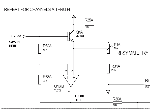

PostPosted: Sun Jul 27, 2008 5:06 am    Post subject: Reply with quote  Mark this post and the followings unread
From Scott Bernardi's Obesifier. http://home.comcast.net/~sbernardi/elec/og2/og3_obesifier.html
[Edit: Oops. Misread the subject as saw2triangle. Well, maybe it'll be of use to someone.]

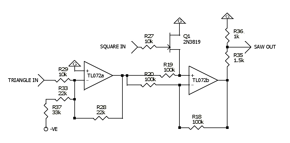

PostPosted: Sun Jul 27, 2008 6:31 am    Post subject: Reply with quote  Mark this post and the followings unread
Hello
I had the same problem with an LM13700 VCO
so I tried adapting the Roland 100m SAW to TRI
which in reverse seems to work.
It is designed for levels from the LM13700 VCO in the app notes
so for the TH VCO you might have to adjust the input/output values a bit.
NB +-15v
 Filesize:  83.17 KB
 Viewed:  1252 Time(s)

PostPosted: Sun Jul 27, 2008 11:12 am    Post subject: Reply with quote  Mark this post and the followings unread
thanks ryktnk..... that roland circuit looks a lot like a simplified version of the electro notes tri2saw shaper...
http://electronotes.netfirms.com/free.html
very last link... #129. this one works really well, but the roland looks much easier.

PostPosted: Sun Jul 27, 2008 1:19 pm    Post subject: Reply with quote  Mark this post and the followings unread
ah, yes
sorry it is from the Electronotes TZO, I was getting
confused.
