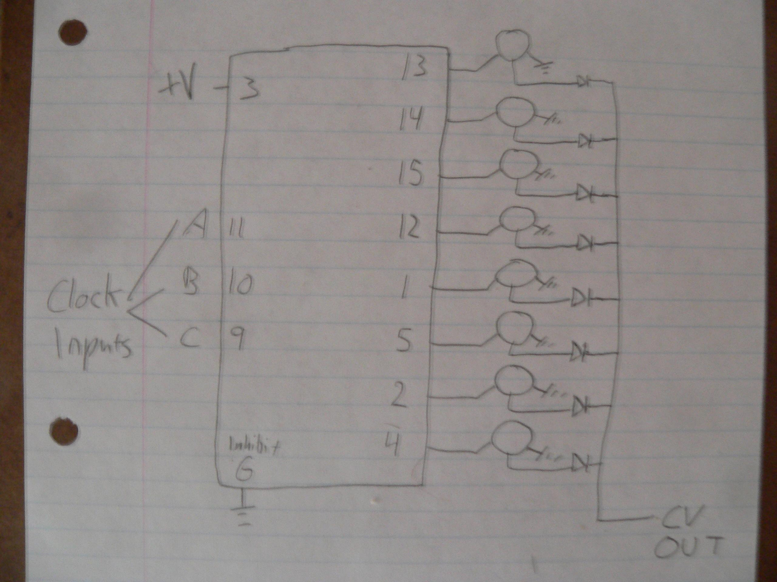

ok the setup is fairly similar to the baby10 schematic but i think its much more fun while being just as easy
first the 4051 is essentially a switch that toggles one connection between 8 options what makes it fun is that it receives a 3-bit binary number to know what option to connect to
a 3-bit binary number is 3 square waves
so if all of the square waves are low then you are at the first step and when all are high you are on the last step and with some high some low you get inbetweens
so it selects the options like this (zero would be the first step and seven would be the last step)
0 0 0 = 0
0 0 1 = 1
0 1 0 = 2
0 1 1 = 3
1 0 0 = 4
1 0 1 = 5
1 1 0 = 6
1 1 1 = 7
and sorry if things get confusing but they are actually wired a little different than i thought....
so i have 5 volts wired to the connection that gets switched between 8 channels
i have the output of each channel wired to the right leg of different 100k pots
the left leg of each pot is tied to ground and the middle leg of all pots are then tied together via diodes to what becomes the CV out
ill try to draw a diagram later
its really more simple than it may seem

PostPosted: Fri Jun 27, 2008 12:47 pm    Post subject: Reply with quote  Mark this post and the followings unread
ok if anyone has a link to free schematic software for mac, please send it my way
a few notes about the diagram...
i left out power and ground connections
the circles on the right side are of course pots and connected as if viewed from the back
the cv output will be a range from zero to whatever value you are using for power - i used a 5 volt supply this time so the cv out is 0-5 volts
the 3 clock inputs A, B, and C can be any lunetta signal
itd be best to run your other lunetta chips off the same supply voltage
but the CV out can of course go to normal synth modules running on their own supply
if you want this to function as a normal sequencer run an oscillator into A and run a division of 2 into B and division of 4 into C
getting creative with different divisions will give you different repeating patterns
running the oscillator into A and a division by 2 into B and a division by 8 into C will repeat the first 4 steps twice and then repeat the second 4 steps twice (1234-1234-5678-5678)
