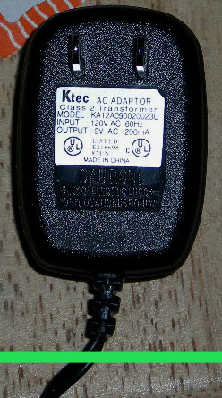

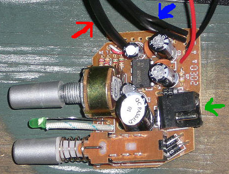

I was hoping to find a simple answer to my question but i don't think there is. Anyway, In the pictures below you will notice a speaker with amp attached and an ac power cord. In case it doesn't show up the power cord is labelled "AC Adapter, Class 2 Transformer, Input: 120 VAC 60Hz, Output: 9VAC 200mA"
At first I was hoping that I could simply cut the cord at the green line, strip the wires and attach a 9V battery but upon further inspection of the label it has an AC output. So the dc converter must be part of the amp is my guess. I don't much if anything at all about this stuff.
I want to make this amp battery powered so that I can put the speaker, amp, battery and my ipod in a container. I am trying to put together an electronic caller for my hunting adventures.
In the picture with speaker the Green arrow is the power cord attachment, the red arrow is the input from headphone jack and the blue arrow is the wires to second speaker.
What would I need to do to make this compatible and if there isn't a way to do it with whats here is there a small battery powered amp that I could easily attach a speaker or two and allow me to use my Ipod for input through 3.5mm jack? Thanks for any help you can offer.
