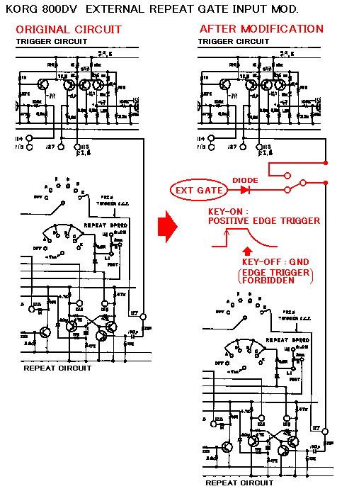

So, am I to presume a CV/Gate is a difficult addition to this synth, or has this thread just been missed by the right people?
I read somewhere the CV/Gate is Hz/V. If that means anything to anyone?
Here's some info I found about this synth in a Dutch website (there seems to be very little about this machine n the internet). I don't know Dutch language, but this post seems pretty clear:

Now, I'm wondering if I would need to make any extra modifications to have a usable CV/Gate I/O, or if I can simply tap directly into the circuit.

There was a Japanese webpage that had excellent instruction for adding CV and gate inputs to a Korg 800DV. Judging by your picture they are similar vintage and both V/hz. so I guess the circuitry will be about the same, but the connection points may differ.
I will post up the info from the original site, seeing it seems to have gone.
Actually, the VCF one is probably from somewhere else. Well done to those responsible!
If these prove useful, let me know, there are a few more

These are very helpful! I haven't yet started the project. I'm waiting to see if I get a good offer or trade, it seems a few people feel it's a sacrilege to modify something so rare. If no offers are made, I will go ahead with the mods in the near future, in the meantime, I'll collect as much data as possible and draw plans ready.
Again, thanks for this, and if you have more, I would love to see them!

I don't think the nord will be much use - isn't it just Midi( just an assumption)? you could get a midi2cv converter (try synhouse - midijack herz so good) but more expense.
it is not much use adding CV and gate inputs if you have no CV or gate sources.
Maybe just check out what the trimpots do, especially the ones on the filter board, if they seem to have a good effect, replace the trimpot with a pot mounted on the panel.
As for modding an old synth...my 800DV was battered, several broken switches and keys, so I had no qualms about removing the keyboard and giving it all the CV and gate inputs. If it was in good condition, i don't think i would want to mess with it.....well, an extra pot or switch on the front panel and a couple of CV/gate jacks on the back wouldn't hurt....

The G2 is a modular synth, so you can basically route a clock signal out of the audio bus, it works the same. I remember clocking the sample & hold of an SH101 with a G2 to keep it in time with the MIDI clock using this technique. However, sending voltages out of it may be a different story. I'll need to look at getting a Hz/V CV/Gate converter. I think my Jen SX1000 also uses Hz/V, something I'll look into, might be worth modding that too.
I already have, check the opening post. The Q (resonance) makes a lot of difference, as it is off as standard, I actually thought it was a non resonant filter until I went inside.
To be honest, I don't think it would hurt to add CV/Gate sockets to any synth with no external control, as it makes it ultimately more useable.
Thanks again for the latest diagrams, very helpful! Wink

1-hz/octave is rare. i wouldnt bother with a cv/gate mod, personally.
2-"its not currently usable in the studio"....just wanted to mention that synths like this are actually desirable studio instruments for some people. i have made very little recordings that didnt involve manually playing a keyboard.
3-if you do mods that involve inputs and outputs, you need to verify that you are doing it correctly. i believe that you will need to put a non-inverting buffer circuit in front of each input/output. noone in here has piped in yet on this, and there are people who understand this much better than i do.
if you want to mod it to make it more useable, thats great, i just would find it a bit unfortunate if it was treated like a disposable experiment piece, that's all....
