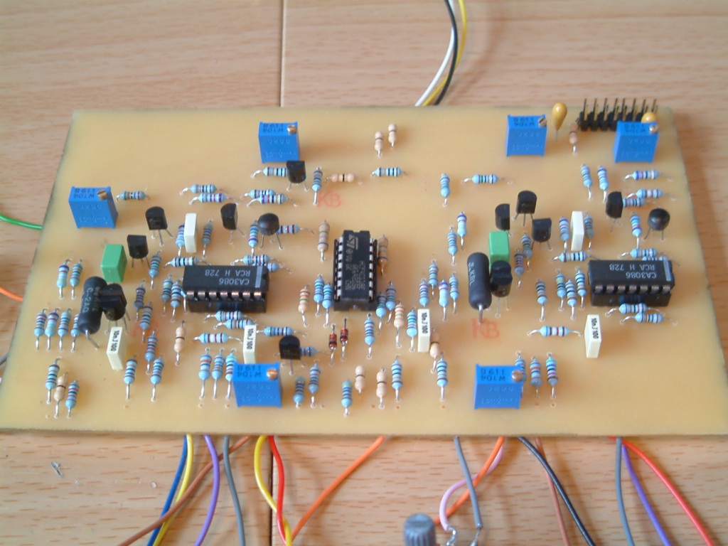

Sorry, me again...
I've just built a clone of the ARP Odyssey Oscillators (MkIII), including the Ring Mod - All works great, very pleased.
...except that the oscillators are locking together when I get close to unison.
I've heard of this problem before, especially when two Osc's are built onto one board, and particularly when (for example) a quad op-amp is shared by both osc's.
I've removed any flux off the PCB, it's very clean and I know the PSU is fine.
Unfortunately, I just don't know enough about the theory of electronics to know what I can do about this locking.
As I mentioned before, it's an exact copy of the Oscillator section of the PCB, and no component substitutions have been made, apart from using good quality WIMA 680pf timing caps instead of polystyrene and multiturn trimmers.
Any suggestions?

Congratulations, that's a cool project. I have an Odyssey and would like to build some modular Odyssey VCOs. They do have a unique sound.
It doesn't look like there are any decoupling capacitors around your opamp.

Ah, now then... this is the problem you see : )
There are no op-amps - there's a couple of 3086 tranny arrays, and a CD4011 which is used for the osc's integrators and the ring mod.
All the de-coupling (not that there's much... if any!!!) on the PCB is identical to the original. I can only presume that its all the switching that the discrete FET's are doing that's causing the lock-up.
Will have to have a long hard think, and see if I can somehow de-couple the FET's.

Ah, I see. I saw the 2 chips on the sides weren't op amps, I couldn't tell what the center chip was (and then you mentioned quad opamp...).
Hmmm. Can you just add an electrolytic and ceramic decoupling capacitor to each rail on the actual board? (never mind I see the tantalums)

You could still decouple the 4011 right?

Is the overall layout the same as the original?
The SEM uses a 3086 (IIRC, the Prodigy as well) for a pair on the same board, and they have both avoided the locking issue. I have no idea how. If someone can open an Odyssey and send you a photo of the oscillator section it might help.
Very nice board, by the way.

Yup, I copied the PCB foil from the service notes and just removed the S&H and LFO sections.

when i've encountered this problem it was often coming from using the same ground for both oscillators. and there's always the possibility that they are meant to do that and it's a "feature"...

I've decided to look at the power and ground rails to each osc, maybe try to separate them a bit better.
If that fails, I'll re-design the board so each of the 3 parts (2 oscs and the ring mod) has it's own supply.

Hey Bubblechamber - Thanks, that's what the problem was!
I thought I'd be clever and extend the ground trace to make it easier to wire up the pots... I didn't realise that I'd created a loop between the two oscillators.
Working really well now Very Happy

The ground trace went from the power connector to osc 1 then on to osc 2 and back to the power connector.
I just cut the ground track between the seperate Osc circuits, so each oscillator had it's own ground with a common point at the power connector, And following Urban's advice, I also added a decoupling cap across the 4011 to be on the safe side.

Peake wrote:
Is this the oscillator board? Looks like the heat-sunk pair have some level of matching/selection:
http://www.arpodyssey.com/odybfrnt.jpg
1.87K Tempco? And people chide me for liking the uA726 Wink
Thanks for the project!
NP. I almost used the pics from arpodyssey.com for the project (those pics are from the Mk1 white faced Oddy).
I think I could have made the board more compact using a double sided board, but I wanted to keep things simple, which is why I went for the MkII/III version.
Seriously though, don't bother matching the expo pair as it works fine without.
I must find a workaround for the tempco's as I've only got 2 left Shocked (but loads of 1k's)
Last time I used a 726 was in '77 - I tried to build the Formant... Hmm, 'nuff said! Smile
Andy.
