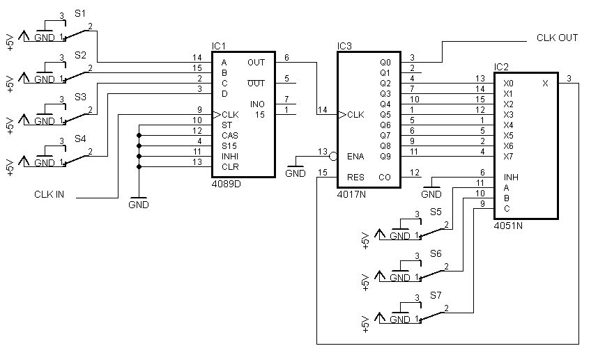

PostPosted: Sun Sep 14, 2008 2:49 am    Post subject: Reply with quote  Mark this post and the followings unread
Hi again
I used this as an opportunity to try making my first schematic...
Here is an example of multiplication by 1-15 and division by 2-9. S1-S4 decide multiplication factor and S5-S7 decide division factor.
with this you should be able to do most musical pitches except a minor second and a tritone.

loss1234
Joined: Jul 24, 2007
Posts: 1536
Location: nyc
PostPosted: Sun Sep 14, 2008 8:25 am    Post subject: Reply with quote  Mark this post and the followings unread
wow!!
this is like gold!
thanks so much.
what program did you use to make the schematic?

PostPosted: Sun Sep 14, 2008 8:34 am    Post subject: Reply with quote  Mark this post and the followings unread
let me ask
do the 4 switches on the 4051 use the same code as the switches on the 4089? (is it binary?)
thanks so much...i am sure in the lunetta spirit, all 8 switch points could also just be turned into jacks.
this is going to be heavy!

loss1234 wrote:
let me ask
Yes it is the same. On both 4051 and 4089 is A=1 B=2 C=4.
I would like to figure out a better way to select ratios than this but so far this has been good for experimenting.

PostPosted: Sun Sep 14, 2008 10:24 am    Post subject: help with mismatch clocks Reply with quote  Mark this post and the followings unread
Ok
i built it and i am having some problems.
I am powering it off of a 9v battery which is the closet thing i have to 5v right now.
does pin 7 on the 4051 need to be grounded too?
when i hook it up to my vco square waves (for the clock) some of my vco's or lfo's WILL NOT drive it and some of them will pass a tone through without allowing the switches to divide it.
i have a 9v battery powered clock i used and it worked ok though.
is this because one system is on a different VOLTAGE than the other?
do i need to put buffers before and after the unit?
does it need to be powered by a special kind of clock? (do i need to put the clock through an inverter first or something?)
when it DID work it was really cool. but its odd, on some of my modules (like my home-made negative slew which has an LED which flashes in time with the LFO) it not only did not work, it stopped the LED from working, which makes me think it was sucking current from my module.
scary.
so what do i need to do to get this working? power it from +/- 15volts?
this is going to be a really great module though.
we should design a press n peel pcb!
amazing
thanks so much

PostPosted: Sun Sep 14, 2008 11:02 am    Post subject: Reply with quote  Mark this post and the followings unread
well i stuck a 40106 in front of the clock in on the 4089 and that seemed to help a lot. i wonder though if there is some bounce from the toggles because sometimes when i make a switch, i get all this messed up sounding jitter.
but this is amazing. i am clocking it with my vco...i am putting one out of the vco through just a regular 4040 to get it to a lower octave...and mixing that with the output from this thing. making sure the vco is at a high frequency and then just messing with the switches (with a sample and hold coming into the cv of the vco)
and wow!
NOW CAN ANYONE HERE explain to me HOW THIS WORKS?
i know what all of these chips do ON THEIR OWN..but how is it working as a whole? why is the 4051 plugged into the reset of the 4017? and what is the 4051 doing?
this is just such a useful block-i need to make pcbs of this.
i can imagine making chords by having 2 or 3 of these going at once with the original vco.
wow.
thanks so much
Posts: 24672
PostPosted: Sun Sep 14, 2008 12:04 pm    Post subject: Reply with quote  Mark this post and the followings unread
The 4051 selects one of its lines x0 .. x7 and connects that one to the line x, which one it will be is determined by the switch combination 000 selects x0, 001 selects x1, etc. So what happens is that one selectable output of the 4017 will be connected to the reset input of itself. Now the 4017 shifts a signal from its q0 output to q1, then to q2 etc. on each incoming clock. and when you reset it it will start anew. So effectively the switches on the 4051 will determine the amount of pause, or silence, between the pulses coming out of the 4017's q0, making a controllable divider.
You will indeed get glitches due to contact bounce when you change the switches.
