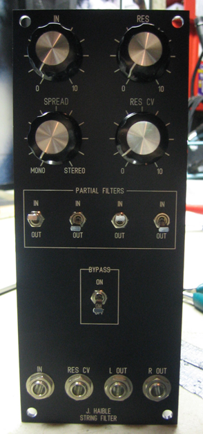

Here's my String Filter

wow is that Schaeffer ?

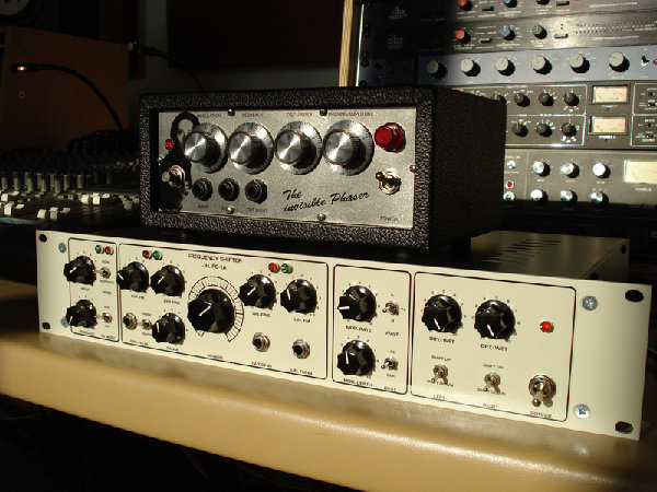

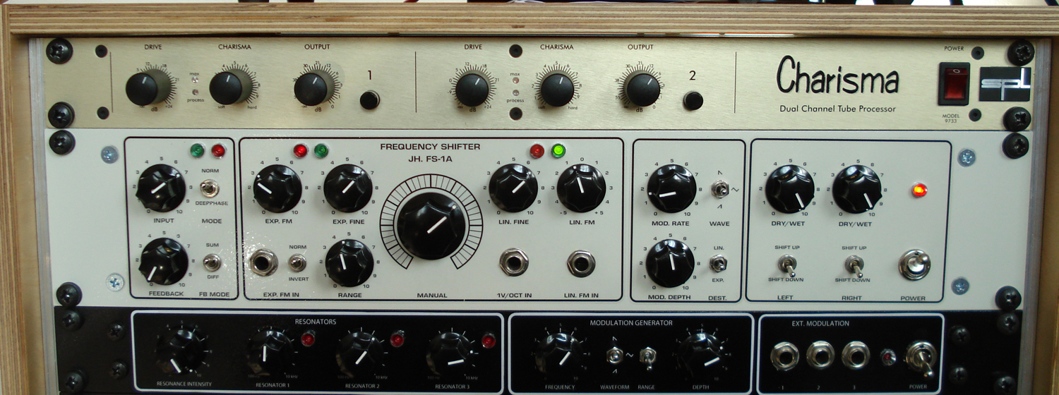

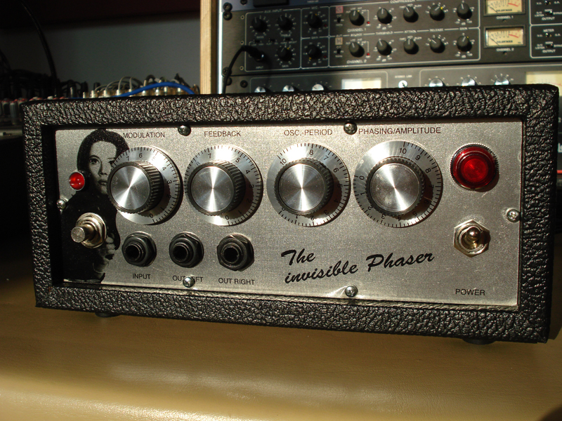

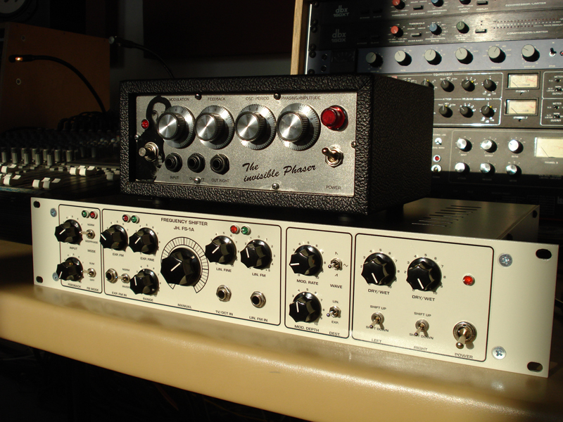

hi,
here's my krautrock phaser and frequency shifter. I've finished them a while ago, but didn't find the time to make pictures..
lars.

Just noticed the new pictures.
Beautiful stuff!
It makes me proud to see my boards behind frontpanels like these!

Yes Front Panel Express, I am in Canada and panels end up costing a fortune because FPE only ship UPS, so because of customs and the expensive UPS brokerage fee it seems for every order there is at least a $40-$50 brokerage fee on top of taxes.... Well worth it thou.

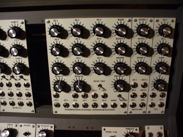

Here is my Interpolating Scanner wired as a Scanner and Tracking Generator. I bought a second board to make a Scanner Chorus / Vibrato.
I changed R81 to 51k like Jurgen mentioned to get the Scan CV to cover the entire range in 5V, at 5V I was getting between the 8th and 9th step, so a 47K worked for me...

It cannot hurt to make it even smaller (like, 24k) if you have an attenuator potentiometer for the CV. Then you can "overmodulate" the scan input - the "scan beam" rushing across channels 2 ... 8 and resting at 1 and 9 for a longer time. Of course the same can also be achieved without overmodulation, and a trapezoid LFO waveshape - there are many ways to get intersting effects. All I can say is: experiment, experiment. Of all the modules I've made, I'm sure this is the one that will allow for the most unexpected applications just by experimenting with it in unusual settings. Smile

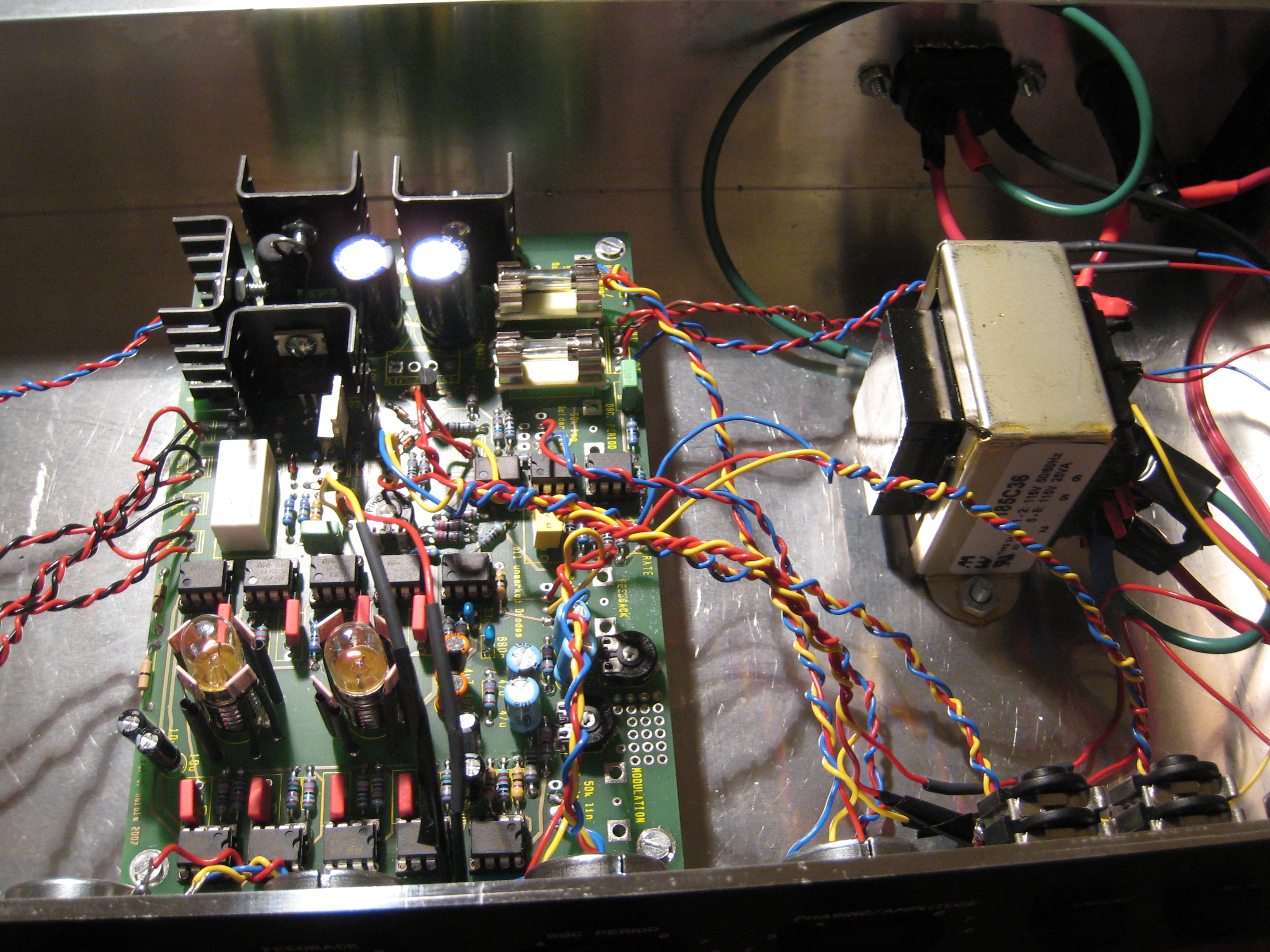

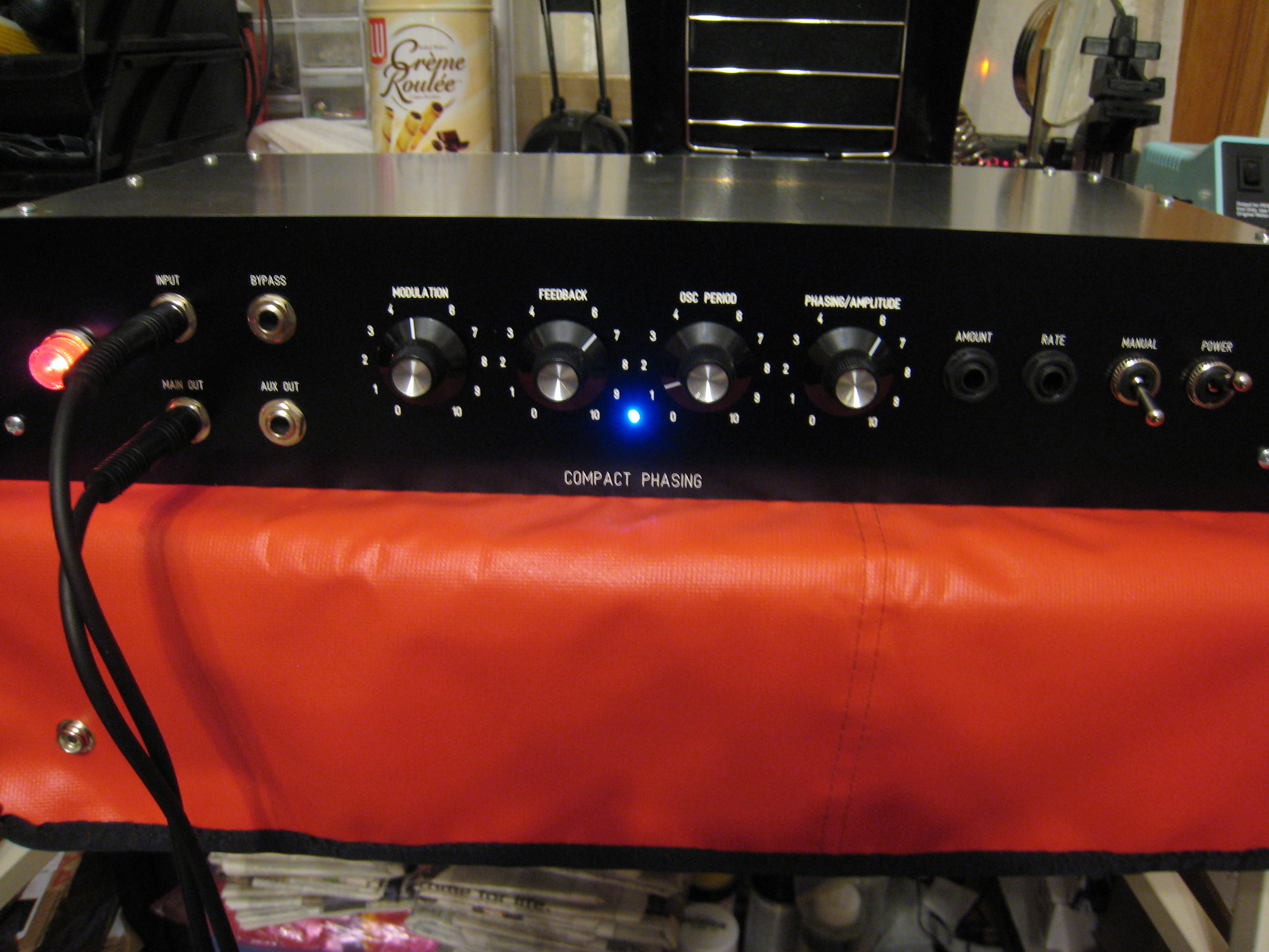

Finally got a proper panel for my Compact Phasing clone. Nothing original design-wise but I'm happy enough. This was my first build of this caliber and can't tell you, Juergen, how much I appreciate your patience. 6 months ago I'd never even picked up a soldering iron in my life.
Speaking of which, I'm *almost* too embarrassed to post a photo of the job I did on the board - my wiring jobs have gotten so much neater since building this.

Nice work, I like the skirted knobs. Smile

Paul, beautiful job man-- really makes me want to start working on my Compact Clone!

Thanks a lot guys.
Yeah, I really dig those knobs too. I have more I'm hoping to get to use one day (they're a little big so it needs to be a panel with extra room).

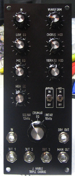

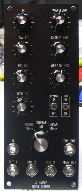

Here is my Triple Chorus.

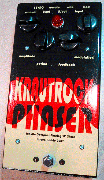

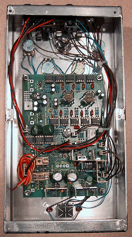

I just finished wrapping up my Krautrock Phaser (kompact klone).
Stompbox stylee. Very Happy

wow! Surprised
Top!

Beautiful!

Cool!
How did you do the painting??

Thanks! Cool
I used Inkscape to do the graphics on the computer. Printed the image out on an iron-on transfer, the kind for ironing on to dark colored t-shirts. Ironed it on to the face of the enclosure and gave it a few coats of clear lacquer. I've been doing my stompbox graphics this way for years and it seems to hold up really well.
