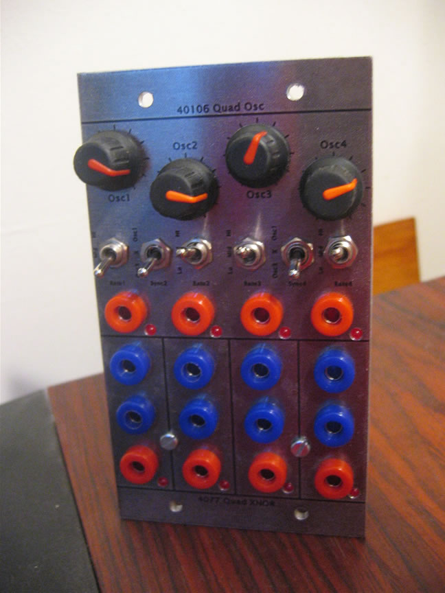

PostPosted: Thu Mar 13, 2008 11:01 am    Post subject: Reply with quote  Mark this post and the followings unread
Wow, sometimes things take a lot longer than expected... With the first mentions of Lunettas I really thought I'd get a few ideas built up quite quickly, but a month down the line and I've only just completed my first module. Cripes.. (well, actually, I built two of these modules at the same time)
This is a 40106 quad-oscillator bank (along the lines of the schematic at the top of this page) and a 4077 XNOR.
Each Osc has three ranges (low freq to audio) and Oscs 2 & 4 can be sync'd to either Osc1 or Osc3 - the Sync sound is damn cool, but I haven't really tested it yet in lower freq modes...
The Leds are all just low current 3mm hung straight off the outputs via 4k7 resistors..
All seems good so far! Need more modules!

Splendid! That looks great.

PostPosted: Fri Mar 14, 2008 11:42 am    Post subject: Reply with quote  Mark this post and the followings unread
bug-that module makes me want to switch to banana jacks....
are those the jacks from futurlec? and i think mouser carries those knobs but only with a blue line- i love the colors!!!
if you do more modules, please post...these are so inspirational. i got a bunch of cmos chips in the mail and i am currently trying to figure out how to get them set up in a useful scheme.
thanks

PostPosted: Mon Aug 11, 2008 6:55 am    Post subject: QUESTION ABOUT BUGS quad 40106 osc Reply with quote  Mark this post and the followings unread
hey can anyone explain to me the SYNC setup on the BUGBRAND quad osc?
it looks like the SYNC inputs into the OUTPUT of one of the inverters and the input of another through a diode (pins 4/5 and 10/9 of the 40106)
the jack confuses me a little...it connects to a sync source but since its two holes, does it mean that each hole connects to a different sync source?
(jacks like this on schematics always throw me a little)
i know some people have built this here so maybe someone can shed a little light on it. thanks a lot

PostPosted: Mon Aug 11, 2008 1:26 pm    Post subject: Reply with quote  Mark this post and the followings unread
i do know that the schematic at the top of the page and the one he used for the above modual are diferent. the above modual uses 2 spst's for the synch. he has the schem on his website for that one. i also get thrown by those weird schematic blocks. i think they are semi open ended, like it could be a switch or jack etc... i could be wrong though?

PostPosted: Mon Aug 11, 2008 2:51 pm    Post subject: Reply with quote  Mark this post and the followings unread
oh yeah, a switch i hadnt thought of that. but what good does connecting the one to the others OUTPUT do...i wonder.
yeah i WAS talking about the one on BUGS site not the one at the top..mainly because this is the oscillators thread

PostPosted: Thu Sep 11, 2008 8:56 pm    Post subject: Reply with quote  Mark this post and the followings unread
i actually breadboarded bugs schemtic today the synch is really cool!!! now to just find exactly what cap sizes to use....
