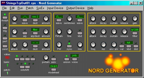

2 using Lars Borndahl's NordGen, which has also a nice graphic interface, because... Let face it! One of the most annoying things of the NordLead when studying its parameters the Panel knobs won't reveal anything! See attachment...
Download able at
http://nm-archives.electro-music.com/020_NordLead2/023_Miscellaneous/NordGenerator_Editor/
Wout
How NordGen looks...
 Filesize:  134.98 KB
 Viewed:  66887 Time(s)

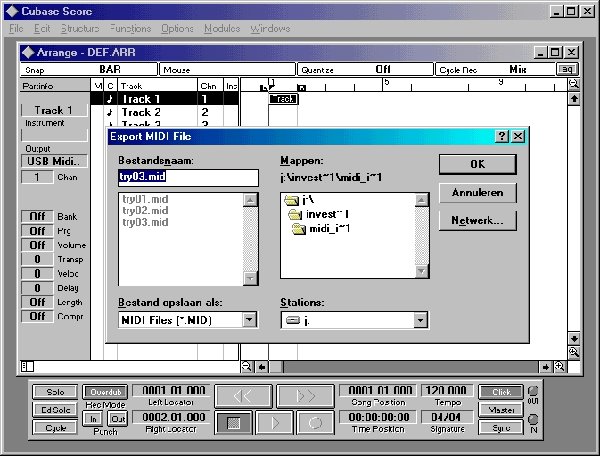

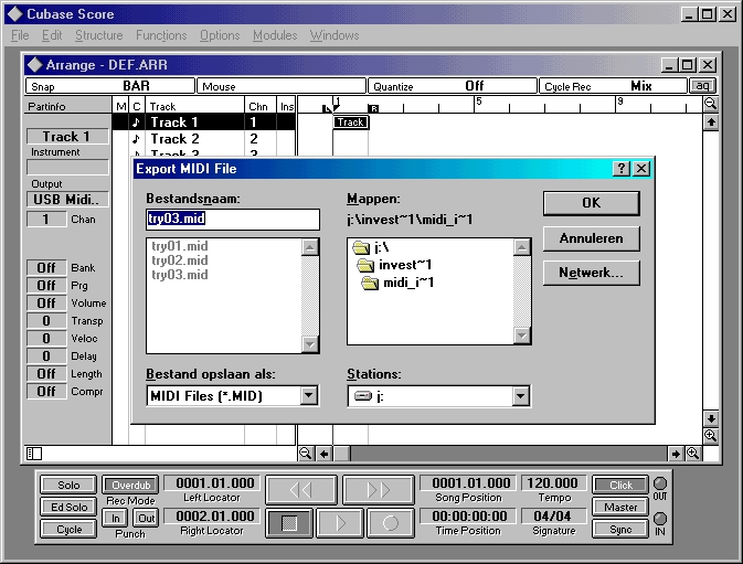

In most of my project I still use CuBase V1.10 Smile
After checking all the Midi cables and if the program reacts to any action send from the synth, I create a small track in which the SysEx data will be recorded. In CuBase there is a Midi Filter, in which SysEx is enabled by default, so this filtering has to be disabled when it will be used sending the data to the synth (or controlling if any data is recorded).
After starting the recording I press [Shift+Dump One] on the NordLead and 'Export' the file to a special folder, so it can be used in any Midi tool, like Logic, AbletonLive and NordGen, the later only accepting single Programs, no Performances.
Uploading using a sequencer is the other way around. 'Import' the Midi file and play it. When using single Programs or single Performances the file will be uploaded in the synths 'buffer' memory. When using a Bank it will replace the internal Bank in the synth, so make a BackUp first! This is done By recording [Shift+Dump All]. In the NordLead and NordLead2 this results in only recording the first 40 locations of the RAM. When [Shift+Velocity] is used the synth will dump all data from that particular card. In the NordLead2X things are organized different. I strongly advise not to try to find out, because I've lost my 40 RAM files many times, so I don't know the effect on the 2X!!! Shocked
These Midi files can be attached in any post on this forum.
Wout

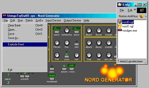

Subject description: NordGenerator as uploading and downloading tool
This shareware tool is only Windows based. Its best feature is the graphic interface: all the knobs are there. Pointing with the curser arrow on a knob reveals its value in the red figure in the down left corner. To copy this value (BTW Sending the whole Patch is easier Smile to the synth press [Shift+LFO1-Waveform] and turning the real knob shows the value in the LCD screen. But to see all parameter settings is a good thing of its own!
When receiving (NordGen SysEx has to be set to 'receive') a Program the Patch counter will rise to 2. It means there are two Programs loaded in the tool at that moment. Every new uploading in NordGen will increase that number. When saving all these Programs will be saved in that one and only file. After some time working this way I ended up creating files over 10 Mb big! And NordGen can't send Banks, only single Programs, BTW no Performances either: you'll have to use another way, like the sequencer method.
To avoid this strange behavior it's best to 'Explode' the 'Bank' in the folder in which NordGen is located (I always copy&paste the tool in the folder in the first place) The result of this explosion contains two files, one named nord0.ngf and the other one called nord1.ngf. The later one is the file you wanted to save, so delete nord0.ngf and rename the remaining file as you like. (I rename the suffix also from *.ngf into *.syx, because other Midi tools, like SendSysEx won't recognize *.ngf, which stands for NordGeneratorFile, of course)

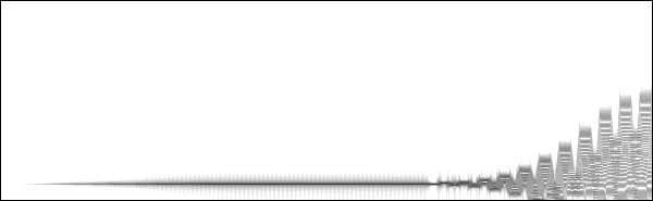

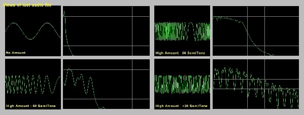

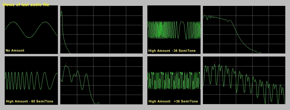

For those interested in some visualization, here are some pics of what is going on.
Wout
Sonogram of the second example... Looks like New York at sea :)
 Filesize:  21.6 KB
 Viewed:  66844 Time(s)
Scope and Spectrum analyse of the third example at four fixed points
 Filesize:  199.13 KB
 Viewed:  1214 Time(s)

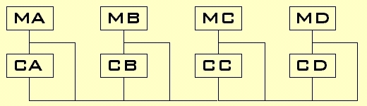

In the opening of this thread I suggested the NordLead is capable of performing as an 8 Operator FM synth. Knowing there are 2 Operators in each Program and there are 4 Slots, which means it looks like Yamaha's Algorithm 5 or 6 with an extra Modulator-Carrier and the ability to add the Modulator as a normal Oscillator. It looks like this...
Wout
Algorithm drawning of FM on the NordLead
 Filesize:  44.02 KB
 Viewed:  66842 Time(s)

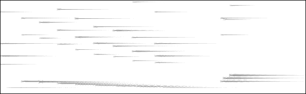

The next FM Performance is based on the infamous Carillon Sound of the Yamaha DX7 series. The extra modules are set as a RingModulator to produce more harmonics.
Wout
And the sonogram looks a carillon for sure... At least the birds who were frightened by it...
 Filesize:  25.56 KB
 Viewed:  66833 Time(s)
