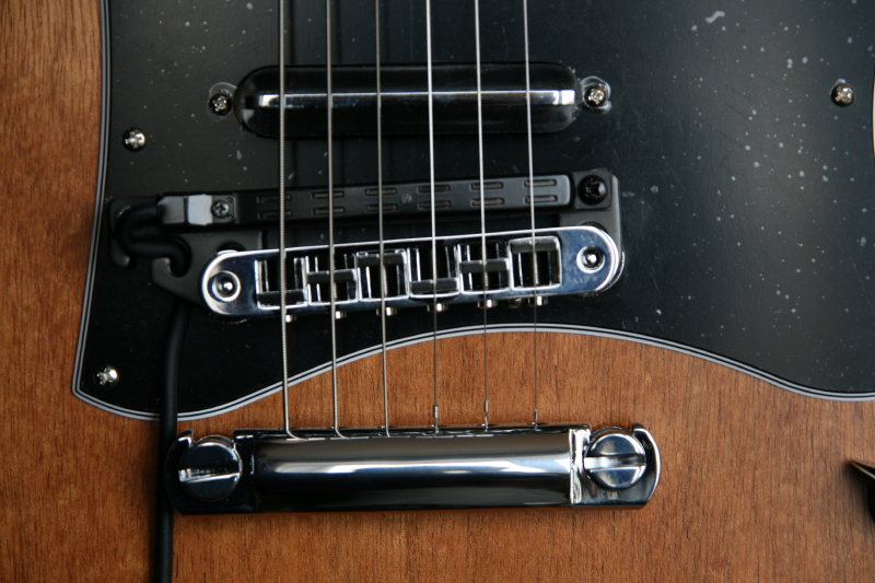

How do one correctly measure the distance from nut to bridge? The bridge has 6 individual saddles... I went for the Les Paul setting which is 628mm - that seem to be more or less the distance from the nut to the center of the bridge assembly on my Gibson SG Standard.
The "yoke" (new term for me, that) of the pickup seems to be too slightly small (i.e. too small radius on the pickup curvature) even when adjusted to it's flattest setting. I've managed to get the string to pickup distances within the range 1.2 - 0.8 mm. Is this good enough?
The sensitivity settings are all over the place, in the range 30 - 55, to acheive a uniform amplitude across the strings. I guess that's normal, being dependent on minute differences in pickup distance and string material.
I've attached a picture of the GK-3 as installed on the SG. As you can see, the pickup is at an angle - I had to do this to achieve the minimum distance of 10mm from pickup center to bridge saddle for the E4 string. Those distances now lie in the range 10 - 17 mm.

Center of bridge sounds fine to me. Or have a check on the Gibson site as they will probably show the distance.
I think as long as the strings are roughly 1mm from the pickup when you finger the highest fret you should be ok, some people have it set lower to avoid crosstalk between the strings.
I wouldn't worry about the sensitivity settings being all over the place my GK setup is also like this.

Thanks for the reassurances, Andy! It's new territory this, and I want to be sure that everything set up to perfection. I think the setup is OK now, for a first go at it. The GK-3 seems to track perfectly - I'm impressed with the performance.
