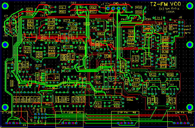

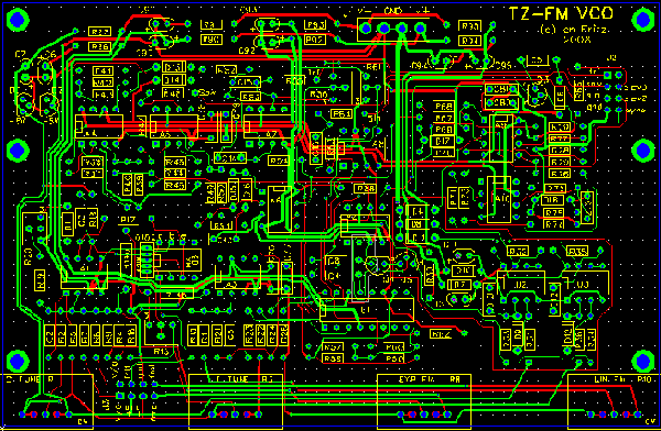

Just for a rough idea here's what the layout looks like.
The barebones PCBs will be here tomorrow, so I should be able to get the first build done over the weekend!
Ian

wow Cool i am really impressed with your progress with this project and it looks to be a really great one at that.
a little OT but i too have noticed this effect in the EN style TZVCO with my cheap japanese pair, when the base freq. and bias are low and you hit it with alot of FM all of a sudden, the base frequency slowly climbs a few cents.. i don't have any better dual PNP at the moment but it is nice to know the problem might be eliminated when i get one... i wonder how well the lm394 would fare in this regard?
thanks for the hard work, congratulations on your new project!

Jeez, man! Ian, you're amazing! I can't wait for this to hit the shelves! I'll definitely be in for at least 4! Once I get those I'm gonna get started on my 'prepatched' modular monster!
Wow!
