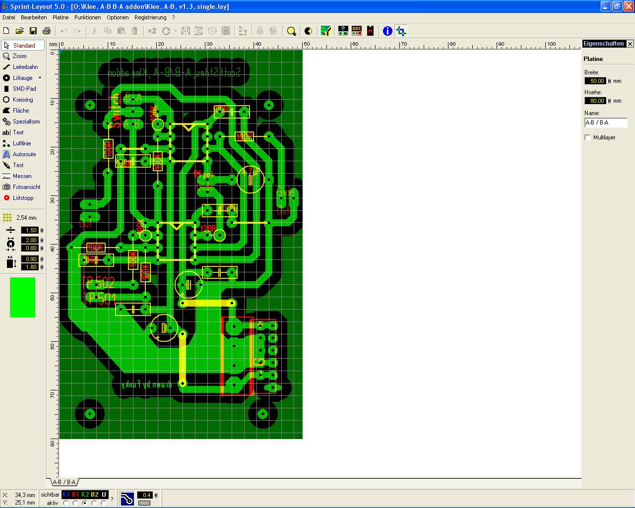

i have drawn a small PCB for Scott Stites A-B/B-A circuit for the Klee.
My Layout is untested. Please ckeck it first by your own.
It is drawn in Abacom Sprint Layout and you will need the free Viewersoftware: ( on the Bottom )
http://www.abacom-online.de/uk/html/sprint-layout.html
It has Motm, dotcom and doepfer powerconnectors.
The Power decouplingparts are not labeled.
the pros seem to prefer Ferrit Beads + 10µF electrolytic + 100NF on each rail.
Its prepared for this
If you find errors let me know. If it seems correct to you, please make a short post here.
the zipfile contains a single PCB = 50x80mm, and a quad = 160x100mm.
It is the simple Version with one Glide and A-B and B-A on a switch.
Not shure if i will draw the bigger version with two Glidesections.
funky
Scotts Schematic:
http://electro-music.com/forum/phpbb-files/pimped_klee_ab_424.png

please ask for part or buildquestions in the Klee/Scott Stites Forum ( should be renamed IMO ).
http://electro-music.com/forum/forum-155.html
my opinion about this Section is that threads should be short.
No unnecessary bubbling.
Open threads Regarding the builds or unclearitys in dhe DIY section or related subforas.
Please post here just the crosslinks or short notifications about errors or succesful builds,
thanks
