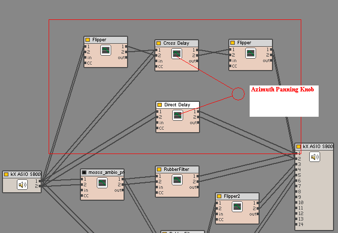

durwood
Joined: Apr 25, 2008
Posts: 30
Location: Chicagoland
PostPosted: Thu Dec 11, 2008 7:38 am    Post subject: Reply with quote  Mark this post and the followings unread
Ok moving on, sorry for more long text to read.
Typical panning knobs in stereo are not totally correct since our hearing relies mostly on Time diffences <1.5Khz. When you attempt to use a typical amplitude panner for ambiophonics, it doesn't work right since width will be lost and you will only be albe to pan +/-15 deg.
The problem is that by using amplitude you kill off the cancelation that is allowing you to have width, so it locks the image to whatever side you pan it to. This is the same problem with pan-pot stereo as well IMO, but not as bad because the speakers are at least spaced out more so it is less noticeable. For closely spaced stereo dipole/ambiophonic setups, this is noticed even more. The image should be allowed to move beyond the speaker, otherwise you end up with opposite effect you should get by panning and end up with a mono source trapped at the speaker right? Not good IMO.
I suggested this in mosc's ambiophonic VST thread, and decided to try a quick experiment to see if this would work by adding another delay on the direct signal. If you have two sources + two ears, you have 4 paths. In order to truly pan by azimuth angle, you have to compensate for all 4 paths/delays. See my attached diagram.
Rough Examples:
Centered
Cross Delay L=R=60us
Direct Delay L=R=0s
Panned Left (ex. 20us change)
Cross Delay L=80us
Cross Delay R=40us
Direct Delay L=20us
Direct Delay R=-20us
Panned Right (ex 20us change)
Cross Delay L=40us
Cross Delay R=80us
Cross Delay L=-20us
Cross Delay R=20us
You can't have a negative delay, so you would have to add/pad additional delay to allow for maximum panning so add an additional 60-80us to all signals. I used a generic 20us value for my examples, but that is not totally correct. Maybe later I will try to work out the real math.
Also, there would have to be some type of gain/amplitude adjustment that gradually comes in towards the higher frequencies based on ITD to ILD switch over. Ideally, you would tie this to one knob that adjusted all parameters at once-I call it an "azimuth panning knob" as that makes the most sense to me.
I can test it by manually setting the values just like above and it seems to work, but I cannot test this variably. Does this make any sense? Is it possible to make a plugin that does this? There is an ambisonic VST that does something similar to this for surround that is a rotate/tumble/tilt that works kind of similar to this on the York website.
I'm attaching my crude idea minus amplitude/gain compensation. It's basically mosc's MAP + additional delay block to allow time correct panning. Can this be made into a VST of sorts?
 Filesize:  14.33 KB
 Viewed:  947 Time(s)
bachus
Joined: Feb 29, 2004
Posts: 2922
PostPosted: Thu Dec 11, 2008 8:42 am    Post subject: Reply with quote  Mark this post and the followings unread
This is kind of tangential but the relative importance of time delay vs. HRTFs is not clear to me. Do you have any links to empirical or other evidence/studies for this.
thanks
durwood
Posts: 30
PostPosted: Thu Dec 11, 2008 10:19 am    Post subject: Reply with quote  Mark this post and the followings unread
Are you asking if I have come across a study that indicates ITD is the only important factor? No, this I have not. ITD and ILD are both important parts of HRTF's so yes, HRTF is better way to describe it since it covers more bases. I'm suggesting for horizontal azimuth panning, ITD is important I didn't mean for my statement to be so general.
The time/intensity trading is a gradual thing but if we generalized it and said which are more dominant, for most of the information available according to Raleigh's duplex theory.
  • Frequencies less than 700hz - ITD
  • 700-1500 ITD+ILD (Although ITD is still more dominant)
  • Frequencies greater than 1500hz starts to become ILD dominant
Of further note, my understanding of ILD for us is mainly used for elevation.
Is that what you are asking?
In ambiophonics where we have two closely spaced speakers, a panning device only based on level adjustment is going to cause hard left panned material to only reside at the left speaker (5-10deg), and hard panned right material will reside at the right speaker (5-10deg) because we won't have the cross-cancelation to "throw" the source out of bounds. My experimenting with my crude panning concept above seems to prove this to me unless I am doing something grossly wrong.
I'm trying to figure out how you can do two things
1) Rotate or pan a virtual image or source around a head/sphere using ambiophonics
or
2) "Shift" the entire stage left or right using ambiophonics.

Also, we are completely neglecting the effects of the room itself which have a huge impact on how successful any of this is. With ambiophonics the speakers are more centrally located and farther away from side walls that can ruin stage width. In stereo the speakers are farther apart, and if proper steps are not taken to minimize side wall reflections or at least delay them enough, then the width will suffer.
