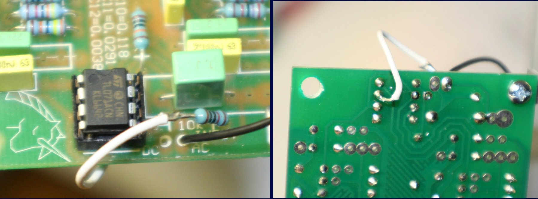

I've started playing around with the CGS45 Dome Filter PCBs, and found one small error. The 10k input resistor is supposed to connect to the "+" input of the TL071. Instead, it's connected to the "-" input (the output and negative feedback trace) and the "+" input is unconnected. I de-soldered the 10k resistor and used a jumper wire to the "+" input. See pic below.

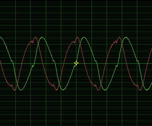

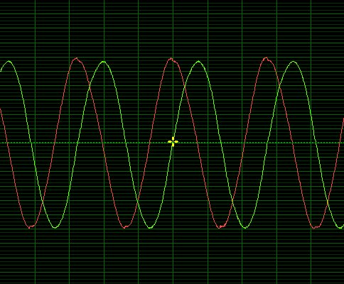

Here's a couple of scope shots of the CGS45 in action. The results are pretty constant across the audio range. The sine looks pretty good, the triangle is a bit sketchy. Square and sawtooth waves are even more so. I haven't checked the output of the dome filter in my FS-1, but I'm sure its the same. I used polyester caps for the 2 biggest caps: the 100nF C1 (29400 uSec = 29.4 mSec) and the 22nF C7 (8470 uSec = 8.47 mSec). I couldn't source polystyrene caps that big. I ordered some polypropylene caps for these 2 values. When I get them I'll see if it makes a difference. This is only a 6 stage version - Jurgen's 12 stage version may give better results. Seems to be good enough for a frequency shifter though Very Happy

That messed up input is a known fault on the first run of the PCBs. Phase shifting of complex wave shapes such as square waves does mess up how they appear on the CRO, but as our hearing is phase insensitive, it does not matter.
