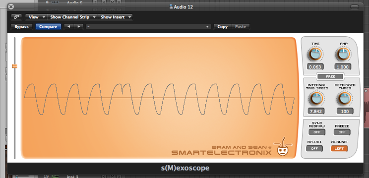

aerogramma
Joined: Feb 27, 2008
Posts: 156
PostPosted: Thu Oct 23, 2008 6:09 am    Post subject: Reply with quote  Mark this post and the followings unread
RF wrote:
Thanks for the clip! It's great to hear what you are up to.
Isn't that Mankato a nice filter?
You mention trying to get sine waves - how are you going about trying that? What sort of sucess are you having?
bruce
the mankato is not only nice, is superb... lots of character and 'interpolating' capabilities... sound really organic and the boards and docs are of great quality - magsmoke.com sells them
i started a thread a while ago on getting a sine from a cmos
http://electro-music.com/forum/topic-29403.html
in the example i posted here, i believe the difference was made by the capacitor values applied on the osc input, in this case 0.47 uf smoothing out the saws ehheeh
here's a pic of the waveform
Wink
 Filesize:  152.25 KB
 Viewed:  591 Time(s)
