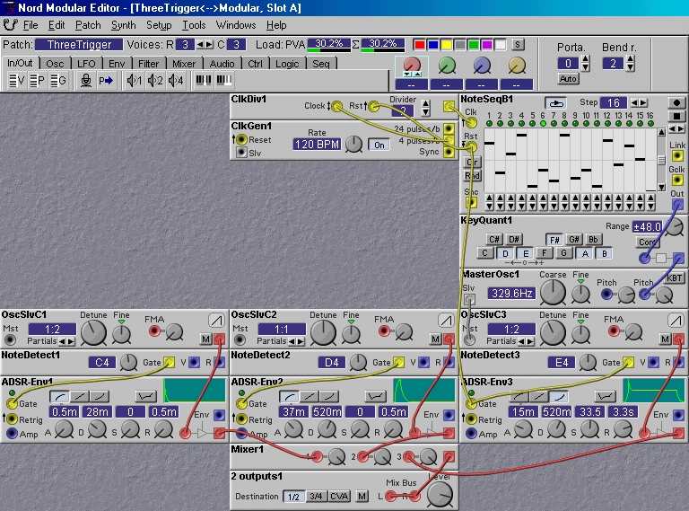

I am considering getting a second hand micro modular, but i need it for a very specific purpose and i'm not sure if the micro version will do. hopefully someone here can help me out.
I basically need to trigger a synth with my drum triggers and have three separate sounds for kick, snare, drumpad.. does anyone know if this is possible with the micromodular.. i know this is possible with the original and rack version, as it can play 4 patches at the same time, but as the individual sounds only need to be made with one oscillator each, no effects (just lfo and basic sequencer), was thinking it could maybe be done within one patch...
put in another way, could the micro could run three separate oscillators triggered by three separate notes, eg. note c plays osc1, note d plays osc2, note e plays osc3? and is it possible to put a sequencer on one oscillator, but not the others?
If anyone can help me with this that would be great, as I desperately need to get a backup solution for an old quite unstable synth for upcoming gigs.

tomtakestooth wrote:
... put in another way, could the micro could run three separate oscillators triggered by three separate notes, eg. note c plays osc1, note d plays osc2, note e plays osc3? and is it possible to put a sequencer on one oscillator, but not the others?
In one word: YES! Just use the NoteDetector!
I'll come up with an example.
Wout

PostPosted: Wed Jan 07, 2009 1:35 pm    Post subject: Reply with quote  Mark this post and the followings unread
An example, less then 33%, so three voices possible on the Micro, otherwise a new note will silence the other voice.
The Master module is for controlling the slaves by the Sequencer. (Don't forget to disable the KeyBoard control)
Wout

PostPosted: Wed Jan 07, 2009 1:58 pm    Post subject: Reply with quote  Mark this post and the followings unread
wow! thanks so much... just tried it out in the modular demo on my pc, and you've pretty much made my setup for me! thanks so much. Just to bother you with one more question, as you seem to be in the know. The patch you made has the sequencer going at a set speed.. how would i go about making it go to the next step every time I hit the note? is it complicated?

PostPosted: Wed Jan 07, 2009 2:44 pm    Post subject: Reply with quote  Mark this post and the followings unread
Just connect the Clock Input of the Sequencer with the Logic Out of the NoteDetector3 and forget about the Clock and the Divider modules.
Every hit on the E4 key will result in one step in the Sequencer.
