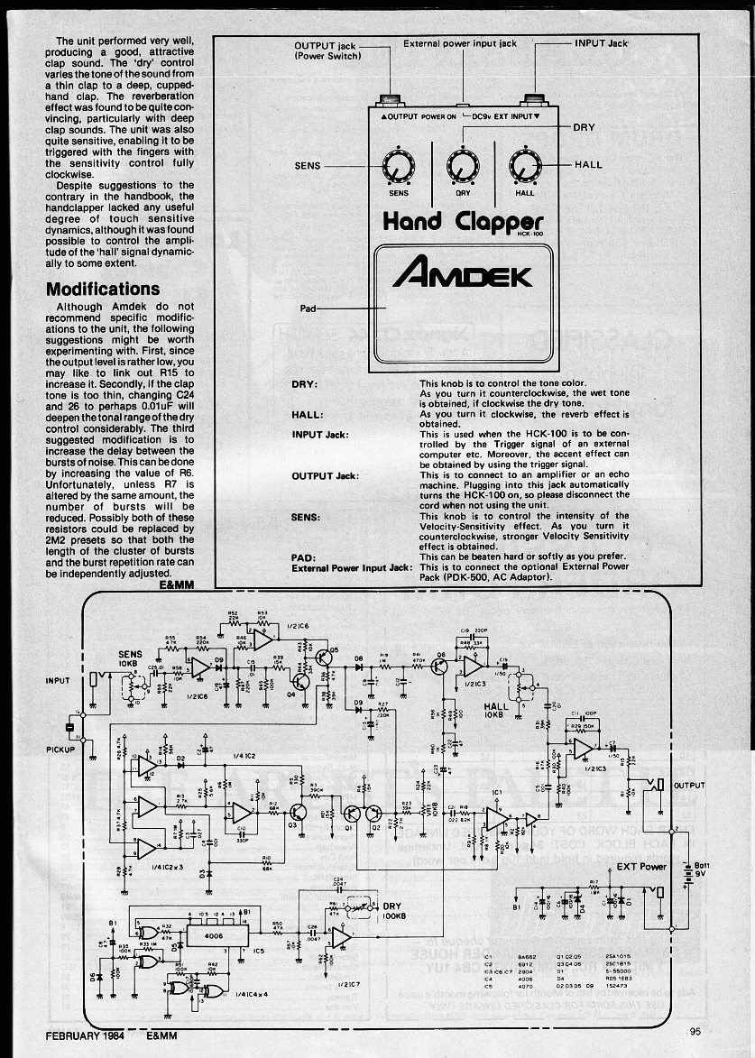

This is a pretty cool little Hand Clap device that I've had for a while--however, it suffers one major drawback-- there's no way to vary the pitch of the clap sound. To me, it's pitched a bit high, I like really low slowed down sounding claps.
So, i'd like to figure out where (if?) I could insert a variable resistor to give me a little pitch range. But I can't find a (free)schematic for this thing.
Does anyone know this device and/or have a schematic for it?

Sorry don't have these schematics, but this pedal is well known because it use the BA662 I searched when I built my 303 clone.
I think, but can't be 100% affirmative, that's the same circuit as the 808 who use this OTA too. I built a TR808 clap clone, and the tune mod is very simple.
As you said, You should find the noise source connected to BA662 input, and search for a resistor/capacitors Twin-T network who filter the noise sound, and replace the resistor by a pot to have a variable filtering.
You'll had to find the same R333 resistor than in these schematics and replace it for a 22K (Log?) pot.

Thanks, I'll take a look at it again. I have this 808 schematic already, but I wasn't sure how close it would be to the HC-2.
I'll try to scan/photo the PCB and post.

it seems this is the diy kit version of the Boss HC-2
http://filters.muziq.be/model/amdek/hck100
at least the controls look the same.

Cool andrew ! If hc2 use the same component values, the cutoff frequency of the bandpass filter next to the noise generator is about 970-1700 hz depending of dry setting
Eric if you feel the dry setting cut too high, you may change the 2 caps values to shift down the cutoff frequency.
Does the dry setting actually act as a pitch knob ?
Thanks, I definitely give this a try. But, do you think there is a way to get a variable pitch?
Edit:
I now see on the Amdek document where is says changing these caps will increase the "Dry" range. Great! This is the best forum ever.

the amdek is exactly the same as the boss clapper, the amdek was sold as a diy-kit
I made the e&mm scan and posted it to matrixsynth some years ago,
not very high resolution, but if anyone needs that I can make a better scan....

a better scan (c:
