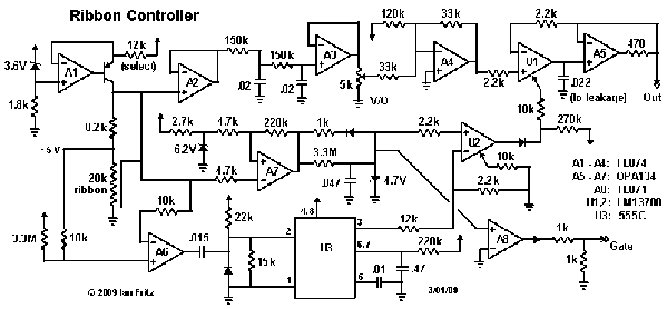

So ... after playing around with a 500 mm Softpot for a few weeks I've discovered that I'm probably not going to be able to develop any virtuostic technique with it. I did find, however, that I really enjoy using it with a breath controller to get all the slips and slides that are not possible with my more traditional wind controllers. So I'm going to emphasize working with a fairly bare-bones controller operating as a kind of sliding flute. But of course keeping in mind that the usual more advanced features can easily be added at any time.
The attached schematic shows the current version of the electronics. I've tweaked this up fairly carefully, so I don't think there will be any changes in the core circuitry. It works quite reliably, although the Softpot seems to take an awful lot of pressure to operate. This leads to a bit of pitch shift due to the "squish factor" on finger-up. But it's pretty easy to compensate for this with a bit of a roll of the finger as it comes off the ribbon. Of course this doesn't matter, if the CV hold on finger-up is not used, i.e., if the VCO gets gated off. (We see a very successful unit here using that approach.)
OK, here's the geeky stuff about how it works.
A1 and associated components form a standard current source that drives about 1/4 mA into the ribbon. The CV picked off from the ribbon's touch point is buffered by A2, then lagged, scaled for 1V / Oct (high-note priority) and presented to the input of the S/H circuit built around U1 and A5. The purpose of the S/H (actually operating as a track-and-hold) is to grab and maintain the last CV produced before finger-up. The S/H itself is a feedback design employing an OTA switched current source and a FET opamp buffer. Droop is about 2 mV / sec using a 0.022 uF polypropylene storage cap.
So that's the simple part. The rest of the core circuitry is for turning the S/H on and off, which is the trickier part. This is accomplished with two separate circuits.
The crucial consideration here is the method used to detect the finger up/down transitions. In previous work, the method used was to pull the ribbon's contact strip to a power supply rail with a large resistor. This resistor must be large (>2M) to avoid loading the signal from the ribbon. For the Softpot, this method is unsuitable. The reason is that the Softpot has a large capacitance (280 pF), which causes the finger up/down signal to be delayed by a significant time interval, making it imposssible to capture the last voltage prior to finger-up before it decays significantly.
The solution to this problem is simple -- just use the usual method of detecting current in a circuit, which is to add a series resistor in the current path and measure the voltage drop across it. In the schematic, this resistor is the 8.2 k unit drawn above the ribbon. The finger up/down transition causes a 2 V change in the voltage across this resistor. This change is rapid, because there is no large resistance in the circuit, rendering the ribbon's capacitance irrelevant. Additionally, having the ribbon at low impedance avoids potential trouble with noise pickup.
On finger-down, the voltage on the ribbon's pickoff point falls from about 7 V to < 5 V. Comparator A7 detects the 6.2 V crossing and feeds the 3.3M / .022 uF lag network. The lag delays the start of acquisition by ~30 ms, enough time for the finger to squish down. When the lagged signal crosses 0.6 V, U2 is turned on. U2 is an OTA used as a fast current switch. Its output turns on the S/H switch U1, and the U1/A5 combination begins tracking the changing ribbon voltage.
On finger-up, the lag circuit's capacitor is discharged quickly through the 1 k resistor and the diode (to the right of A7). This holds the OTA currents off. However, this process is too slow for accurate acquisition of the ribbon voltage at finger-up. A special, fast, auxilliary circuit provides a much more rapid initial acquisition. On finger-up, the voltage across the 8.2 k resistor in series with the ribbon goes from 0 V to 2 V. As soon as it starts to rise, comparator A6 switches and triggers a pulse from the 555 IC timer chip U3. This pulse drives U2's (-) input, shutting off the OTAs for a long enough time to allow discharge of the lag capacitor. The key to this operation is that A6, U3 and U2 are fast switches, and they are biased near their switching points for minimal switching delay.
Finally, A8 develops a gate signal, which is high on finger down. This can gate the VCO signal (through a VCA) to produce sound only when the finger is down. Like Mr. Flicker-Fingers here.
This circuit is being provided gratis with no string attached for experimenters. But no commercial use, please, and no copying of the schematic to other sites, blogs, etc. Thank you.

Hi Ian -
I placed a Digi-Key order just a day before you posted this - Sad
Just how critical is the OPA134 to the circuit? I'm curious as to why you used that particular opamp - and if there might be a reasonable sub for this circuit?
Thanks for the insight...
I use the 134/2134 when I want better performance that the 071/072. For A6 you need high speed. I will probably eventually try something even faster than the 134, maybe the LM318. You can try the TL071, LF351, etc., at least to start, but I have no idea how much this will affect the acquisition speed.
A7 is probably not critical, after adding A6 for the fast initial acquisition. So TL071, etc., would probably be OK.
A5 needs to be low leakage for low droop. I will eventually put a CA3140 in there. For initial testing, again you can try any decent FET opamp. But you will get more droop.
Just use sockets, see how it works, then upgrade if you want to. You may hate the whole thing anyway. Laughing
Ian

frijitz
Joined: May 04, 2007
Posts: 1734
Location: NM USA
Audio files: 54
PostPosted: Thu Feb 19, 2009 8:01 pm    Post subject: Reply with quote  Mark this post and the followings unread
Thanks, Scott. This is still pretty experimental. Time will tell if it is adequate, or if a bullet-proof design like yours is needed.
I started from the J. Simonton design, and was surprised to see that it didn't even come close to working. It took some head-scratching to realize that his wire contact has negligible capacitance vs a quite high value for the SP, and that that was a serious problem for acquiring the finger-up voltage. Switching over to the series-resistor sensing approach fixed most of the problem. (It might tighten up the timing in your system also.)
Adding the side-chain speedup blaster got the acquisition time down to a pretty small value. The main voltage still needs a bit of lag, which may bother some people. I think, though, that the glide time is comparable to the transition time between notes in acoustic instruments.
Actually, I'm enjoying using the controller in the Vangole mode, gating the VCO off on finger-up.
As far as the SP bouncing, I think I have a better understanding for what is happening. Since the blaster strobes the system hold for a finite time after the first finger-up signal is detected, there cannot be bouncing on the signal in the usual sense of a switch bouncing between on and off. But there is still some jumping around of the pitch if the finger is pulled off slowly. So I now think that remaining flakeyness is due to an intermittent change in contact resistance. This can be mostly avoided with clean fingering, I think (hope).
As far as the SP response, I guess it's not so much that it takes a huge force, more that it is hard to maintain the pressure while sliding around. I'm using the paper tape over the stripe now, and that helps a lot. Moving the fretboard back a bit and playing with flatter fingers is also helping. So maybe just need more practicing.
Ian

Thanks for posting this Ian
I'm thinking of having a go at building this and I've a few questions ( I'm a electronic novice so bear with me ) . What would you recommend for the PNP transistor next to A1, something like a 2n3906 ?. What value is the trimmer between A3 and the 33k resistor ? and is this a +15/-15v circuit ? . So thanks again for posting this and any help is appreciated.
Marcus

PostPosted: Sun Mar 01, 2009 3:57 pm    Post subject: Reply with quote  Mark this post and the followings unread
Mini:
Yes, 3906 is fine for the PNP -- it's not critical.
The trimmer can be 2k or 5k -- just a divider, so doesn't matter too much.
I use +/-12V supplies, but +/-15V should be fine.
All:
I've modified the circuit slightly and replaced the diagram in the first post.
I noticed that my 3.6V zeners don't seem to be very accurate. The 12k resistor in the I source may need to be selected to give the correct current. Just adjust it until there is about 5V at the top of the ribbon.
Also, I replaced the 5.6V zener at the input of U2 with a 4.7V unit, because of the 5V maximum input to the OTA.
There are several other changes in R and C values. The most important is the RC of the slewing filter, which I increased to 3 ms. You can experiment with this.
Ian

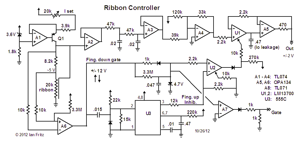

PostPosted: Sun Oct 21, 2012 9:35 pm    Post subject: Reply with quote  Mark this post and the followings unread
I'm resurecting this thread, since I have been working on my ribbon controller ideas again. Here is an improved version of the original circuit. The main change is that one of the comparators was redundant (A7), so I took it out. There are also some changes in component values.
Ian

If one was to use a 100k ribbon would he want to run a resistor in parallel ??25k??
Benjamin --
You would want to run 5V / 100k = 0.05 mA through the ribbon to get 5 V at the top. For this, change the Iset trimmer to 100k. Also increase the series resistor from 8.2k to 39k. Just set the trimmer to give 5 V across the ribbon and you're set.
What is your ribbon?

Benjamin AM wrote:
I'm experimenting with ESD ribbon taken from foot ground straps. THey seem durable and were cheap on Ebay.
I'd be interested in hearing how those work out for you. I tried this Desco strap (you can barely see it in the photo).
http://www.hmcelectronics.com/product/Desco/17250
Wasn't able to get reliable contact with it.
Ian
Benjamin AM
Joined: Nov 04, 2010
Posts: 83
Location: Boise
PostPosted: Sun Nov 18, 2012 1:51 am    Post subject: Reply with quote  Mark this post and the followings unread
Hi Ian,
I finally got around to getting this circuit on a breadboard. I eventually ended up using a softpot instead of using ESD ribbon. I noticed that the CV output ranged from 0V to 4V. To change this I adjusted the value of the 120k resistor attached to A4's negative input. Doubling the value(changing it to 240k) dropped the output to a range of -2V to 2V as the schematics indicates. I was curious if this sounds right.
Also, I was curious if other ribbon controllers designs that use the softpot exhibit the phenomenon that has been deemed as the "squish factor", that is, pitch bending on finger pull off. Not that this is a problem, I found that the effect to be controllable with said roll off technique, and even at times(for the few hours I've spent playing the controller) desirable.
Anyhow, thank you so much for contributing this design, I look forward to the spending many hours playing this thing.
Edit: I forgot to mention that I used CA3080s in place of the LM13700. Seems to be no problem.
