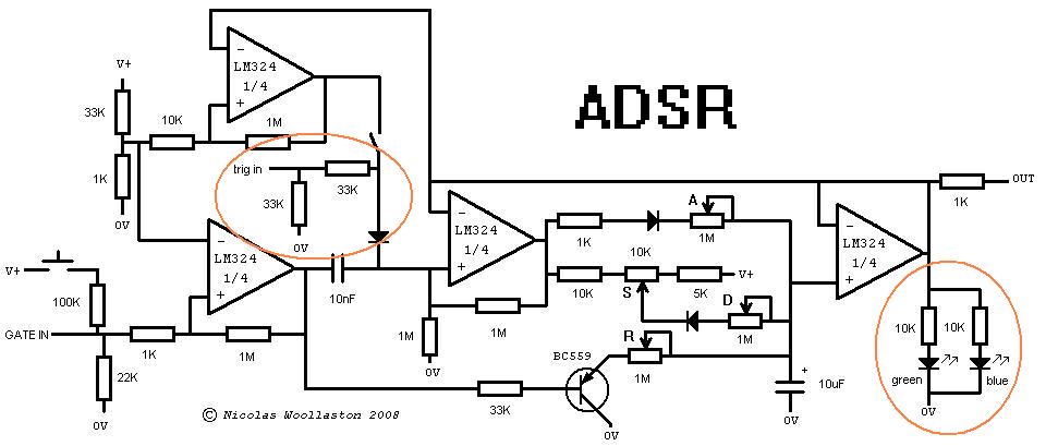

PostPosted: Thu Feb 19, 2009 9:16 am    Post subject: Reply with quote  Mark this post and the followings unread
nicolas, i wonder what the blue LED is for? i would have added a NPN and resistor as LED driver...

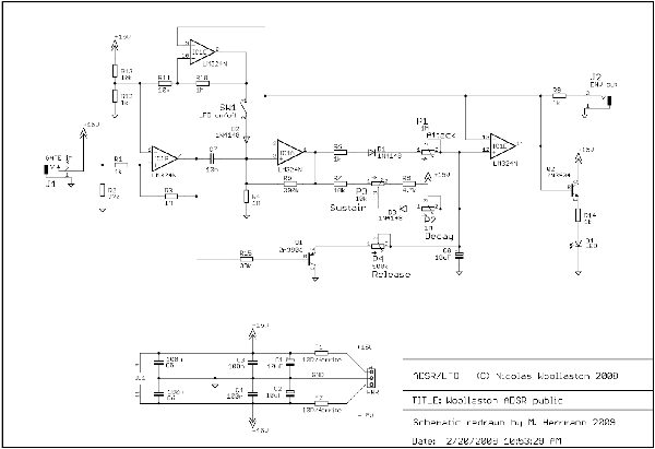

PostPosted: Thu Feb 19, 2009 4:16 pm    Post subject: Reply with quote  Mark this post and the followings unread
tonight i breadboarded the circuit and powered it with +/-15VA. that's what i came up with:
i lowered the 33ka resistor in the voltage divider at the neg in of the first OpAmp (comparator) to 10k. this gave me a trigger threshold of approx. 1.5V. Smile
i lowered the 1M resistor in the feedbackpath of the 3rd OpAmp (junction 10nF, diode, 1M to GND...) to 390k, just because this was what i had on hand. it gave me a peak of approx. 9V. Very Happy
i added a NPN and a 1k resistor as driver for a LED (Collector to +V, Base to output of last OpAmp, Emitter to 1K to LED to GND). Wink
a 500ka pot for release gave me a better control. Smile
i normalled the input socket to a 10k/10k voltage divider to allow the LFO mode to work. Smile
i found the LFO mode a little bit strange: sustain pot has to be fully ccw. when release pot is fully ccw the LFO would be gateble, which is very cool. Cool
as soon as the release pot is not ccw the LFO is always on. as soon as i turned up the sustain potentiometer the LFO stopped. Confused
i did not get the external retrigger input to work. Crying or Very sad
experiences, insights or explanations anyone?

PostPosted: Thu Feb 19, 2009 4:26 pm    Post subject: Reply with quote  Mark this post and the followings unread
My idea with running both green and blue LEDs was that the green would turn on at a lower voltage and the blue at a higher voltage. Could also be done with multiple green leds by adding diodes or zeners in series with some, but not others. To create a kind of crude bargraph type display. Probably a silly idea, but might be fun.
Nicolas

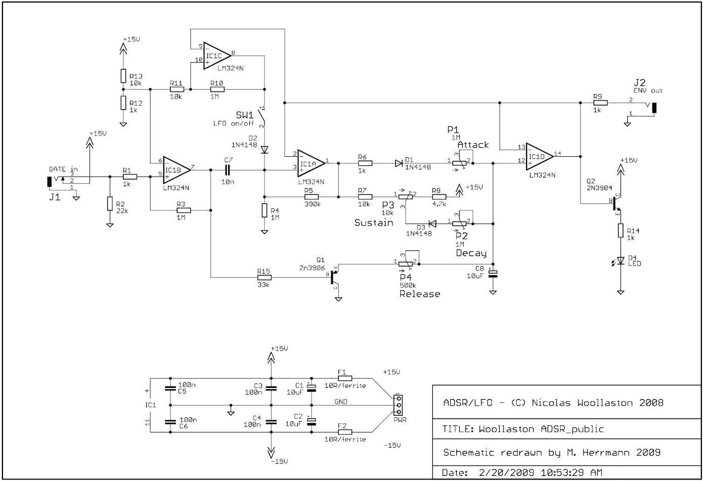

PostPosted: Fri Feb 20, 2009 12:41 am    Post subject: Reply with quote  Mark this post and the followings unread
nicolas3141 wrote:
Wow matthias, you got that up and running quickly - for someone with lots of other projects on the go. The weather must be wintry where you are Wink Thank you for feeding back your findings so clearly.
indeed. you WANT to stay at home, right beside the oven...
Yes the LFO mode is a little strange, but in a fun kind of way. It continues to surprise me as to when it will do what.
agreed. and i thought about adding some additional labeling to the front panel, i.e. "gated LFO" to the CCW position of the release pot?!
By raising the trigger voltage on the gate input you have also raised he voltage at which the LFO retriggers. So on your one the LFO will be oscillating between 1.5V and 9V. Not a bad thing at all, just a bit different to mine. You could always use two separate voltage dividers for these two functions.
great idea. i will think about it. a 3pole switch could control the LFO mod, voltage divider and even a cap on the output to remove the offset and center the LFO around GND...
EDIT: cap is bad idea. we are talking about DC voltages here, but should i add an additional DualOpAmp for this action?
(EDIT: corrected schematic uploaded)
that's what i had on the breadboard yesterday.
 Filesize:  51.32 KB
 Viewed:  2700 Time(s)

yusynth
Joined: Nov 24, 2005
Posts: 1314
PostPosted: Fri Feb 20, 2009 2:46 am    Post subject: Reply with quote  Mark this post and the followings unread
Hi Matthias
I reckon Q2 is there to drive a LED, isn't it ?
Yves
PostPosted: Fri Feb 20, 2009 2:49 am    Post subject: Reply with quote  Mark this post and the followings unread
yusynth wrote:
Hi Matthias
true - but where is the LED? Laughing
(EDIT: corrected schematic uploaded - thank you, yves)

PostPosted: Fri Feb 20, 2009 3:27 am    Post subject: Reply with quote  Mark this post and the followings unread
Another point is that it would be more accurate to use a FET-OPA for U1D. Therefore I'd suggest to replace the LM324 by a TL074.

PostPosted: Fri Feb 20, 2009 3:40 am    Post subject: Reply with quote  Mark this post and the followings unread
Absolutely - in most situations. But in a classroom situation I think it is best to use the ruggedest chips I can find, because they will be subjected to static, overheating, short circuiting, etc. So for me LM348 or LM324 are ideal. Although I have seen a couple of them destroyed recently by power connections the wrong way round.
I have had some success with biasing an LM324 to greatly reduce the inaccuracy due to input current (see below), but the resistor values probably need to be tweaked chip to chip.
 Filesize:  7.7 KB

PostPosted: Fri Feb 20, 2009 3:46 am    Post subject: Reply with quote  Mark this post and the followings unread
Thanks for uploading the redrawn schematic matthias, it makes it so much easier to discuss when we have a drawing with refdeses. I must do better drawings myself.
PostPosted: Fri Feb 20, 2009 4:51 am    Post subject: Reply with quote  Mark this post and the followings unread
nicolas3141 wrote:
I don't think a more complex switch would add much. If you wanted to be able to mess about with the DC offset you could, as you suggest, follow this with a DC mixer like Ken Stone's CGS04 - using the invertable inputs would be best. My philosophy is to have lots of very simple modules so I would rather keep the mixer separate in my setup, but everyone has their own approach to this sort of thing.
actually this is my point of view, too. for such jobs i use one of my voltage processor, i.e. my Attenuverting Mixer. Very Happy
hey, your drawing is actually much better than mine. better readability, neat and clear. i just have to do it in eagle for the PCB layouts...
