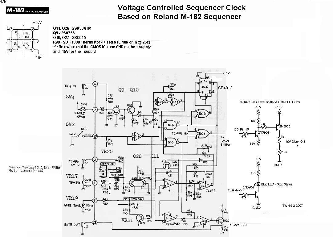

PostPosted: Sun Sep 02, 2007 12:02 pm    Post subject: VC Clock for Klee or Other Sequencer Reply with quote  Mark this post and the followings unread
All,
I just finished building a voltage controlled clock for the Klee. The design is based on the Roland M-182 sequencer and it works great!
Features:
1.) Voltage Controlled
2.) Freq: 0.14 Hz to 33 Hz, (7s - 3ms).
3.) Clock and Gate outputs with variable Gate width.
4.) Start/Stop button and ext. Start/Stop
5.) Temperature stabilized.
6.) Free run and single-step.
I have enclosed the edited schematic and the original can be found here:
http://fa.utfs.org/diy/roland100m/index.html
Fairly easy to build.
Regards,
Tim

PostPosted: Sun Sep 02, 2007 12:33 pm    Post subject: Reply with quote  Mark this post and the followings unread
Tim, that's A.C.E.! Nice work and nice share!
