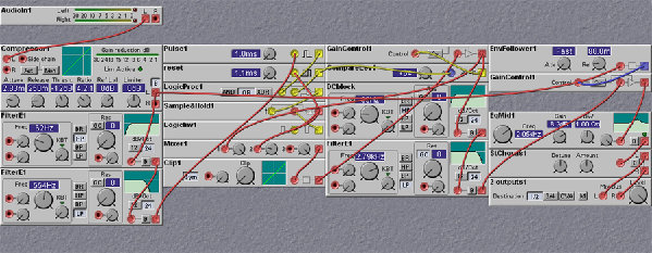

hi,
Being the self-proclaimed biggest Pat Metheny fan in the universe Laughing, I was thinking today about how the old GR300 might work. It is an old analogue design revered to this day for it's still unmatched pitch tracking. It cannot be that complex, as there are limits as to what is possible in analogue circuitry.
My hunch is that it is based on a slowly charging capacitor which is promptly discharged by zero crossing triggers from the input signal. This yields a ramp waveform which is in perfect lock step with the input signal (although the output level will vary with pitch, which might be compensated for, like in DCO circuits). No latency whatsoever.
I built the equivalent of this on the G2, and added LP filter and EQ to make it sound somewhat like Pat's trademark GR300 sound. Unfortunately, I'm not a guitarist. Meaning, it works perfectly when I sing into it. Laughing Chaotic transients are simply perfectly reproduced, there are no strange oscillator "blips" or quacks, nothing.
However, I'd be grateful for feedback from guitarists (or other instrumentalists) here that use the G2 to process their instrument, in order to find out if it actually works.
Unfortunately, it's only monophonic. No such thing as polyphonic pitch detection in the time domain -and no, FFT is definetely NOT possible in the G2! Laughing
Afaik, the GR300 guitar had a pickup for every string. Which such a device and the 4 G2 audio inputs, one could at least build something for 4 strings...
Try it out and let me know if it works.
thanks,
tim
Edit: I just read up on the G300. Seems like I was more or less spot on, even the "chopper gate" gain compensation (simply done with a clipper on the G2). The only things lacking are the adaptive input BPF filters and the mysterious "squelcher" circuit.
G300PatStyle_TK.pch2
monophonic GR300 style guitar synth experiment
 Filename:  G300PatStyle_TK.pch2
 Filesize:  1.74 KB
 Downloaded:  2176 Time(s)

Hey Tim, you're on a roll!! I would love to try this one out with both my guitar and my bass, to see whether this one gets rid of the tracking quirks of the pitch detection modules...

Anyway, I just had a chance to do some very quick testing with my strat. It tracks very well, especially in the high register where the pitch tracking approach is not good due to low sustain and hence much garbage on long high notes.
There is some stuff going on though that would be nice to get rid of. Some kind of octave-like switching happens occasionally. Setting the value of the feedback mixer (steepness of the ramp) affects this, as does some more aggressive hp filtering before the input.
Does hp filtering make it better or worse?
which feedback mixer do you mean? the osc core or the one in the input section?
the one in the input section, together with the clipper, is there to make a square wave out of the input oscillation (the GR does this too). The lpf before should make sure that the fundamental is the loudest. octave switching means that the circuit latches on to the first harmonic as it is loud enough to create an extra zero crossing. so, perhaps lowering the lowpass filter in the input section might help.
anyway, good news that it works at all Laughing hey, we might even get it into a reasonable shape. because, once the core works, it is possible to add further waveshaping stuff, make a nice patch. Smile

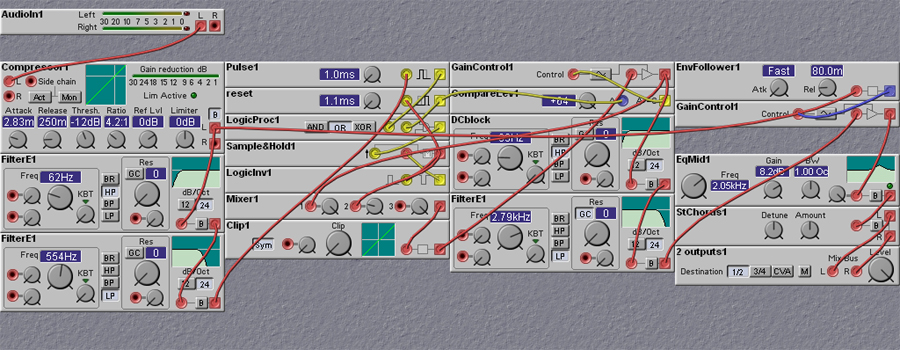

I think the filtering step is crucial here to improve the results. I have scanned through the service manual quickly, and it is described as being very fundamental (pun intended) in the zero crossing analysis circuit to get rid of dominant overtones.
Since the gr300 uses a hexaphonic pickup - one per string - the range of notes is much more limited per pickup. Therefore, better filtering can be applied (defaulting around the open string fundamental). The adaptive filtering is not entirely clear to me either, but it may be possible to do some kind of multi-band analysis on the entire 4-octave range of a guitar. I'll think about it some more, however, the central issue of telling a fundamental from a strong overtone is difficult to solve in instruments with strong overtones (such as guitars).

Well, finally had some time to test further (no recordings still, though), but my filtering scheme can be binned; it doesn't improve things much but has it's own switching problems and artefacts.
Biggest improvement / best settings so far for me have been to set the lowpass very low with not so steep curve (6-12db) AND using the neck pickup (definately not the bridge, as it has most harmonics).

Hi all.
I like this patch and I'd like to build it under NM G1 for my micro modular, but I have no sound. I'd don't know how to emulate the G2 flip-flop module and I think the problem come from this.
Any help appreciated. here is the NM patch.
Sorry for my english.
(also a big thanks to Tim, i'm a new g2 user and I really like the patch you share).
gr300NM1.pch

And the building block (.jpg).
