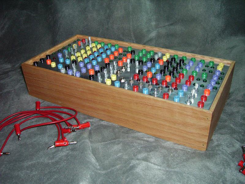

I won't make an 'all on one board' Lunetta again. Back to modular designs for me.
Although there were surprisingly few issues from all that spaghetti - I did manage to fry a chip shortly after I was done wiring it all to the panel. Very naughty words were uttered during the resultant surgery. Evil or Very Mad
If one of the chips in the center of the board ever again dies I'll be tempted to relegate the entire device to an out of site corner of the garage rather than go through that frustration again.
Anyway - It all works again - it makes good noises - and I'm feeling much better now. Wink
Since the electronics are done, I've been doing some 'window dressing' on it ...
Here's a 'tagged' panel shot, front, and rear shot.
There were a couple (!) holes in the bud box prior to starting - I was able to cover many, but a few remain... I call it 'value added prior experience character'.

Thanks Rych,
Yes - I used LM386 for the amps - gain of 20. I didn't (although now that you think of it - I prolly should have) put speaker out connections on it. The internal speakers are small - .5 watt, 2.5 inch. I do have line outs for each channel for a larger external amp. I just wanted something I could plug in and play with rather than set up an external amp/speakers each time. I did add line out's for a larger amp or running into another device.

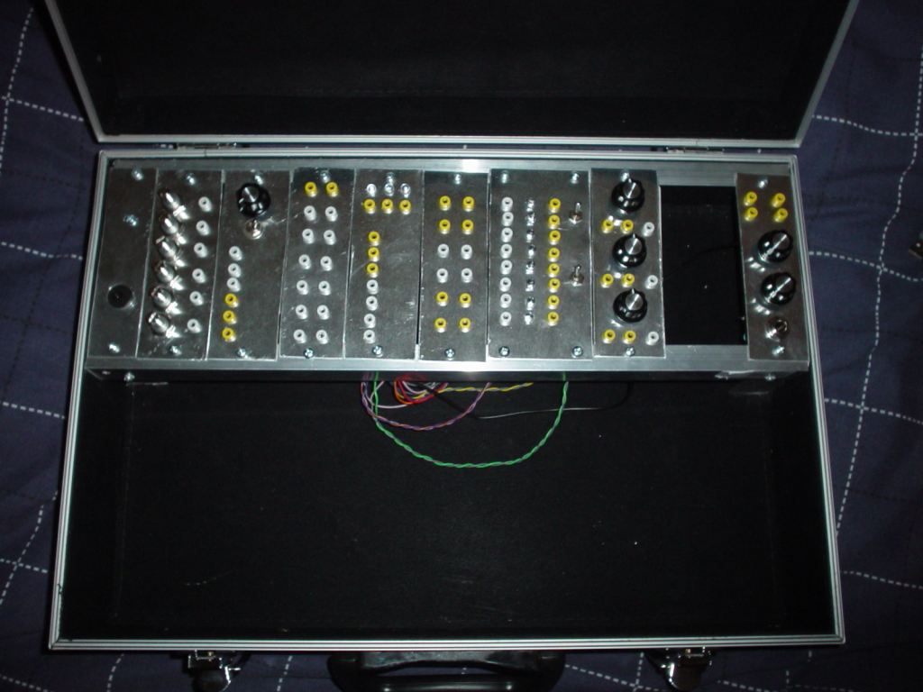

Here's a new picture of mine, still a work in progress. I've added a few more things to it, just need to order some more banana sockets and it will be half way there.
Newest additions are a 4015 shift register and 3 of Rych's 4023 oscillators, both really cool modules.

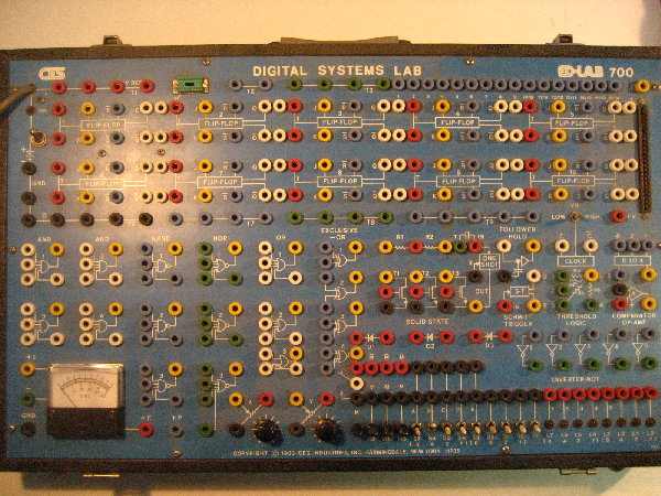

Found this at the CEM studio at WORM in Rotterdam. Don't everybody go running to EBay at once to buy one!!!!!!
E-Lab 700 Digital Systems Lab off-the-shelf-Lunetta

Sweet!

That is COOL! Love that it has single diodes brought out to the panel! I am so doing that on the next panel I need to fill some space in... in fact the board I built today needs a few spaces filled!
HOLY CRAP a panel mounted IC socket!! GENIUS!!! *Idea Stolen*
It realy is a store bought Lunetta, even in a cool case with a handle & everything!
I have been looking around for one of those 'Digital Labs' logic trainers & breadboards, should make testing lunetta ccts. quicker & easier... or make me lazy & leave stuff on the breadboard for ages!
I just stole your stolen idea. Embarassed
I'll race you to see who implements it first.... Twisted Evil

I had plans to bring raw components out to the front panel for my lunetta. I thought of diodes, resistors, even pots and switches but I never though of sticking a ZIF socket right there on the front panel. Brilliant idea!

There are a few things I'd love to know what they do.
Google found this, note the sexy closed pic!
http://illudium.blogspot.com/2007/05/ces-ed-lab-700-computer-systems-lab.html
"Threshold Logic" fancy name for a comparator perhaps, altho next to it there is an op-amp comparator...
"Follower Hold" according to the panel it appears to bring the leg of a capacitor out to the front panel.
I'd planned to do a manual logic module & have been playing around patching pots into the lunetta with croc clips, but this has transistors as well! And another one on that blog has resistor & capacitor sections!
Seems they may still be making them even,the website is pretty light on info, the "complete data sheet on the Ed-Lab Model CES 702 Digital Training System" (as they put it) is a one page PDF ad.
