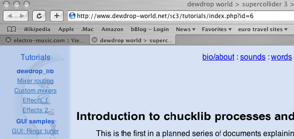

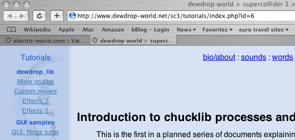

I don't know what's going on with your web browser -- I'm afraid I can't troubleshoot it because I can't reproduce it. The link works perfectly for me (attached).
Try going to my main site - http://www.dewdrop-world.net - and then navigating to SuperCollider > Intermediate Tutorials (link is in the page body, toward the top) > chucklib intro (menu bar at left).
