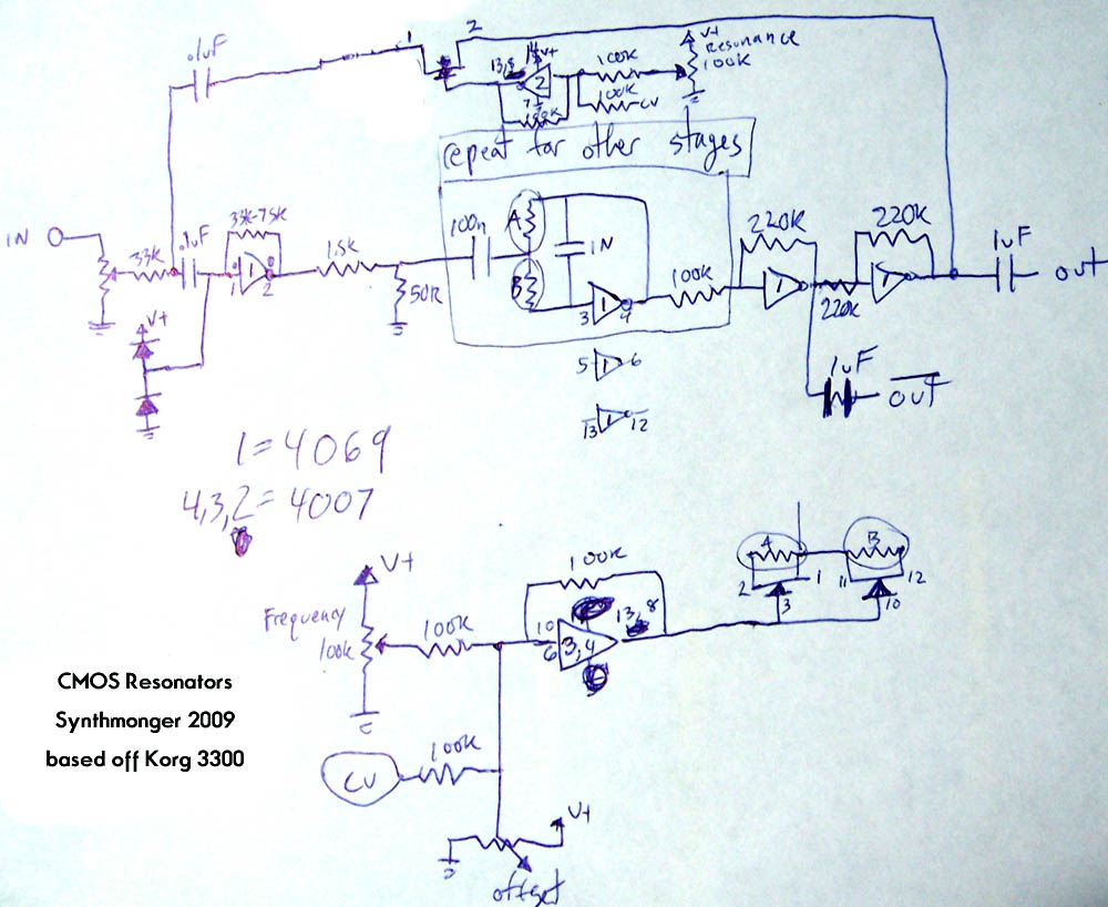

PostPosted: Mon Apr 06, 2009 6:13 pm    Post subject: Reply with quote  Mark this post and the followings unread
I drew the schematic out to aid me in developing the pcb. Sorry my handwriting is terrible, that's what 8 years of visual art schooling will do to ya!
I will have a super clean schematic laid out in eagle after I finish the pcb.

loss1234
Joined: Jul 24, 2007
Posts: 1536
Location: nyc
PostPosted: Tue Apr 07, 2009 4:29 am    Post subject: Reply with quote  Mark this post and the followings unread
ok
trying to read this schematic (very excited)
so there are just 2 chips total?
wow...now you just need to upload one of these for your wasp-esque filter and your guitar synth!
love your circuits! even when they are messy
thanks
loss1234
Posts: 1536
Location: nyc
PostPosted: Tue Apr 07, 2009 4:32 am    Post subject: Reply with quote  Mark this post and the followings unread
also
on the chip (4007?) that is feeding the A and B fake vactrols, i notcied that pin numbers are 10/6, and 13/8 (And the chip is labeled 3/4)
so does this mean that vactrol A gets a circuit like this and Vactrol B gets one as well? or does it just mean, use whichever set of pins you like?
that is a bit vague
also on the top 4007 inverter (resonance) i can see 13, 5?? (and 14, 7 for power) which pin number is input?
also...you state that this takes 4 4007 chips....i cant figure out why...or where...it looks like the top transistor (for resonance) would be a separate chip but where else are the 4007's split up?
other than pin numbers and whether or not to repeat the bottom 4007 this is all pretty clear
thanks

let me ask...
could this be turned into a regular resonant Low pass filter by simply replacing the vactrols with a pot?
the reason i ask is i am trying to figure out if this is the result of your CMOS filter experiments you were doing a while back or if this is something different.
can you post a theory of operation?

loss1234 wrote:
ok
thanks
Five chips total. I left one out on accident. There is one 4069 that take care of the audio signal path and four 4007s; one for each frequency control and one for the master resonance.
The pins labeled 10, 6 and 13, 8 is part of a 4007 wired as an inverter. You have to connect those pins together in order for it to act as one. The IC is labeled as 3,4 should also have 5 which according to the key are supposed to be 4007s.
You could find another method of controlling them, but I felt this way to be the best way possible. Originally I tried using the NMOS but no such luck at all. Without the inverter in the front the pots will act backwards.
The input pin for the 4007 at top is pin 6. Sorry! Thought I covered everything...
The things that look like transistors are PMOS gates from the 4007. I use different symbols to make things easier to read. There are a few unused pins on every 4007 so just leave them hanging. Don't ground them or they'll screw everything up.

Also, don't forget decoupling caps for every chip! The diodes on the 4069 pin one can be omitted if you just want to use it in your lunetta.

That sounds really cool. I'm attempting to build a CMOS based analogue synth at the minute as opposed to a lunetta so I might try this out. At the minute I've got a filter on the breadboard that's a modified version of the MXR envelope filter, might be cool having this as well for a different sound.
One question if you don't mind, what does it mean where it says "Repeat for other stages"? Does it have more than one stage in parallel or something, I'm not familiar with the original, guess I need to go find the schematics.

PostPosted: Tue Apr 07, 2009 1:44 pm    Post subject: Reply with quote  Mark this post and the followings unread
Yeah the stages should be in parrallel with 3 stages total. If you nix the master CV resonance control you can put them in series or have seperate outputs. If you look up the original schematic you should look at foniks resonators for a cleaner layout.
