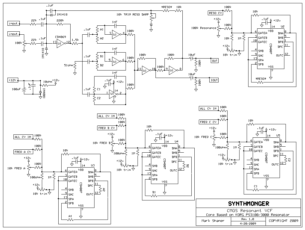

Well I tested negative voltages with it through a voltage divider and LFO without blowing up anything. I tested it with the pots on every setting imaginable. I haven't noticed the chips operating any differently at all. Though if you do feed it negative voltages it the audio will cut out completely. I don't think there's enough current flowing through them to hurt the chips. I did feed negative voltages directly onto the MOS gates which fried it, but if you feed it through the inverter section of the 4007 everything should be ok.
Here's the resonator schematic.
P.S. I'm making starting a thread for my CMOS PW Modulators. Schematic is ready and PCB will be soon. Probably tomorrow.
