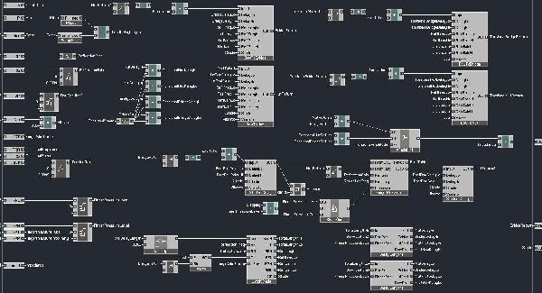

Any chance of a screen shot of the guts?

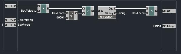

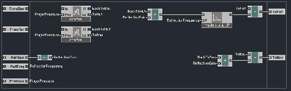

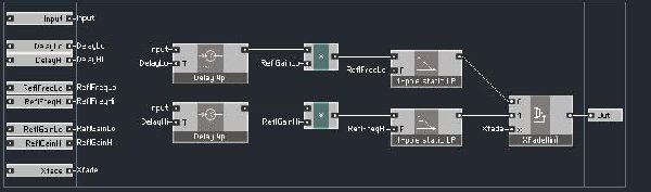

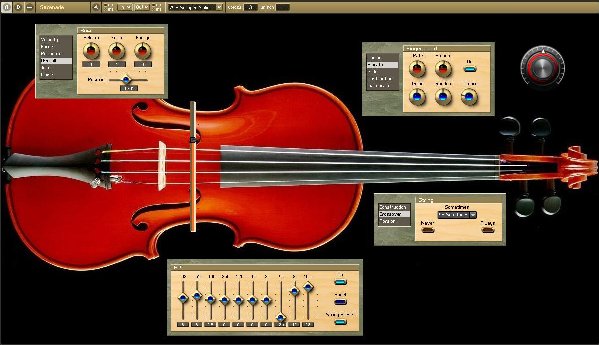

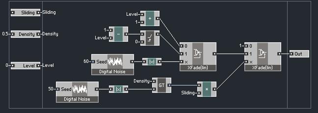

Sure. Here's most of the model itself. Very little is actually changed from the G2 patches I posted.
The main changes are:
1. The bow driver shape has hysteresis, which makes for a stickier bow. This wasn't possible on the G2.
2. There's an 'obstruction', which can model a finger lightly held on the string, or the string hitting the fretboard. I did this on the G2, also, on a slap bass patch.
3. The feedback path from the string back to the bow is no longer divided by two. This turned out to be really important, and creates the initial scraping sound that I had been searching for.
4. Torsional waves are modeled. The effect is subtle, but noticeable.
Unfortunately, I hit some architectural limitations when trying to do this on the G2. I ran out of DSP and inter-slot cables, and the shape of the bow driver couldn't be accurately modeled. It was a bummer, because the G2 patches much faster than Reaktor, imo.

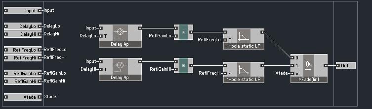

Some pictures didn't make it.

Wah, that is some sick Core patching. How are you doing this?
How do you model torsional waves in Reaktor?
How...
This is ridiculous - Head asplodes... Shocked
How...
Thanks! Yeah, it's grown pretty complicated.
The design for the torsional waves was taken from some publications by Drs. Stefania Serafin and Knut Guettler. Even then, I couldn't get it to work properly until I found some C++ code for Dr. Serafin's 'strad' model and saw what was actually going on. I'll find their links and post them later today.

Here’s a Reaktor physical modeling ensemble that does gesture-controlled synthesis of a violin. It is “bowed” by moving the pitch wheel back and forth.
The physical model requires two variables: bow velocity, which is the speed that the bow is drawn across a string, and bow force, which is the contact pressure the bow places on the string as it is drawn.
As a violin is played by pressing the bow onto a string and moving it back and forth, the ensemble is played by pressing a key and moving the pitch wheel back and forth.
Press a key to make contact between the bow and the string. Then move the pitch wheel back and forth to simulate bow velocity. Upwards is positive velocity while downwards is negative velocity. Lift the key while the wheel is off-center to make the string ring.
If a pitch wheel isn’t available, the on-screen slider can be “bowed” by dragging it with the mouse.
The output of the ensemble must be convolved with a wooden body impulse. A violin impulse is included in the zip file. Use real-time convolution software such as SIR2 and set the output to 100% wet.
For proper tuning and high-quality sound, a sample rate of 96k must be used.
Picture of gesture-controlled violin synthesizer.
 Filesize:  106.9 KB
 Viewed:  923 Time(s)
