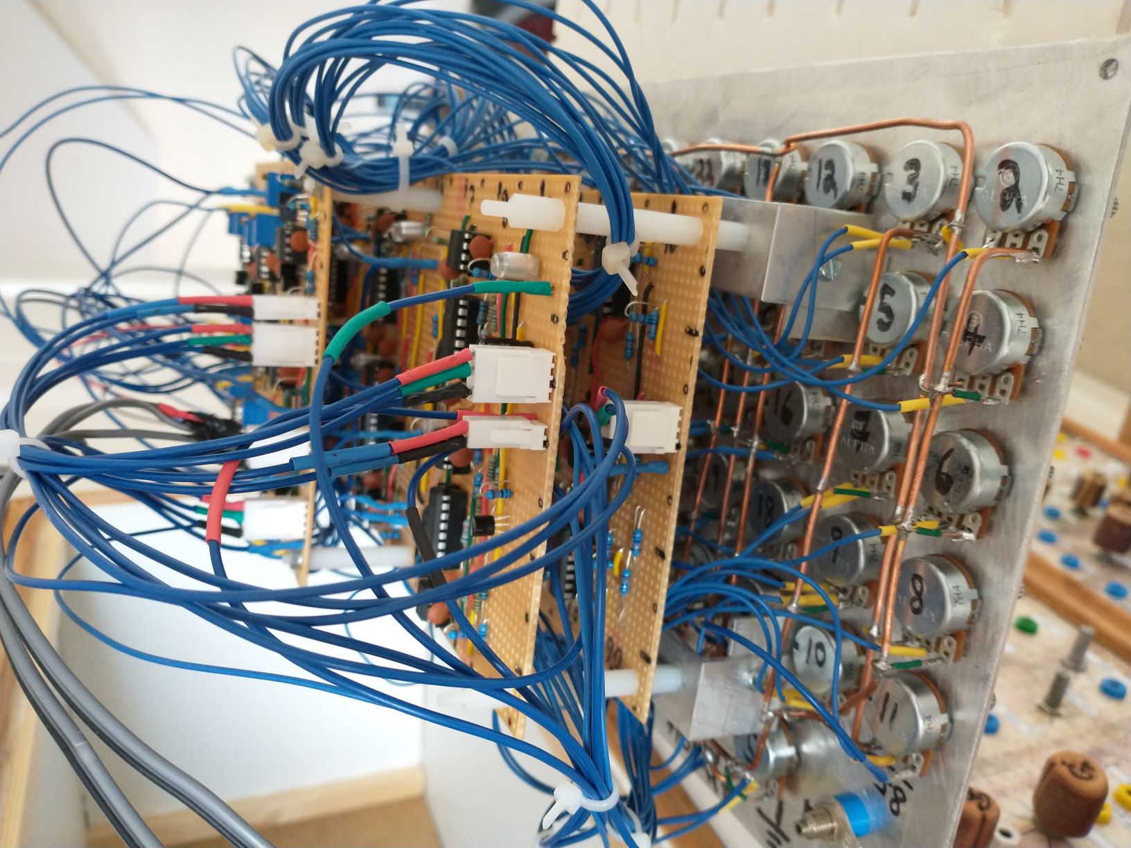

PostPosted: Fri Jul 10, 2020 10:27 am    Post subject: Reply with quote  Mark this post and the followings unread
I've spent the past months breadboarding sections of this module, variously modified, primarily to replace the 3280s with LM13700s. I've succeeded in producing a working filter section with a fairly strong resonance in band-pass mode (the CV processor and VCA sections are rather more straightforward). Won't know until I have the whole thing build whether it actually works as a vocal filter...
Anyway, thought I would share a picture of the front panel - this is a real beast of a module. It has three large stripboard PCBs, which I have started constructing. Be a while before I can share any sound samples!
I settled on 3 filters; 3 VCAs hardwired to the band-pass outputs (the low-pass outputs are available from the front panel, and there is a fourth VCA which can take an external input (which could of course be one of the LP outputs)); and five CV processors, three with four breakpoints each, and two with just two breakpoints. The first three are intended to control the frequency of the three filters, and the other two are for controlling the resonance or VCA gain, if it seems worthwhile to drive those independently. All the CV outputs are available from the front panel too.
The front panel, 35 x 20 cm

PostPosted: Thu Sep 10, 2020 10:31 am    Post subject: Reply with quote  Mark this post and the followings unread
So I finally got this module built and working.
Three large stripboard circuits, about 50 pots,...on a par with the Klee or MFOS time quantized sequencers for size of build.
I'll post schematics later of the filter section adapted to use LM13700's. But here are a couple of audio samples of the filter in action and tuned to human formants. One file is at a male voice pitch, with vowel sounds 'ee', then 'ah', then 'oo'; the second file is pitched for a female voice, in the reverse order - 'oo', then 'ah', then 'ee'. It's a lot of work with a scope to set each filter up to the relevant resonant frequency.
I've no idea how this compares to the original, though I suspect the resonance doesn't go as high.
A third file is noodling around with the CV processors (each with four breakpoints, one for each filter).
The CV processors are pretty impressive modules in their own right - and you're not of course restricted to using them for CV - with audio input, they make cool waveshapers.
Was it worth all the effort? Well, it's quite a distinctive filter, but a very big build and a lot of panel space. I enjoyed the design and build.

PostPosted: Thu Sep 10, 2020 12:19 pm    Post subject: Reply with quote  Mark this post and the followings unread
A couple of images of the assembled module.
