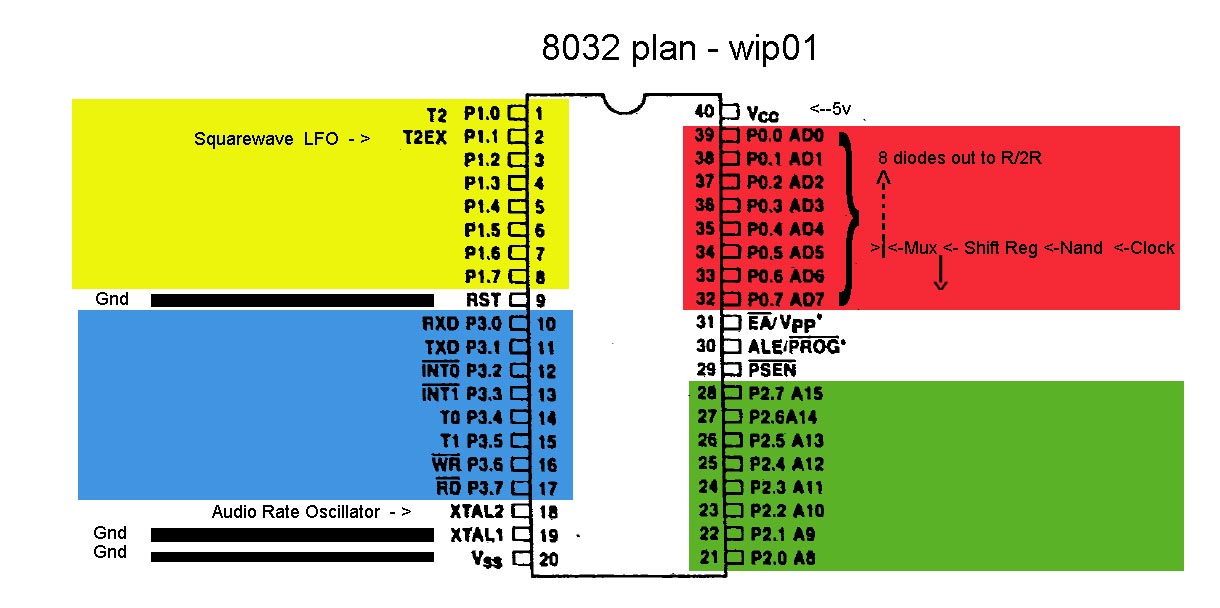

I've gotten a hold of some 'classic' microprocessors and support chips from a former technician. Needless to say the first word I thought of was Lunetta. Twisted Evil
I'd like to rig up this 8032AH chip for the purpose of severely misusing it. If you masters of electro magic have any brainstorm ideas I'd love to hear it.
I'm reading the datasheet and I think I have a plan.
I'm not planning to 'program' it at all, just send data into it and see what comes out.
Ideas:
-8032 has a simple 4 port pinout to understand. Each port is an 8 pin group, so that's 4 modules.
-The pins are bidirectional, so might attach multiplexers to them that are funked by shift registers that are fed by NANDed clocks, and also tap into the pins with diodes that go to 4x R/2Rs, then to four VCOs.
-The output of the pins will either go to a DAC or straight to a vco.
-Might be able to switch between 'program' mode and 'verify program' mode because at least in those modes you know when it's reading and sending data out.
Port 3 has a lot of strange options that i need to research further. Maybe use physical switches to turn modes on and off?
I'm hoping for:
-an interesting wierd data stream
-best case would be a melody generator
So there it is, let me know if what you think, here's an image to show the basic idea.

If it works anyway near the more modren microprocessors that i have a little knowledge about, then i don't think you will get far (anywhere) without programming.
The i/o pins don't "do" anything by themselves. They need to be set or read by the processor. So connecting something to an input pin will result in nothing at all if the processor is not programmed to read the pin and act upon what i reads. The same goes with output pins.
Usually the processor explicitly tells a pin (or an entire port) to be "I" or "O", otherwise the pins (port) will remain in ther
default state, whatever that is.

The best chance of anything interesting happening might be to set the IC into the mode of accepting input and being programmed, and then switching it to the mode of verifying the program and playing it back. If that can be done with just input signals that is, don't know yet.
Other than that the support chip combinations could be useful salvaged from the experiment. Smile

A friend let me borrow this one:
http://www.parallax.com/Store/Microcontrollers/BASICStampProgrammingKits/tabid/136/CategoryID/11/List/0/SortField/0/Level/a/ProductID/294/Default.aspx
I've gone through some documentation and it does seem pretty darn easy to get going, just need to put some time into it.
It would be cool to set up that Basic Stamp to do simple things like divide add, etc from one pin to the next, hmmmm....
Going back to the 8032, the reason I chose it over the others (Z80, 8088 etc) is (1) I have several of them and (2) that the pins don't need instruction to be defined as in or out, so apparently they can be written to or read from at any time, and
(3)The 8032 doesn't have internal ROM, just 256k of RAM, so at power up the 8032 will at least make some output signal to request data from external ROM, at which time I'll stuff it with bitz.
Which I guess means it'll be programmed with utter junk.
After that change pin settings on port 3 to get the 8032 to do something....ANYTHING....
Stuff to build:
The general idea is to build these items as separate modules on little perfboards to plug into the port pins. The modules themselves are very Lunetta, straight from these pages, so the hours of labor won't go to waste, i'll just use them for something else if it doesn't work.
For each: Port 0,1 and 2
A clock, probably the 4060 ripple counter with internal oscillator,
Out to a 4011 NAND to mix it up a bit
Through some shift registers to get 8 strange data streams,
Those 8 lines connect to the 8 pins of each port.
Diodes from those pins also go Out to an 8 bit R/2R,
Out to a 40106 YACO VCO.
Out to a 4 input mixer.
So that's three VCOs out to a mixer and one port untouched, port 3.
For Port 3, an 8 pin dip switch for commands to hopefully control the emotional state of the 8032. Maybe a gate in for each as well.
Unsure about blinkys.

I needed to feel better about this so just started plugging things in and got some interesting melodies.
Here's what it sounds like so far:
http://droffset.com/sound/8032Lunetta_r01a.mp3
Really simple, a clock goes into the pin a crystal would normally connect to for the oscillator. Power and ground are normal.
Then select some pins and connect resistors from the pin to a single point, which goes into the data of a shift register using the same clock... Lots of semi-random cross connecting between ports going on, and the serial output from the shift register modulating an oscillator. I'll change that to a VCO.
Big finding of the day, changing the CPU's clock speed changes the speed of the output, so that noisey modem like sound at the end gets slowed down to a cool guitar riff. Twisted Evil
